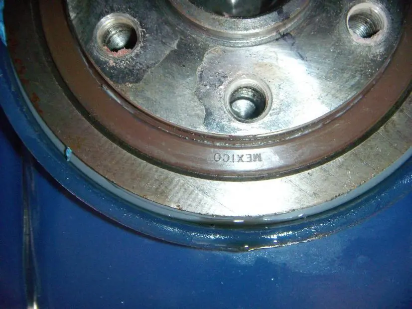

so after months of fretting over having to replace my rear main seal on my recently rebuilt stroker, i removed the trans, clutch, etc. this weekend. To my surprise i found the leak coming from the rear of my oil pan, NOT the rear main seal. The pan is a 351 pan (engine is a 351), but for some reason the radius of the pan is slightly different than the bottom of rear cap. Strange. Anyone seen this before?
Mike
