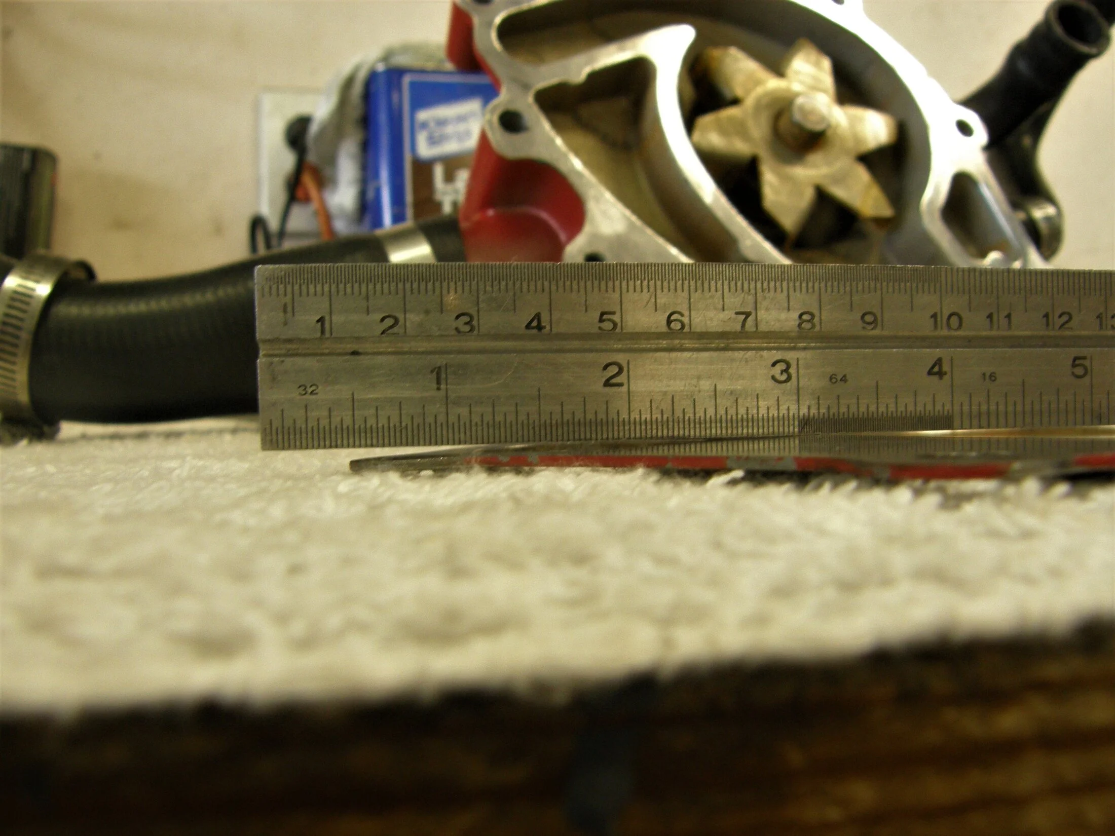

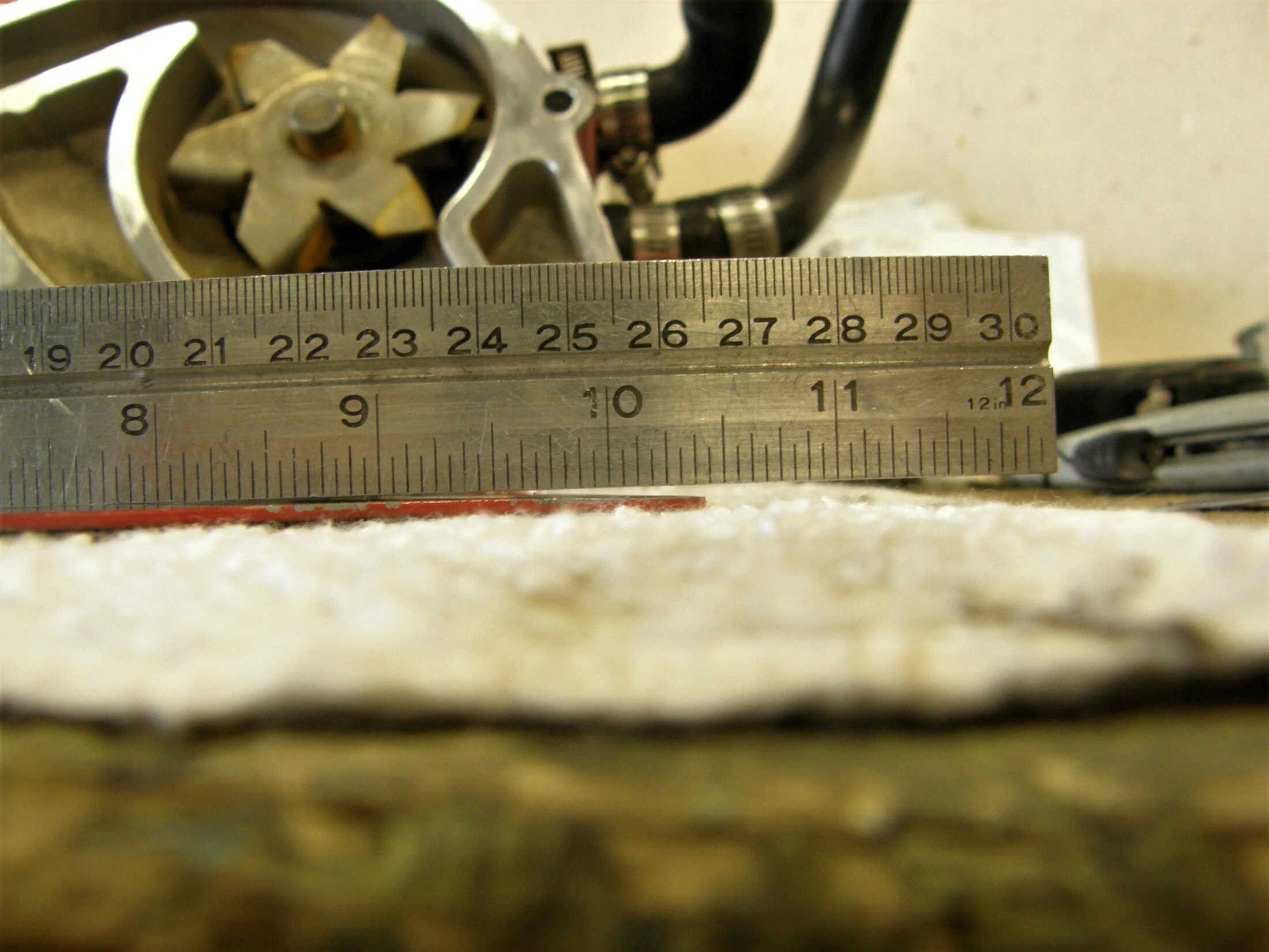

Walked away and completed some other tasks on the car I had to do. The next day I pulled the pump again (this is getting old)! Cleaned everything up and put a straightedge on the rear cover. There was a gap on each end.......
So I chucked it in my vise and straightened it. This time I decided to go without gaskets and ran a fairly good bead of RTV on all surfaces. Put it back together and let it sit for 36 hours. Fired it up, brought it up to temperature and no leaks! Not a drop! Finally I think I'm done.

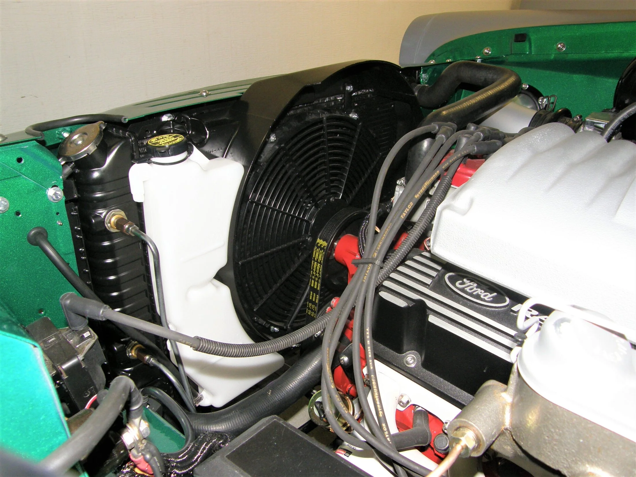

I have an 1100 cfm SPAL fan (the only one that'd fit) and I'm using the Mustang radiator and shroud, no deflectors though. Just wondering if I should drop to a 180* or 185* thermostat?
200° is where the factory wanted our cars to run. I used to use 2000 jeep cherokee wlectric fans im my mustangs. They'd trim pretty easy and install inside the factory shroud with a few bolts and washers. Now, I run Ford Contour fans. My turbo car likes to be around 203°. I run a 192 thermostat. Cruising temps drop to about 196°. My car never goes above 213°
