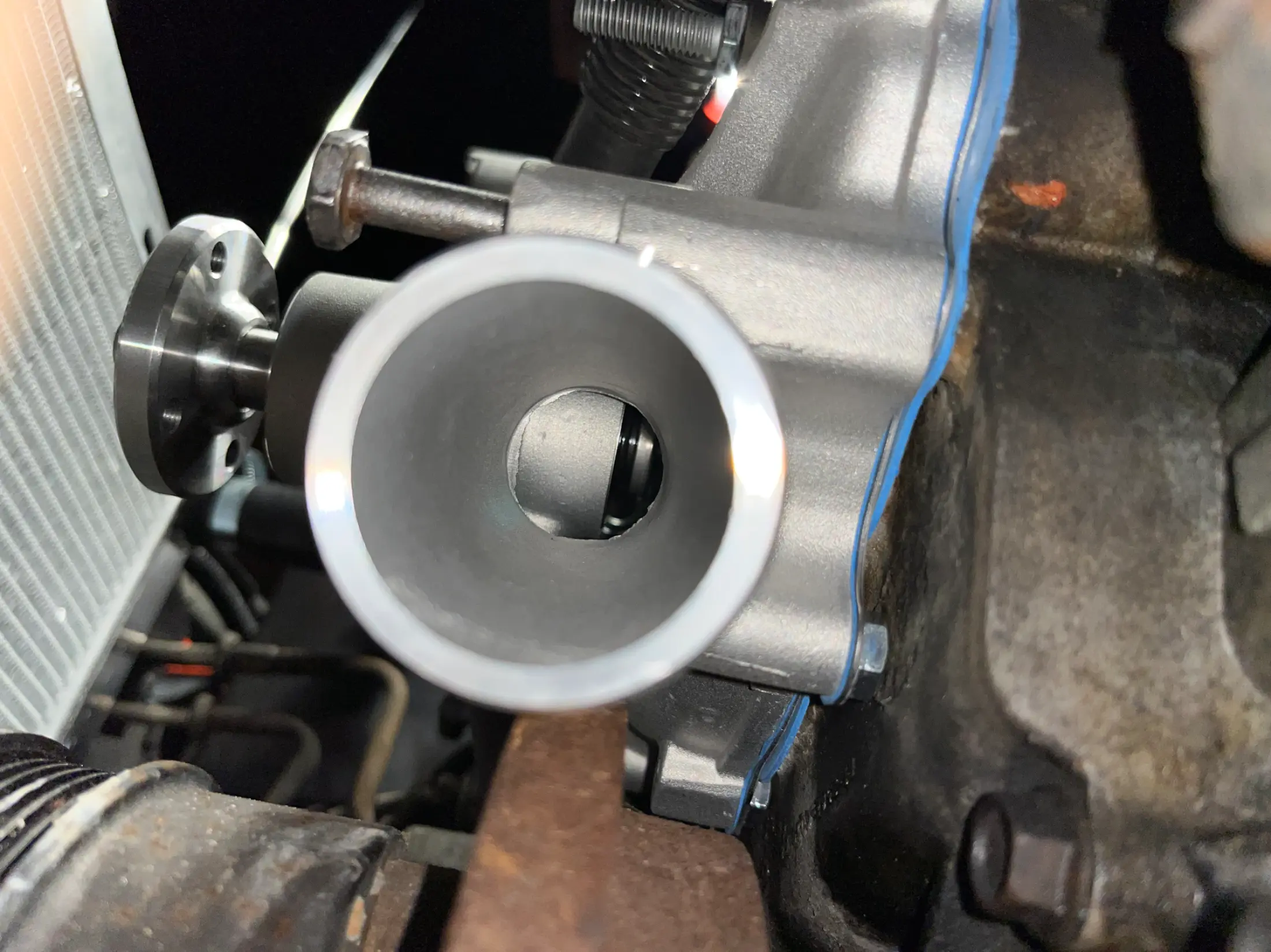

As the title says, I wanted to know if any of you have experienced this while installing your water pumps and if this is normal or not. The two back plate bolts are touching the timing cover but the pump seems to be installed evenly.

I emailed LMR about this exact issue about 2 weeks ago. Those bolts are not correct. You will need to use your old ones. The new motocraft pumps are made in China and it shows. I have pictures of the bolts mine came with in my progress thread.

I went ahead and found my old water
Pump in the trash and used the bolts from the old pump, much thinner now.
