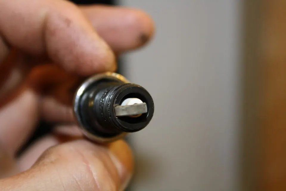

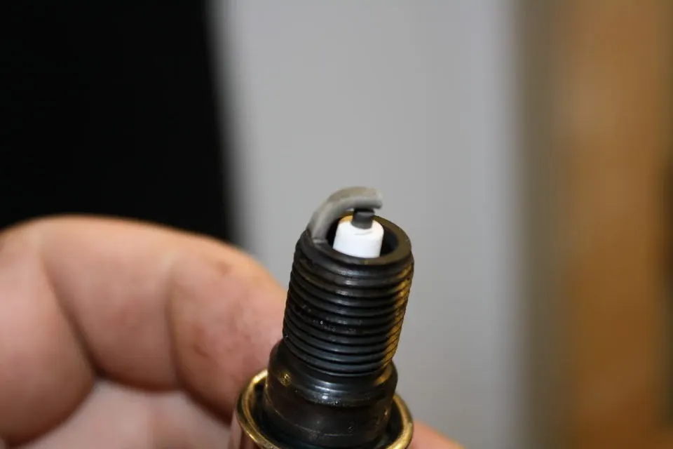

I changed NOTHING on the car for it to go from normal to this lean condition.. So I did pull a plug just to see if my wideband was lying to me... The plugs did look pretty lean..

What to you think about that spark plug?
Id say that spark plug does look a bit on the lean side...
Thats the only reason that I'm believing the wideband, and didn't just instantly recalibrate it... (recalibrating it is kind of a pain in the ass)
The plugs have always looked somewhat like that, but a hair richer.. I wish I could find the old pictures of them to compare.. I'm going to go clean the MAF right now.
