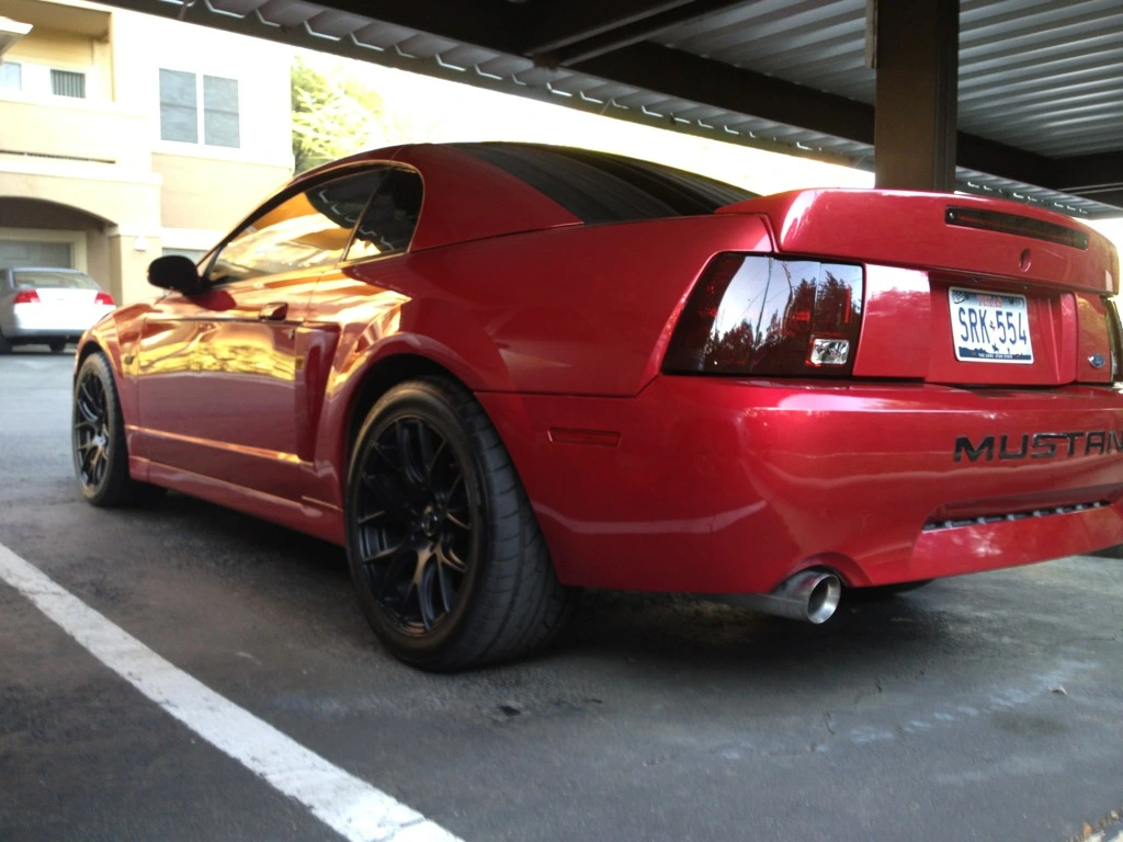

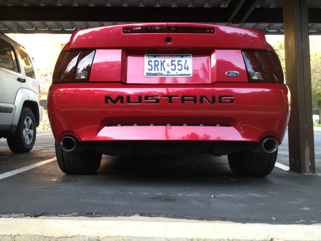

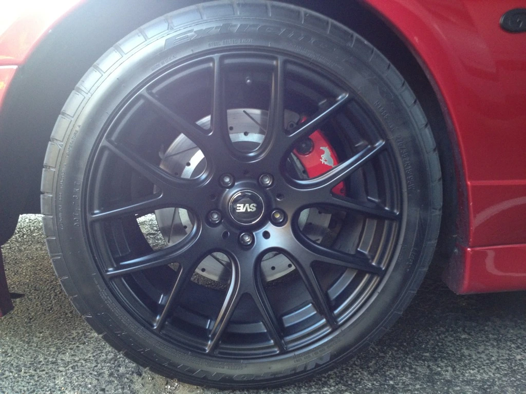

As promised here's the most current pic of my car. Btw used some new detailing products on the wheels and it looks killer. Also used to same stuff on the taillights and headlights and wow it looks like glass. It's gonna be tough to see this one go if I go through with it.

When did you put those wheels on it? Looks great. If you do decide to sell it, let me know a price please.
Wheels and tires are about 3 weeks old, 18x9 up front and 18x10 out back. The new wheels transformed the car like I never knew possible. Stumbaugh check your pm's later I'll send you one about your question.
