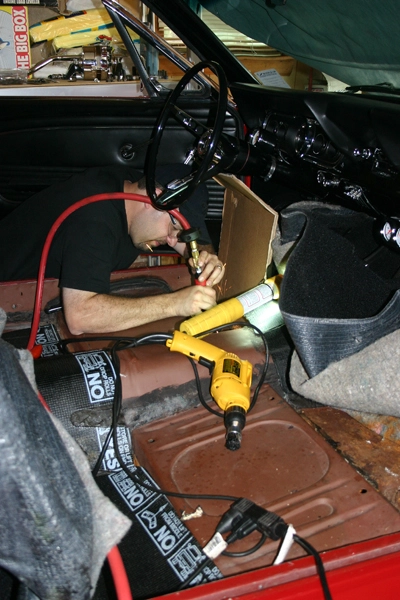

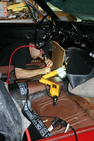

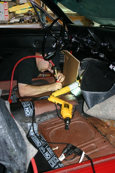

Not as big of a pain as you would think. I did it, about a weekend job if you get interupted every 5 minutes like I do. I'll make one suggestion that I wish I would have done better, move the pan back a few inches as well. I'm 6'3" and I moved the pan back about 2" but I also did the T5 swap at the same time and with the new clutch peddle I am now very cramped again. I wish I had pushed the riser back another 3-4" before I welded it all back in. :nonono:

I got my peddle assembly from the Auto Fair at Lowes Motor Speedway for $100. They appeared to be in great shape and the seller claimed he rebuilt them recently. I've found some each time I've been to the swap meets so you should do good looking at one of those type of events. Heck I see them on Ebay often but you'll probably pay more there.
The underside of my risers had minimal surface rust on them which I wire brushed off and sprayed rust treatment on and then painted. The top sides which you saw were fine with no rust.
I'm not sure about the placement part but if you're going to cut them out (keep in mind you only have to move the driver side, passenger side is optional) then I would cut them out rebend them which will lower them (that helps a lot!) and then put it back in with your seat and find the right place for YOU. Wish I had done it that way...hind site heh? Note this from my experience, you will need a lot more room once you do the swap.
You don't have to move the pans to the rear. If you do, you will need to make new holes in the floor boards to install the nuts on the tracks.

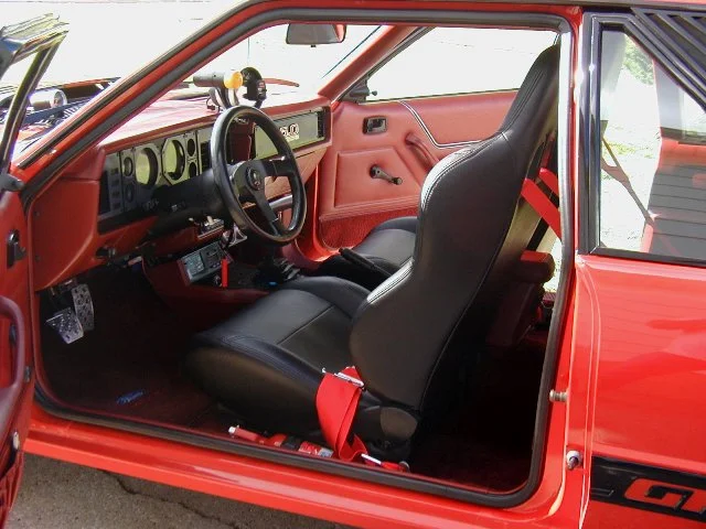

I have the summit seats in my '85. I'm very happy with 'em, and they're more comfortable than the stock seats were on a long drive. I looked at many seats that were much more expensive and were'nt nearly as comfortable before I bought them. I'm thinking about putting them in the '68 as well. They should fit without any problem. These leather seats look very nice also, very similar to the summit ones.
