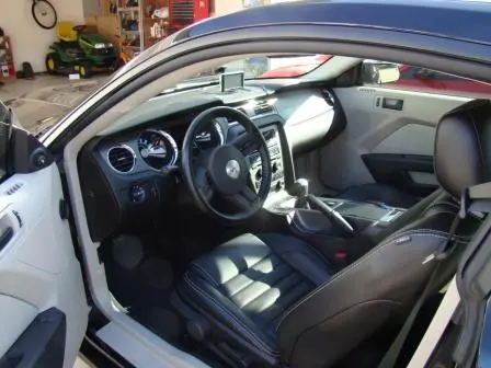

My 2010 Mustang came with cloth,I took off the cloth and added leather,so now I have a cloth seat kit,this would be considered cloth take offs.You have to remove the seats from the car and actually disassemble the seat and remove the fabric or leather.I found my leather kit on ebay (take off kit)for $300.I installed it myself but I am a Honda mechanic and deal with upholstry often,most likely you will have to take it to the shop.If you live in Raleigh NC I can replace the damaged leather for you.LOL:nice:
BTW,if only your rear seat is damaged you can probably replace the leather yourself,the rear seat leather requires no special tools(hog rings hog ring pliers,etc)you just have clips and velcro,you just have to remove the rear seat from the car which is very simple.The front seats now thats a different story.
from cloth to leather.
