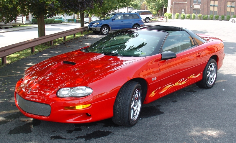

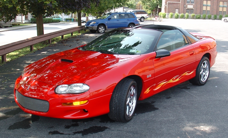

I'm Back, look for me Weds, don't hate!
roached1 said:
WOW! I don't know what to say!. na, good to see you with something you can have fun with again. How is the Beast anyway? did you say it was un drivable? noracing this year?
it was getting work done in the gas tank, needs rails and then it wil drive onto the trailer to dyno it. The year is over, the pace with me doing the work is slow so the solid is going in right away while the interior is still out of it. Nitrous and a slew of gauges after that. It's is just a race car that is never done, fairly common thing so I needed something to drive.
So do you think the GT can take it? It feels REAL strong but no drag radials yet, I hope to have them on Saturday. So can you take me with street tires on it?
I missed weds nights, the Cobra didn't like the dewey track, I couldn't run in the 12.0 index, I want to set this one up to play on Weds nites again.

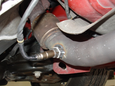

Man things didn't start off so great for the SS. I changed the fuel filter, oil and trani juice, so I needed to take out the rear O2 sensor so I could stuff a QT gear oil container and a hose about level with the filler hole and easy as can be took the threads out too. No biggie but I had to find a plug, planned to take it out of the tune anyway. Got blasted square in the face and eyes with syncromesh. So I drive all over tonight, Albany, Colonie, Schen and back. Car feels strong, any bets as to times? Totally stock under the hood but I am going to tune it, 10.5 DR's, air bags and some rear suspension and drivetrain upgrades.

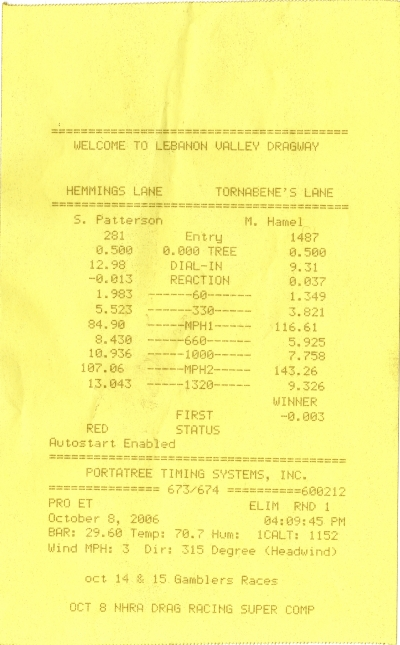

I ran a
13.4 wed. night with a sad 1.9 60'. I'll run ya next spring!

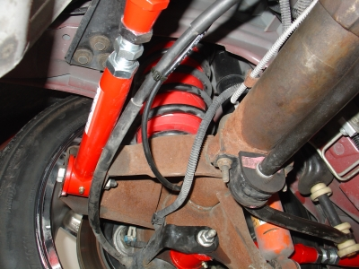

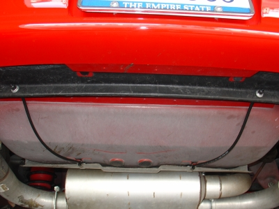

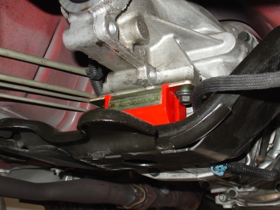

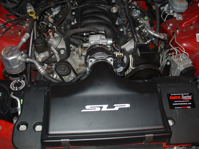

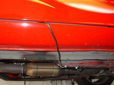

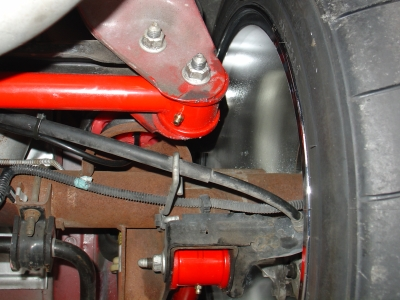

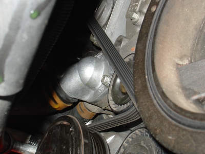

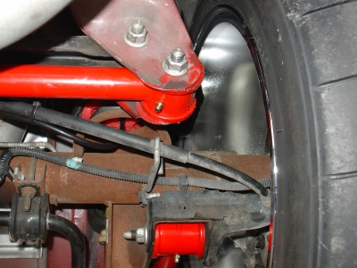

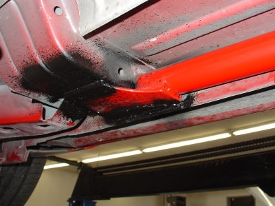

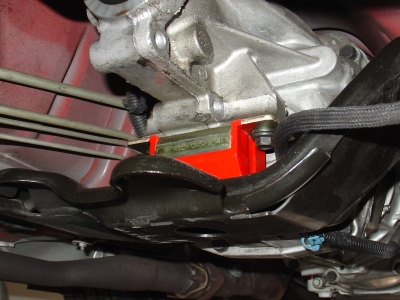

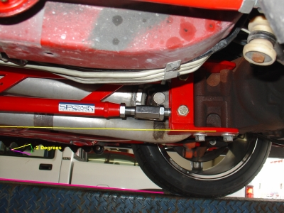

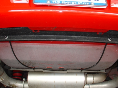

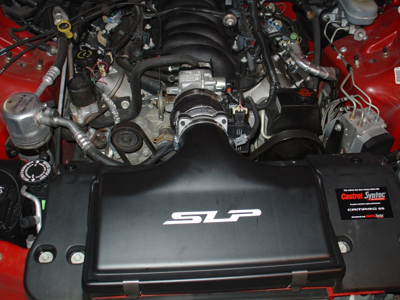

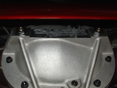

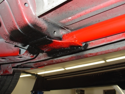

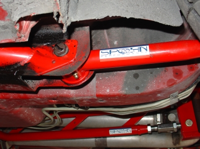

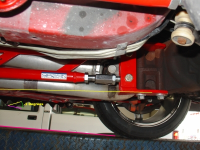

First 3 passes in a 99 SS M6
Mods
SLP Lid w/new K&N, SLP bellows, 160Tstat, fresh Royal Purple Syncromesh & Redline 10-30, Jegs 4.10's, T/A bolt-thru 10 bolt Diff cover, Front sway bar removed, Poly Trani-mount, Spohn Cromoly tunnel braced TA w/Loop (-2* angle), Cromoly SFC's, Spohn Cromoly LCA's, Spohn Cromoly PHB, OEM Concepts 11" ZR1 chrommies, Nitto 315 DR's w/(17-18lbs), AirLift Drag Pack air bags (22lbsL/28lbsR), HP Tuners money tune by mE w/13.0AFR and 28.5* timing, LM-1 WB (temp setup) and I ran 96-97 octane Torco mixed Sunoco Unleaded.

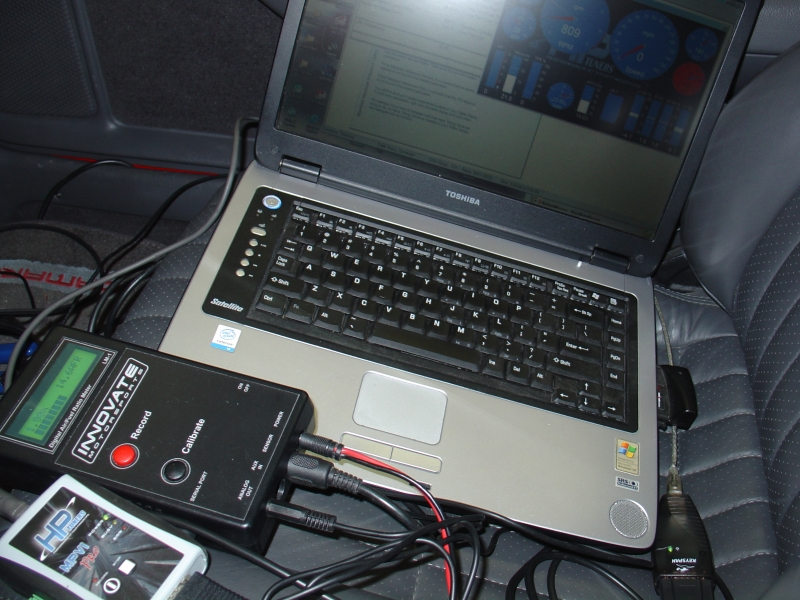

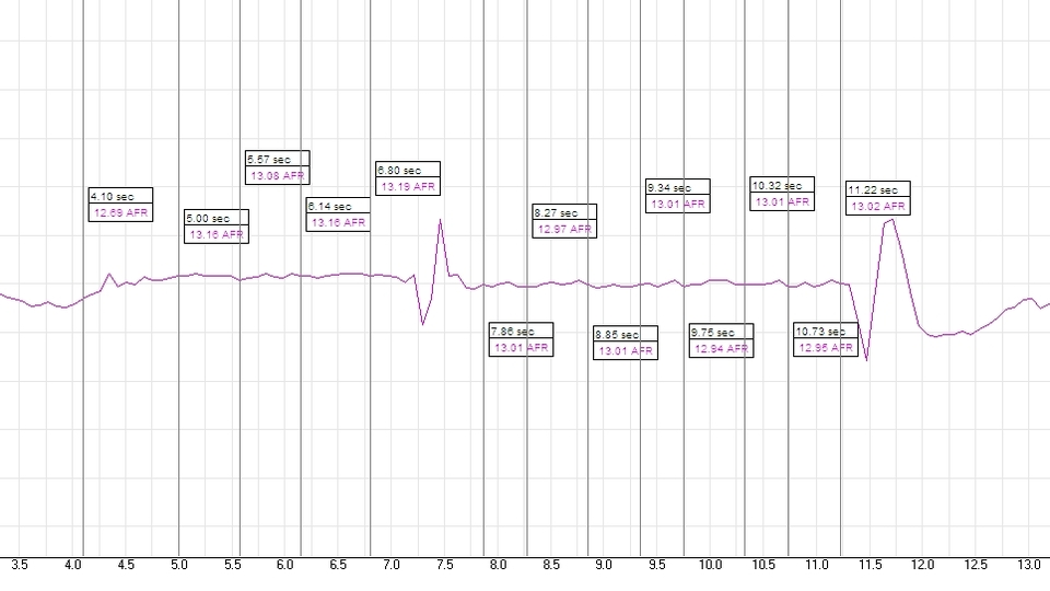

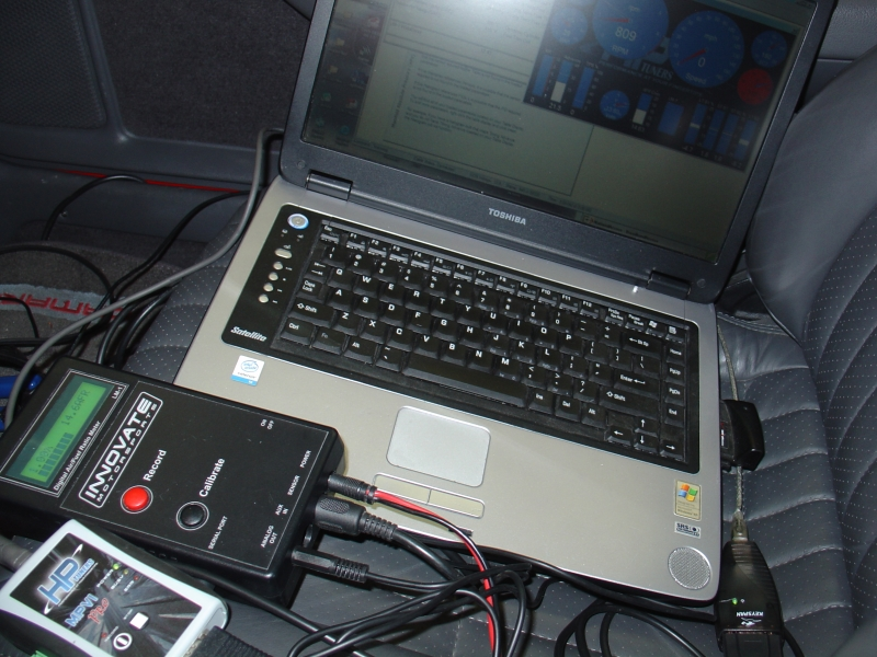

here is what my AFR looks like now after one last 0.5% correction to the MAF transfer table after looking at the track logs. One last verification at the track, the place I fine tune for and the LM-1 comes back off for the Cobra. This 4th gear highway pull is not smoothed, unlike all those Dyno AFR plots that you are used to seeing.
there were a couple cameras rolling, movies to follow.
