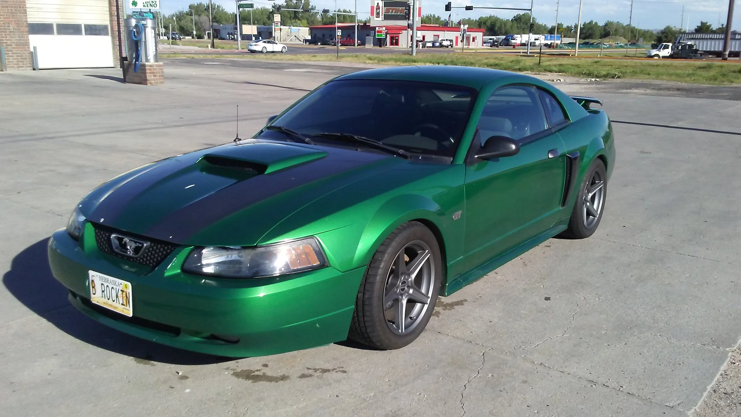

If not for me, do it for my mustang. How could anyone say no to that smile?
