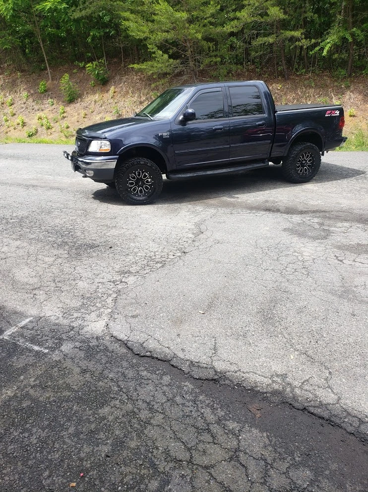

I have a full LED light conversion on my 2001 F150 SCrew and people hate me. I need the bright light for back roads that I drive down. You think my headlights and fog lights are bright.... wait till you see my Rough Country light bar and flood lights at night. If you were a vampire, looking at the light would turn you into dust! My fox will be getting the same treatment. I gotta see too right? *Edit* Super Bright LEDS dot com supplied me.
