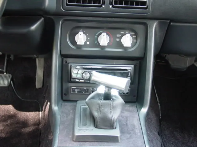

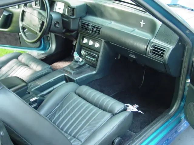

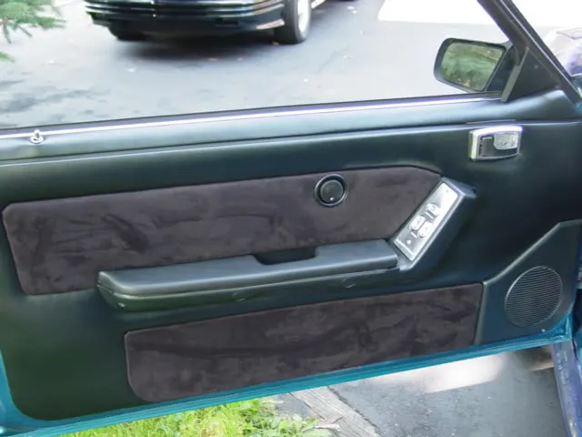

I used 50resto vinyl prep to clean them and then painted them with 50resto vinyl paint (1990-94 Black). They turned out great. The only problem I had with the door panels was matching the paint. The first time I ordered it, it was more of a flat black. I ran out so I ordered another can and it was really glossy and didn't match the other door panel. I called and complained and they sent me some more free of charge. They gave me the run around saying that paint varies lot to lot. I would just recommend ordering enough the first time so you don't have this problem. I haven’t had any problems with it peeling off.
I also covered the upper insert and map pocket in black suede.

I think im going to check my local craft store to find some type of fabric to use like you did, looks sharp
Thanks, you can buy almost any type of material by the yard. I think I paid less than $25 and I got enough for both door panels, headliner, and shifter bezel.
I just used adhesive spray in a can and covered the old material. I also used a little hot glue on the back side where it folds over. Looks great an very easy to do. Good Luck.
