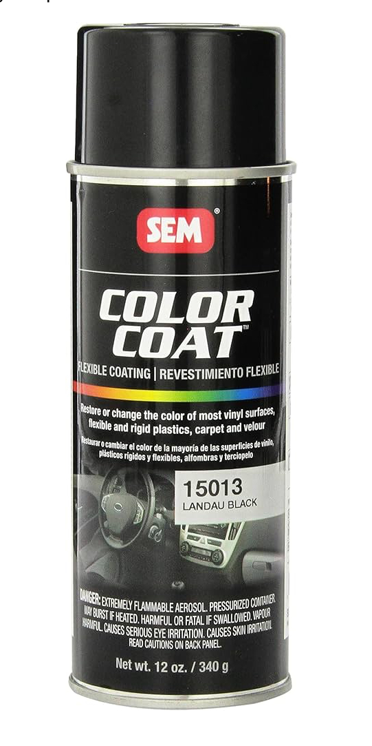

SEM landau black

I used the SEM stuff on a new lower knee panel which ships white. The SEM stuff covered it excellent and matched the interior perfectly. My interior is red so I was worried about a good match. It's looks absolutely perfect.
I used the adhesion promoter spray they also sell. I'd recommend using that. The directions mention to use it on plastic.
