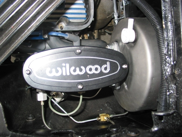

That is exactly what I did too...except I have hard lines at the rear all the way into the claipers.
That's what I was trying to say guys... but thanks for confirming it for me. So in summary I should put the MC that Baer gave me in there. And then ditch that factory block. One line to the rear and prop. valve. The other line to a new TEE.. .which splits to the front calipers.
Great. thanks again guys...
