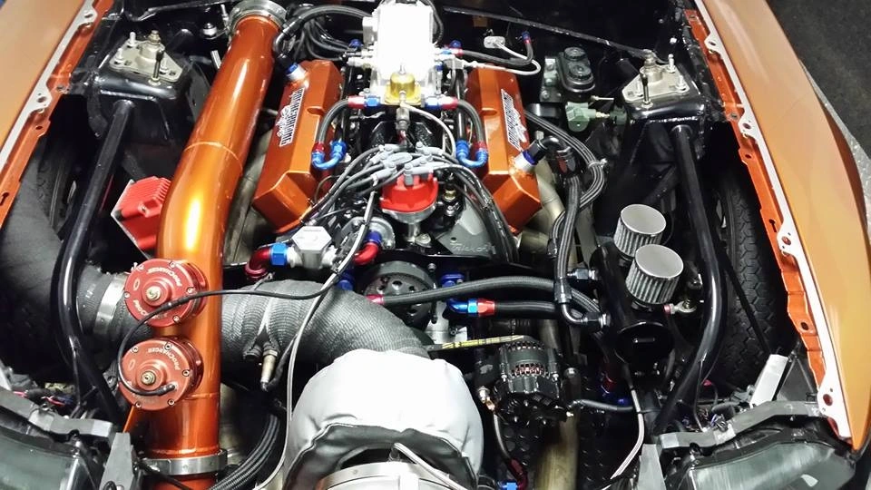

Your boss' car? Greaaaaat.
There is a reason I have my 3.73/26" combo... but if you asked the right questions, you'd know why.
And that car is hardly relevant here.
