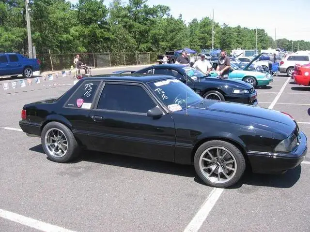

as for the 28" street tire look 295/45/17
That car sure does look nice, but I think because of how fast it is. If it was a 12-14 second car, I'd probably think the large tires were over kill.
