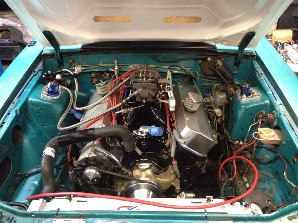

I will play the devils advocate . I have done a swap for someone the car is on the road about a year this month . we used and Aje k member and control arms . no issue besides the control arms needed ball joints and the wholes being oblong and and AJE warranted them for nothing . Mind you the k member is now 2 years old or so . it lived originally housing a BBC we did in the car . Just my .02 cents
With the Chevy for reference .

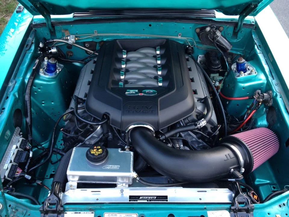

There is no flex in a UPR k-member for "spirited DD." I drove my Fox on the street with 1000+ hp and a bolt in UPR k-member. No problems.
