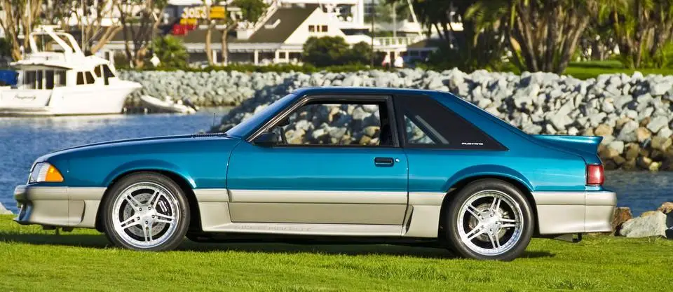

Reverse was not available when I got my kit. I am running 3/4" forward offset ( forgot the name) 18x9 255/45/18
You can see they are forward in this picture. I did have some minor rubbing so I made some home made fender spreaders.
Thanks! MM tech guy said had to for 1.5 and probably the 3/4. Tru Forge looks like? They sit real nice in the pic. So you thinking reverse then is best to start out with?
I have the reverse offset arms for the same reason Grover mentioned. A street toy won't see the benefit of a longer wheelbase. I run 18x8 up front with 235 tires. I went more narrow so I didnt have to deal with rubbing. I don't have fender liners yet, but no rubbing to speak of now.
I think Im gonna run Saleen SC 17/8 and 17/9 initially, I love the SC in chrome. I like the look of your Mach5s and how they sit Scott glad I get an idea of the reverse offset, Thanks!
