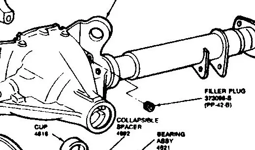

level of rearend fluid
Take out the fill plug (3/8" or 1/2" square recessed drive) located on the side (passenger side I think) of the differential housing about 1/2 way up. Level should be up to bottom of fill hole.
Rick
sounds like you need a new differential pan gasket...but heres a pic. of the filler hole fill until fluid seeps out hole then cap...if you drain and install a new gasket ensure you add friction modifer...
Before I drained fluid, I'd want to clean it up and ensure it's not a pinion seal leak.
And I didnt mean to be redundant last night (that's a pet pieve of mine). Last night Bill's picture didn't load when I pulled up the thread.
Good luck.
