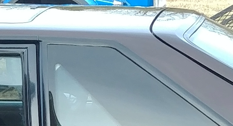

When changing my struts a couple years ago, I over lifted my hatch and lid hit roof and made nasty dent. I cussed a new language in that instance. I used some wood paint sticks, some gentle flat body hammering, a lot of patience and now unless you are looking for it you will not notice anything. I was very impressed with myself.
I would definitely agree you do not want to go too long with the lifts.
Pic taken long after the repair. It was driver side that got damaged.
