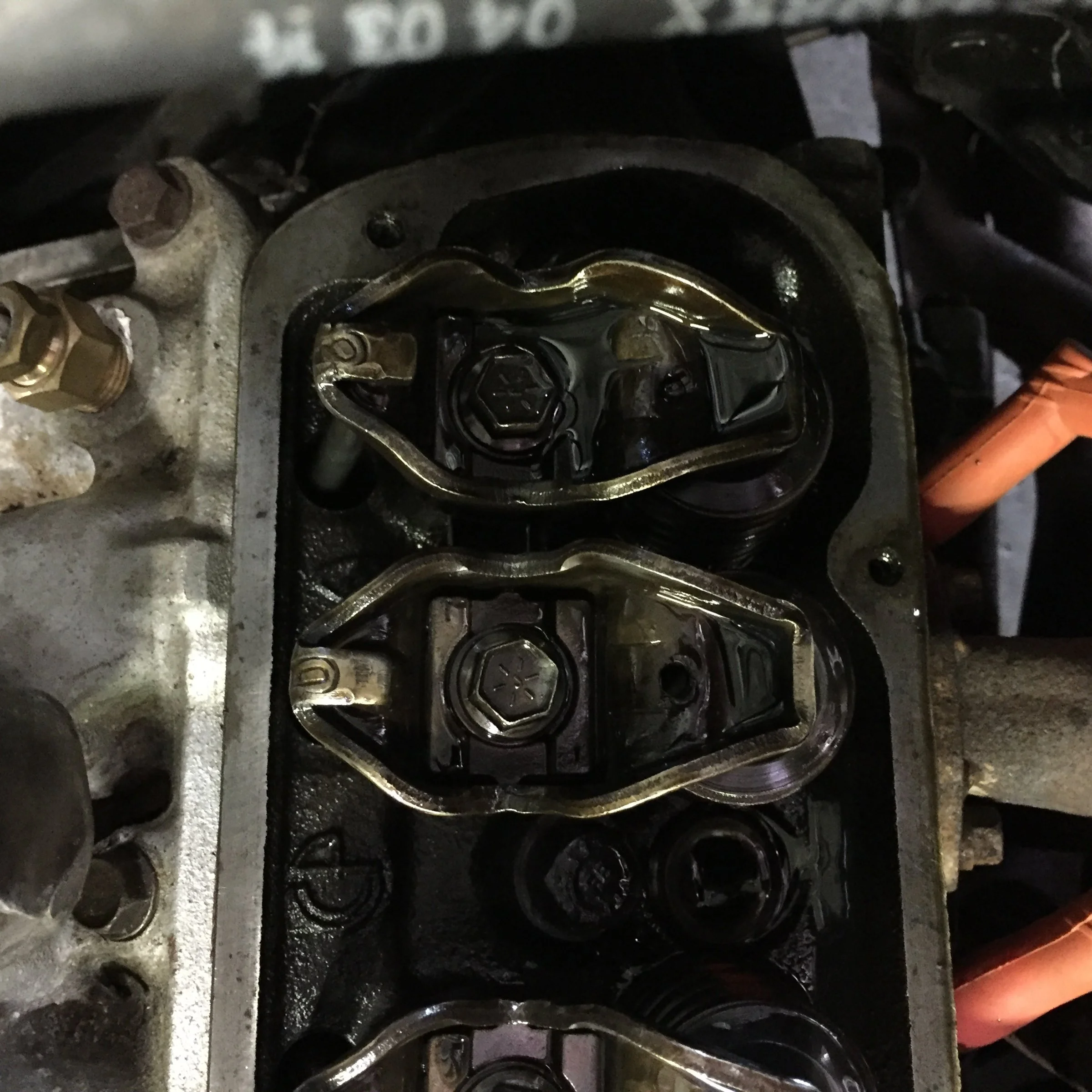

Pulled valve cover, # 8 exhaust rocker & pushrod are wiggly.

like I thougth, adjust the rockers on #8. Hopefully you dont have a collapsed lifter.

Forgive me for being dumb but how? From everything I've read you just tighten the bolt down. It's tight and will not get any tighter. How does the lifter collapse? I removed the rocker arm and pushrod, they seemed undamaged, reinstalled and still same result.
I've seen lifters collapse from sitting with the valve open....pressure on the spring, rocker, pushrod, and lifter. The oil bleeds out of the lifter and on start up it refuses to pump up.
Sometimes letting it idle for a while will allow it to pump up. Revving and holding about 1500rpm has worked for me in the past...but usually the tick will still be there on cold start ups.
Better to pull the intake and replace it now than to score the lifter bore. Lifters are cheap....everything else...not so much.
