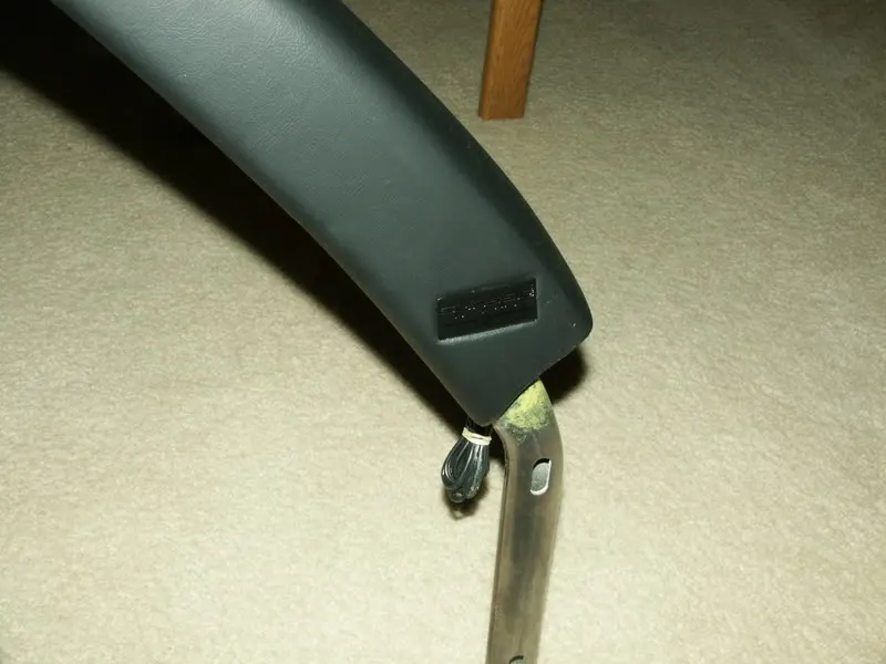

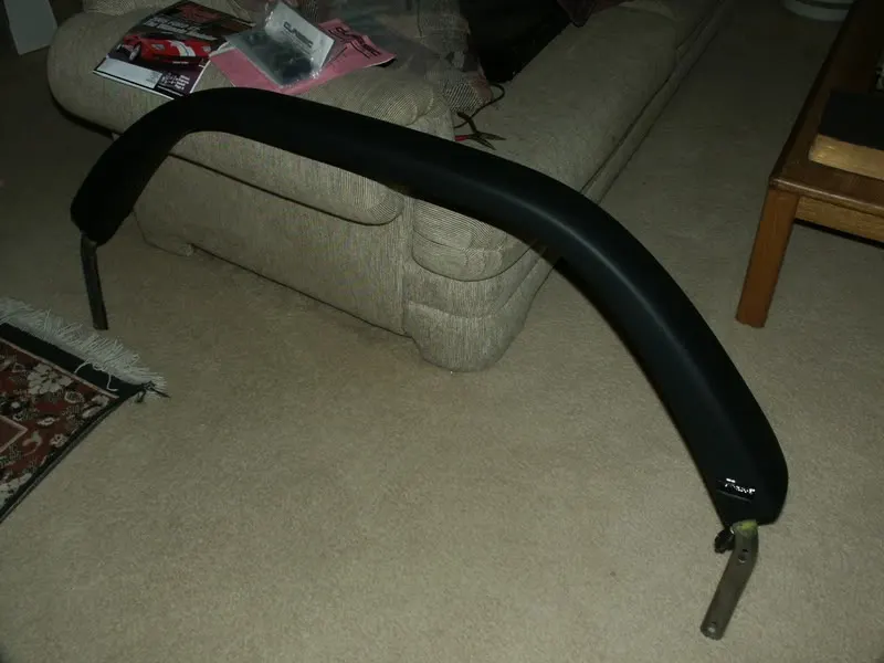

Here's some pics before I installed mine myself...
See how thin the tubing is?
And look at how the tubing is "flattened"... no tubular strength...
See my point? It's all show.

yup about 6 years ago...
and I see your point I just don't agree with it ;)
the CDC bar is advertised as being 1/8" (.125) wall 1 1/4" dia. tube (and I just went and popped one off the stupid caps off to check the thickness :D )...and NHRA calls for .134 wall and 1 5/8 or 1 3/4" tube for roll cages...so the diameter is less than optimal for a roll bar but the wall thickness is pretty darn close :shrug:
and the flattened part is just the ends, with it upside down I could see where they compressed it...and from a manufacturing stand point, it is many times easier to bend a round tube than a flat tube across it's long axis, so it would make little sense to use a flattened tube for the complete bar...
anyway, it's no big deal, but I KNOW it made a huge difference in the stiffness of my car...
