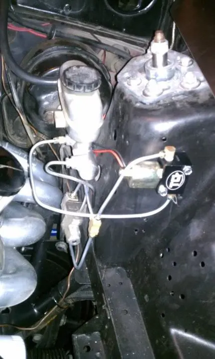

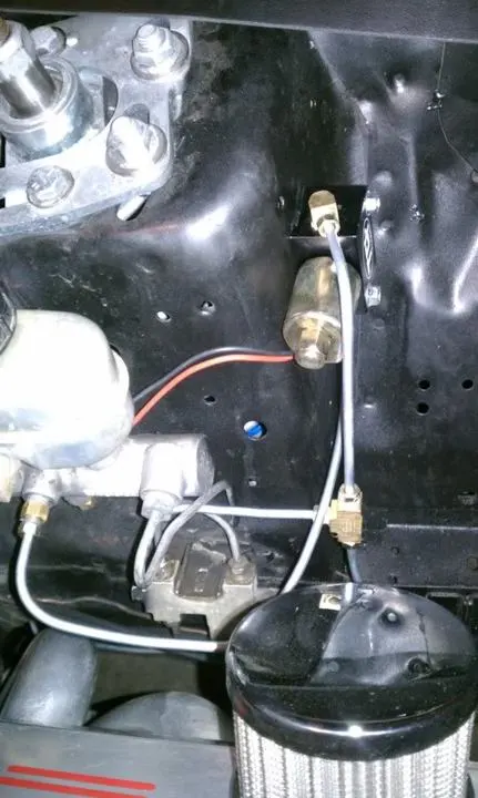

Line Lock....Is this right?
TokyoJoe
Mar 25, 2007
179
Looks a little wierd to me....Is this right?
Well, not ideal and not how I would have done it....but it's no different than stock with regards that one front wheel sees full line pressure and the other goes through the combo valve.
However, I think you are ok
