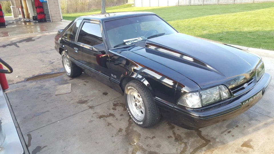

Hello friends jus curious if anyone has any experience with liquimoly oil made in germany i just bought my first mustang and went to add oil and the guy said he uses moly oil in some kind of racing oil..
