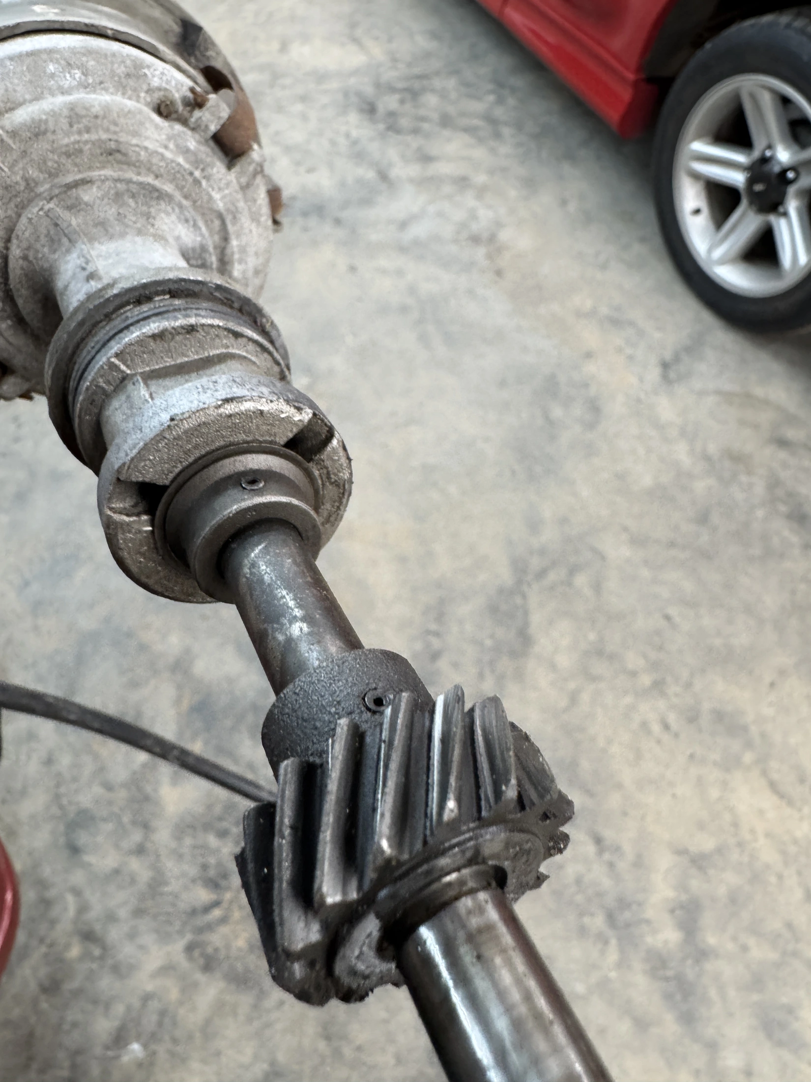

So this Facebook fox body has an aftermarket cam. The guy I bought it from did no engine work and he said this was the engine that was in it when he bought it. He started to pull the motor because it was leaking oil and he already had the distributor removed. He also had a spare distributor that he gave me. The gears on each one are different. One goes in the motor fine the other one binds up. The one that binds up has the classic squared off edge to each tooth. The one that fits in the motor fine has a noticeable machined point at the edge of each tooth. Do you think this gear was made this way or is it the wrong gear material and has simply worn this way?

The one in your photo looks pristine.

According to my harbor freight compression tester.#1 175 #2 215 #3 205 #4 200 #5 225 #6 215 #7 140 #8 started to build up then nothing, Also #1 and #5 showed less than 100 psi the second time. I did the test twice since the readings weren't consistent. I'm guessing this is valve related. Because the engine was not running when I got it I want to get it running simply to test everything before I start removing stuff to repair/refinish. I want to have a blueprint for the whole car before I start removing parts. The gears on the distributors I have look to be cast iron. Should they have installed a steel one?
Should have been steel with a roller cam. You need to have the motor up to operating temperature when doing a compression test. A leak down test will be of more benefit with a cold motor.

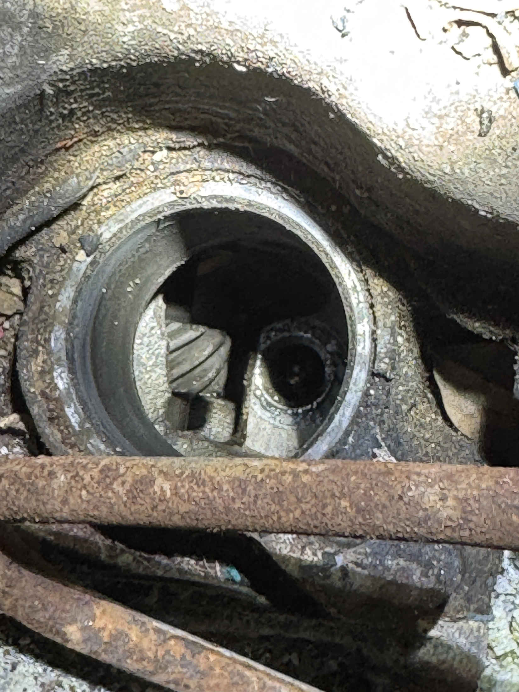

If the engine condition is unknown, I'd make it run if possible with a small amount of labor/expense, but you have to weigh the effort, you may be farther ahead to get a running engine or just rebuild that one, more so if it's the original block.
Depends on your goals.
My thought process:
Pull the heads and lifters. Put some Marvel Mystery Oil down each cylinder and roll the thing over by hand.
You will be able to get a good look at:
Gaskets and seals
Valves
Pistons
Cylinder walls
cam lobes
distributor drive gear
Lifter wear pattern
All in one shot! Plus new head, valve cover, and intake and exhaust gaskets.
It occurs to me that there might be a reason that distributor gear is mauled up. Pulling the heads will tell you if there's more to the story.
