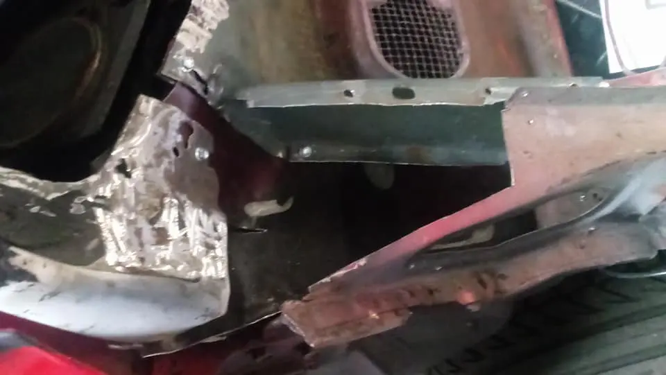

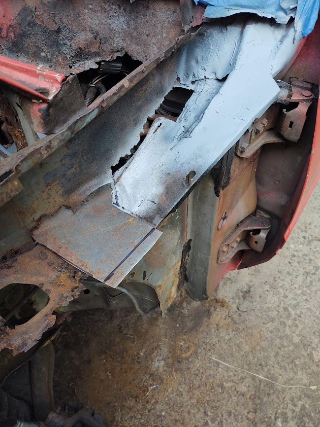

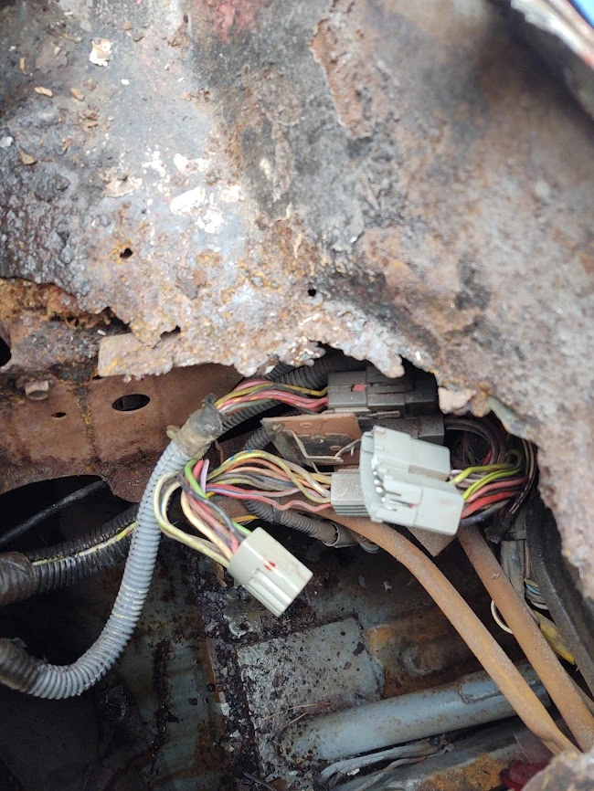

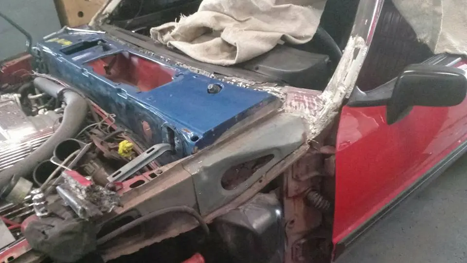

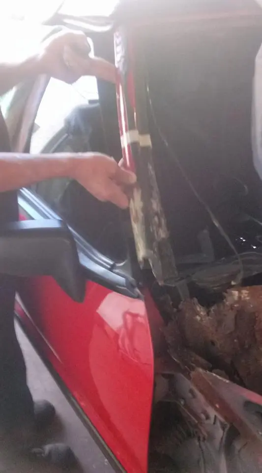

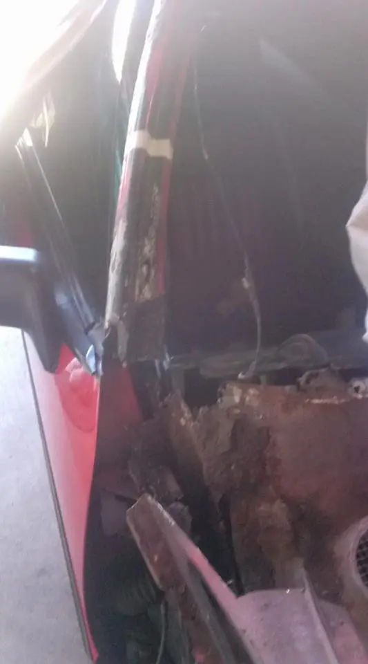

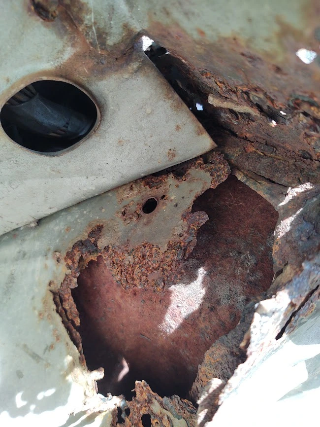

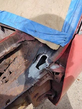

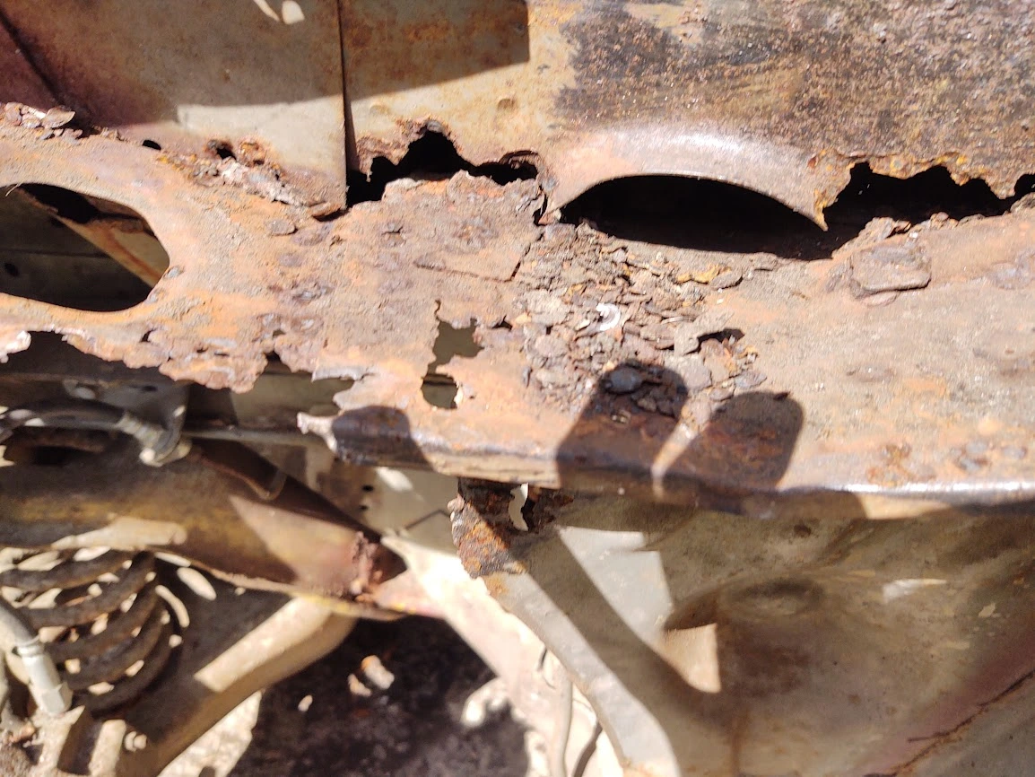

So, I welded up my rusted windsheild flange a couple years ago due to leaks.
Found that I had more leaks in the rusted cowl bottom, so I finally took it apart this week.

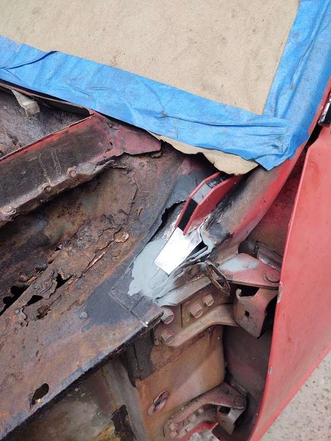

This aint gonna buff out. Pita, but the first patch is in place. The last photo.
Suggestions welcome.

very common problem on these cars... i suggest you investigating how deep that rabbit hole goes. That looks especially invasive and you are probably looking at floorpans, potential rocker panels,,, strut towers... etc.. i would be looking for a donor car to replace all that rotted sheetmetal. No one makes a replacement cowl piece.. LMR and AMD make some replacement panels.
Been there done that back in 2017,,... was not fun and the car was down for almost a year...

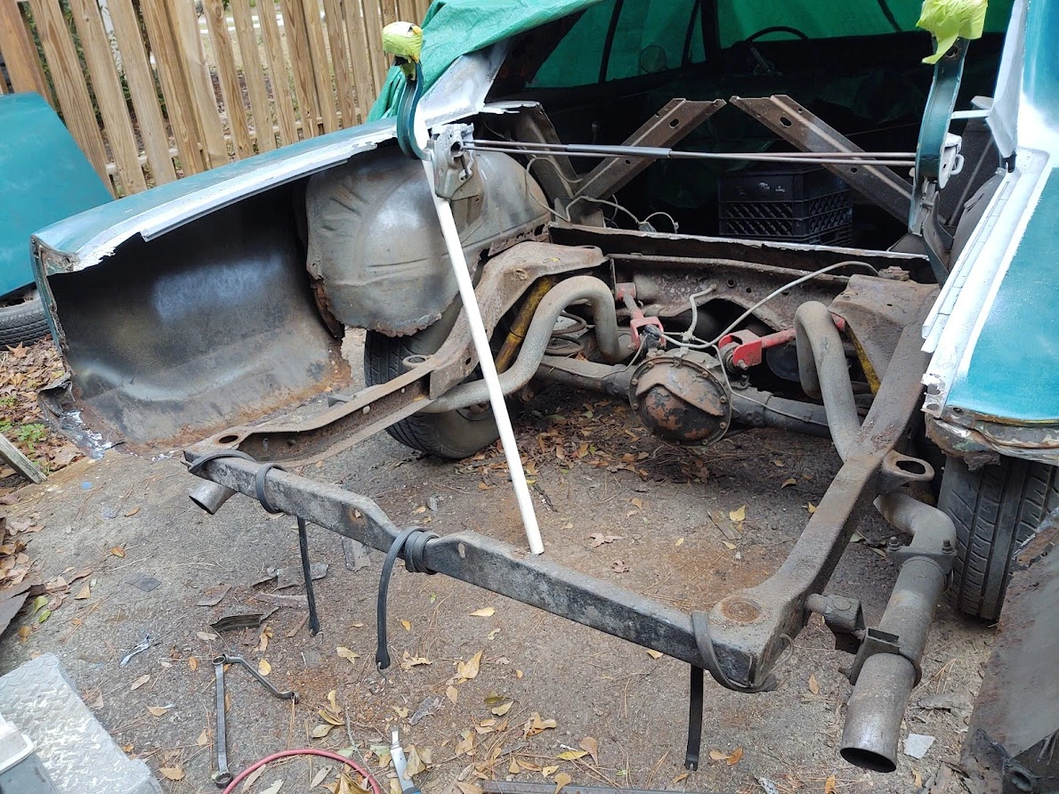

I do wish there were more panels available for these. I just finished installing a new deck filler, package tray , trunk floor, drop offs and tail panel in my 66 Chevelle. This was sitting beside it rusting as a worked.
The 66 Chevelle during the trunk, deck filler and tail panel escapade.....

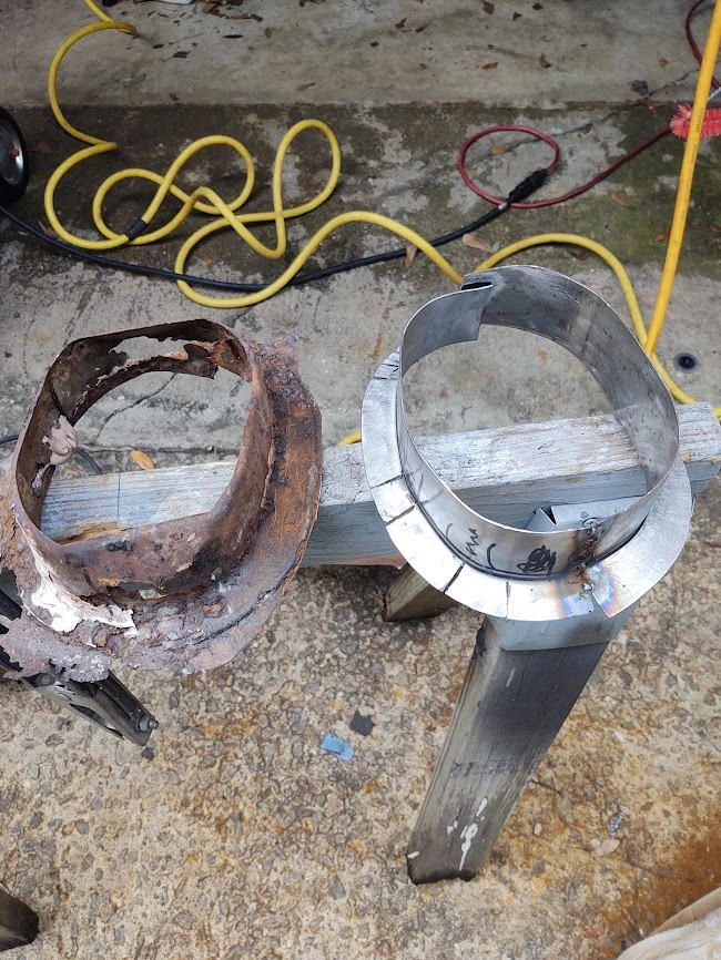

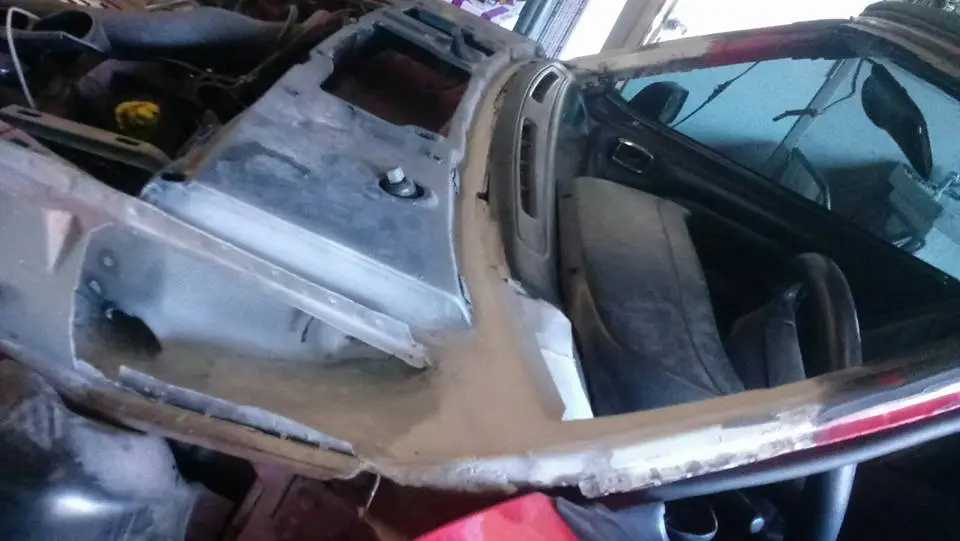

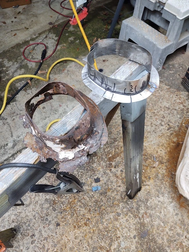

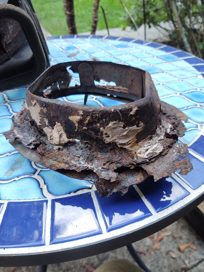

Todays effort, the start of the repro of the drivers side vent intake that sits in the cowl. This is a non ac car..

Ouch lot of rot in that spread over a few areas... Good thing in the majority of fox bodies share that upper rail brace and reinforcment so you can grab some of the sheetmetal when fixing it without the mustang tax.

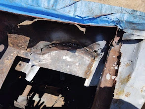

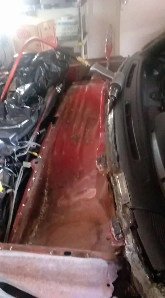

Started putting in the rear upper cowl area patch today. Quit because it was 92 in the driveway.
