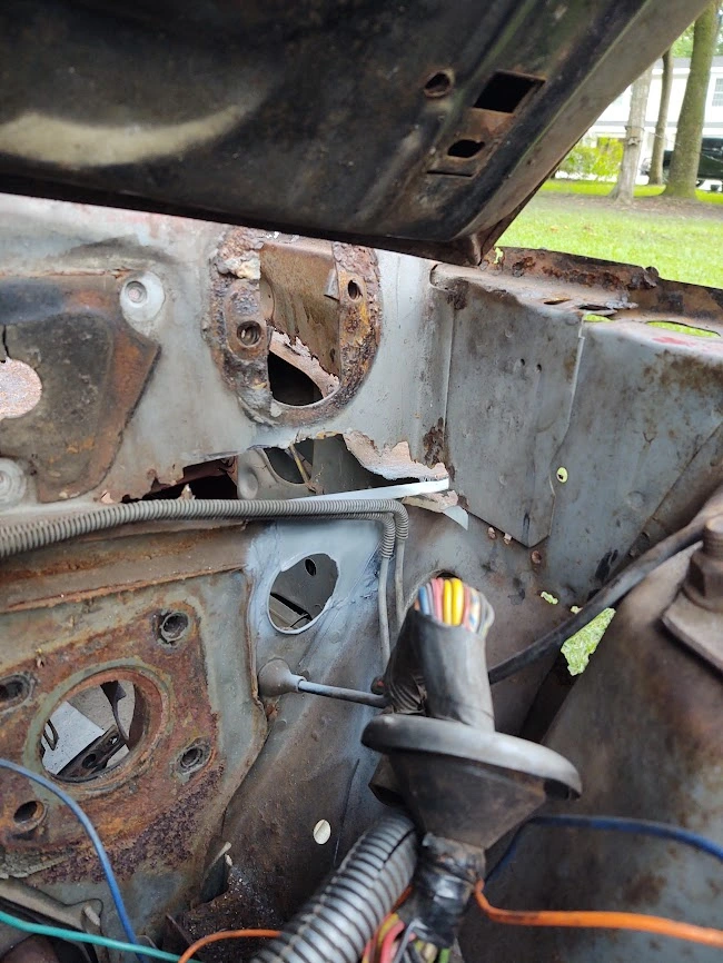

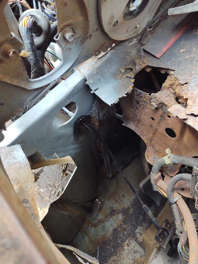

Got one patch on the lower a pillar last week.
Today I got what I hope is the hardest patch welded in. Its the firewall at the area the wiring harness goes through on the 82. Not difficult, except shaping the piece took a couple hours, and the whole thing had to be planned so I can get the mig gun in there.
