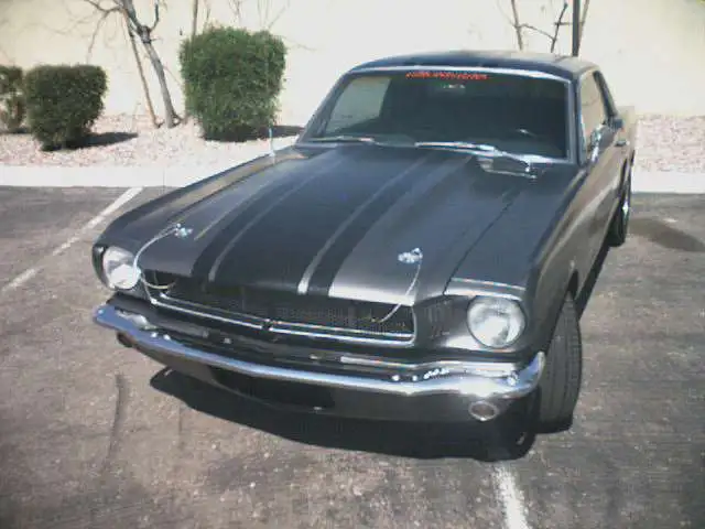

here is a pic of what my car looks like now

getusummm -- do you have a pic of what your pins look like now
