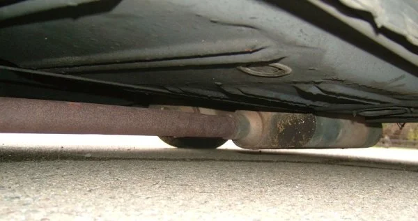

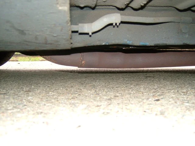

should i even attempt to get long tube headers with my car being this low? right now (in the pics) you can see my existing exhaust system is hanging about an inch above the ground, its a really lousy exhaust system done by a muffler shop before i got the car. but my question is, would i gain any ground clearance from what i have now (with the crappy exhaust system) if i got some long tube headers and some properly installed exhaust?

I was just looking at the long tubes in my 1970.
With my headman longtubes, the header pipes hang exactly as low as my frame rails. However, the header flange is about 1/2" lower than the frame rails.
Don't know if the same thing can be done with your 68... but on my 70 with longtubes, the exhaust doesn't hang as low as it does on the car pictured above.
Nice car, although I wouldn't go over any "speed bumps" or up any steep driveways...
By the way, is that your fuel line with the rubber hose connection? If it is, I'd replace it with solid as soon as possible. I know it looks closer than it really is due to camera angle, but you don't want to spray fuel anywhere near that exhaust.
