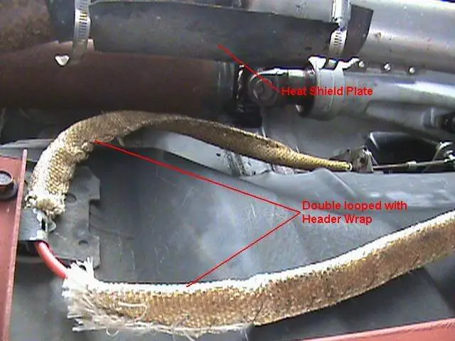

I had that problem with my '86 and the LT's........ what I did was attach a fabricated wire strap to ensure the clutch cable didn't contact the header and create a gap between them, and wrap the clutch cable in a double looped section of header wrap I "sewed" myself. The following pic is what I did for the automatic transmission shifter cable of a SN95 to prevent it from getting burned for a 3rd. time...... worked great in both cases.
