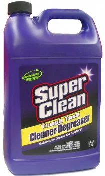

As far as cleaning grease and stains under hood go, I've always had great luck with this....
You can get it just about anywhere, but I doubt even it will clean years worth of set in stain on your intake. Unless the paint is flaking, I wouldn't even strip it. Just give it a good wash, a light scuff and paint right over the old stuff.
