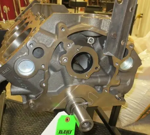

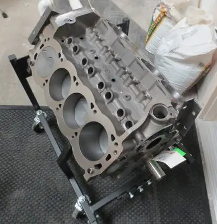

Have you started the build? Sounds great. Just waiting to sell my blower to help fund the block.
Not trying to high jack this guys build, BUT since you asked, ....meeting the dude thursday about this GUY!!!!

Hell yeah man i see you in the south side, cool for sure. My build will be a street torquer and probably p!ss some guys off cause I'm not gonna max it out or go to the top end potential, but I can add a s/c when I want and change it up after the dart n/a build is over anyways :cool:
No doubt, there's always someone finding something to complain about it. Hey, I got a little roots blower you can throw on there. Talk about traction, haha.
