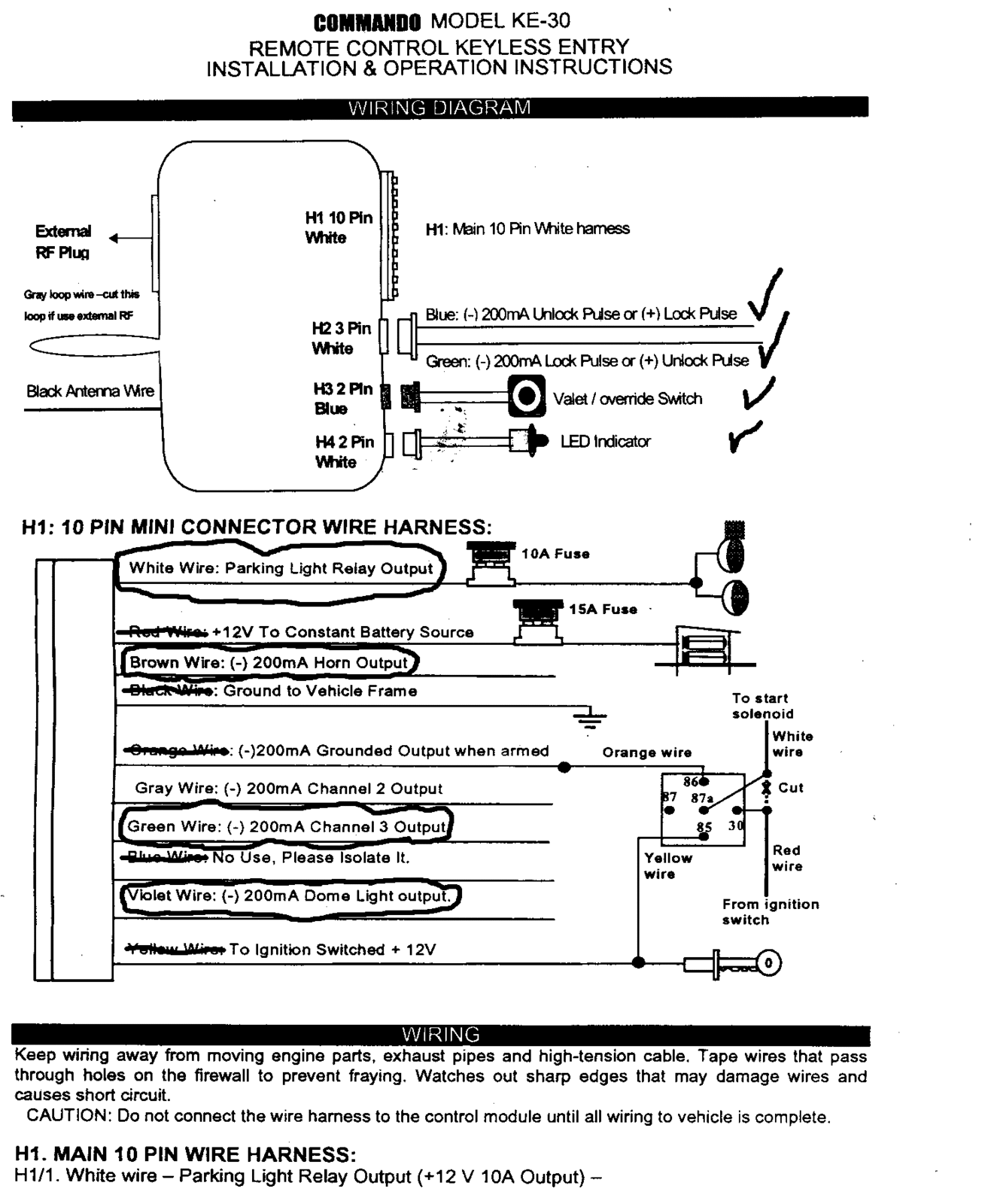

I'm working on putting a Keyless Entry into my car, I feel I’m pretty well off with electronics and wiring, but its when it involves the car that I fall short. I've done as much as I can personally and was looking for any help that someone could give me, either run me through it, or could actually give me some hands on help.
All I have left for the keyless entry is to connect it to the Horn, parking lights, and the dome light.

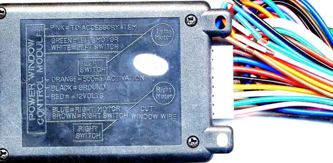

I also have a Power Window Control Module (Allows you bring the windows down with the remote) for the keyless entry that I have no idea how it hooks up, I have tried some things but with no luck.
So if anyone out there can give me a hand on finishing this that would be awesome.
