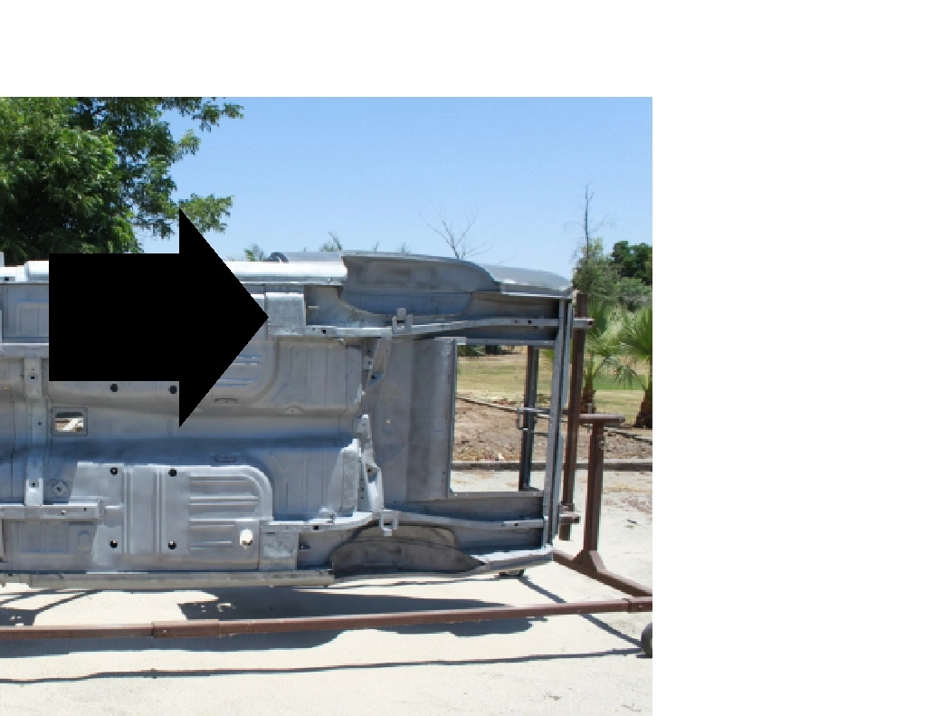

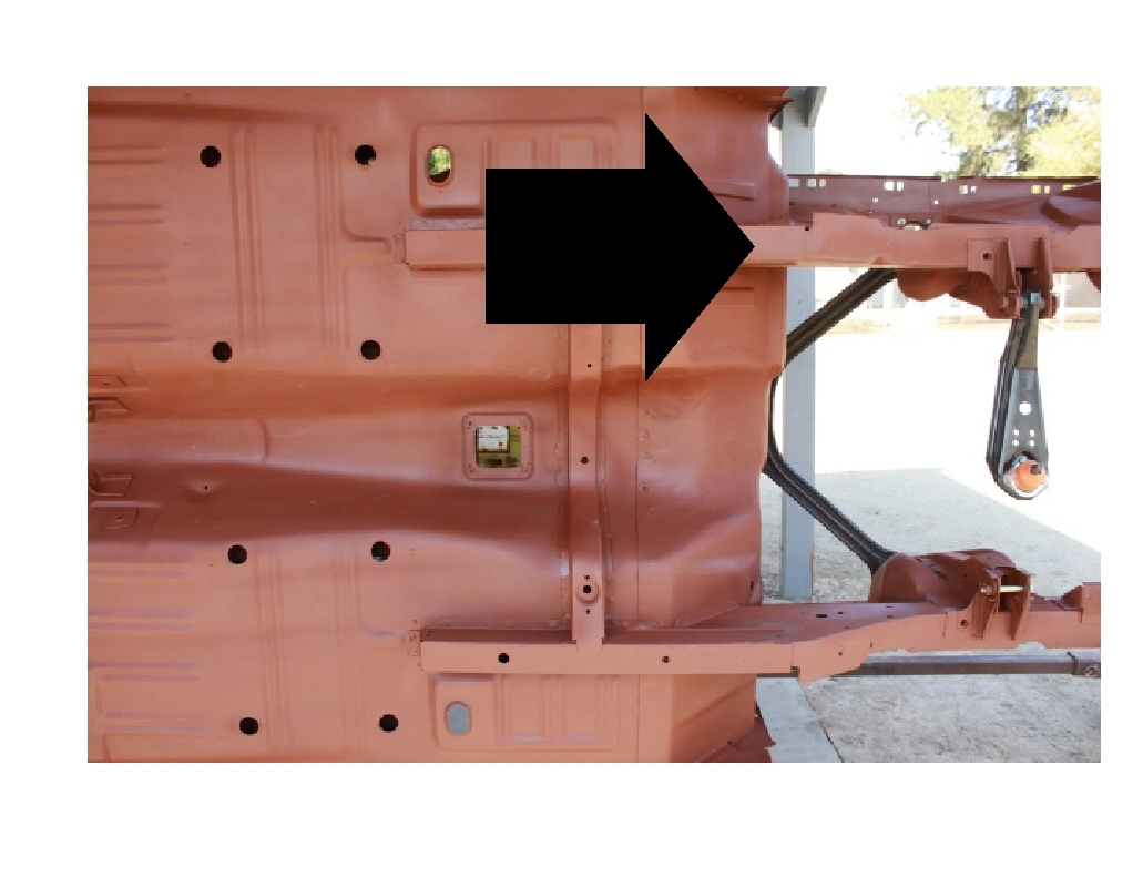

I put stands under the rear axles, as wide as I can given what I want to do (for stability), and under the most forward, level, section, of the front frame rails. You will have to unload the the springs (front and rear) to do what you want to do, so these are the best places, IMHO.
place a block of wood under the rear torque boxes to spread out the load and put jack stands there. in the front, place blocks of wood under the front frame rails were the floor support overlaps the frame rails this is a strong spot. the blocks of wood will keep the boxes and fraim rails from being damaged by the jack stands.
Having done this myself, I second that plan!
