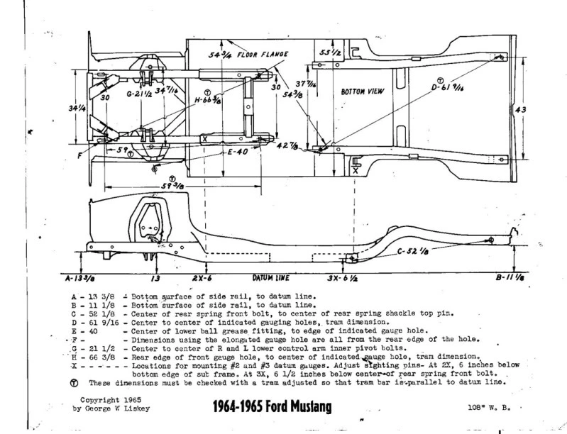

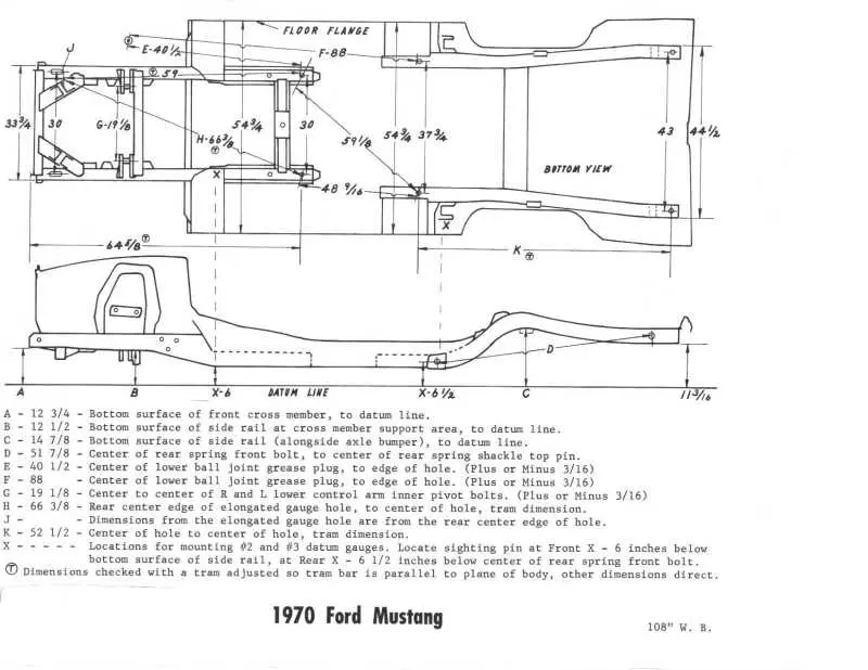

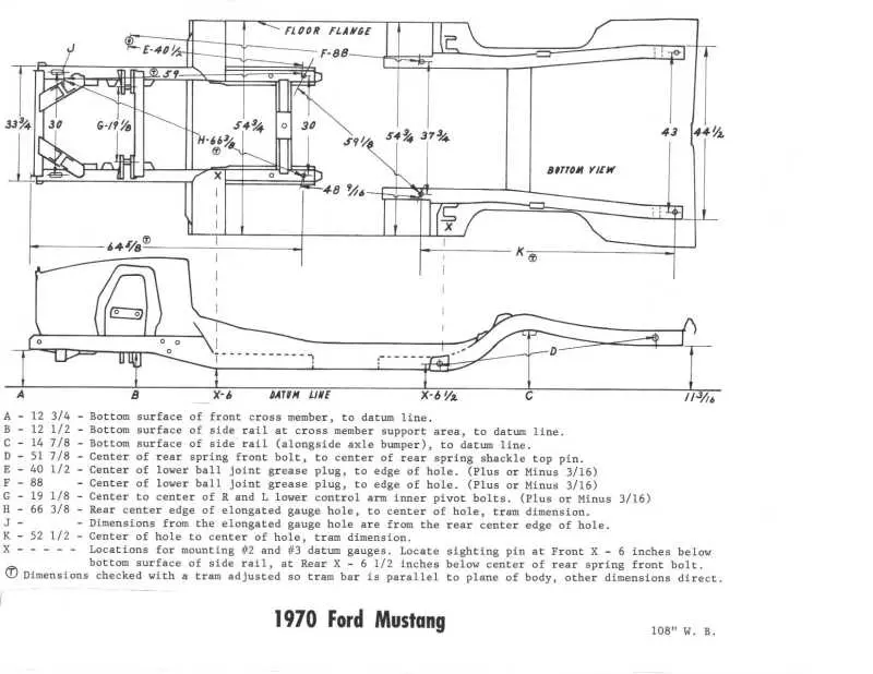

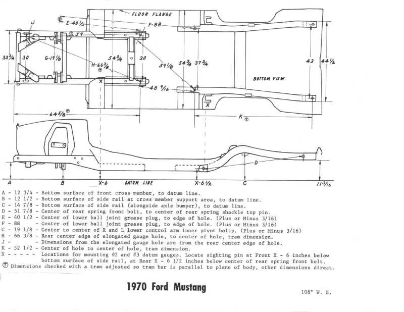

S stangnet33 Member Dec 23, 2011 3 1 13 Dec 23, 2011 #1 Dec 23, 2011 #1 I'm replacing a couple of inner fender aprons, rear taillight panel and rear frame rails. Looking for chassis specs for this and also would like to check a few other things on the car. any help appreciated.

rusty428cj 10 Year Member Sep 29, 2007 943 266 104 Port Richey Fl Jan 2, 2012 #4 Jan 2, 2012 #4 Attachments frame.webp 44.8 KB · Views: 339

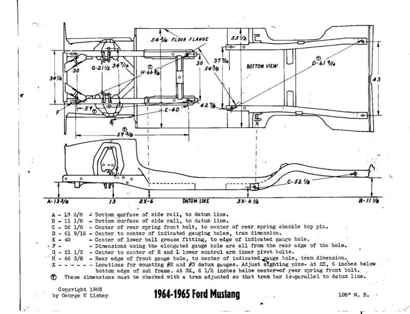

bikefreak600 Member Dec 10, 2005 157 2 19 rochelle IL Jan 2, 2012 #5 Jan 2, 2012 #5 rusty428cj said: Click to expand... rusty, dyou have this schematic for 65-66 ? Attachments frame.webp 44.8 KB · Views: 1,957
rusty428cj 10 Year Member Sep 29, 2007 943 266 104 Port Richey Fl Jan 3, 2012 #6 Jan 3, 2012 #6 Attachments 64-65MustangFrame.webp 81.3 KB · Views: 482
