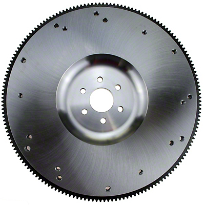

34008 - RAM Billet Steel Flywheel; 6 Bolt (96-98 GT; Late 01-10 GT)
Item #: 34008
$279.001

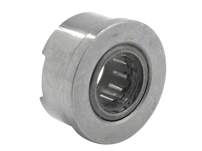

50116 - Ford Performance Roller Pilot Bearing (96-17 GT; 07-12 GT500)
Item #: 50116
$14.991

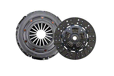

399720 - RAM Premium OEM Replacement Organic Clutch Kit; 10 Spline (86-95 5.0L)
Item #: 399720
$189.001

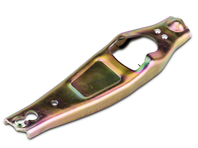

394002 - McLeod Clutch Fork (94-04 All)
Item #: 394002
$60.001

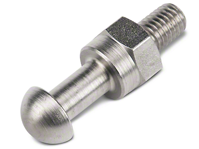

387099 - Ford Clutch Fork Pivot Stud for T5, T45 or TR3650 Transmissions (79-04 All, Excluding 03-04 Cobra)
Item #: 387099
$21.991

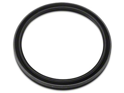

383852 - Ford Rear Main Seal (96-10 4.6L)
Item #: 383852
$20.571

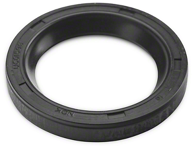

383875 - Ford T-45 Input Shaft Seal (96-01 All)
Item #: 383875
$42.991

A couple of thoughts, without knowing the condition of your existing equipment. You may be able to have your existing flywheel resurfaced saving some $$s. The clutch fork and pivot, while insurance, may not need to be replaced either. Consider adding a new clutch cable to this job unless it has been recently replaced. When removing the pressure plate and flywheel, consider going back with new bolts (not necessarily a requirement)...blue or red loctite. The clutch you've selected looks as good as any...however, you might check locally for a rebuilder or rebuilt units at a cost savings. Cheers.
I don't think you'll need the seals unless you have some leaks going on. I also agree with the ball and fork delete unless there is considerable wear on those items. One thing I would do is make sure THAT clutch you selected fits your setup. Another thing to have is a input (pilot bearing) removal tool. i.e. slide hammer with puller, etc. Those are a bit..h to remove without one.

  1. Autozone Duralast / Clutch Part #:NU31175 $160 ish (clutch, pilot bearing, thowout bearing, pressure plate, alignment tool)

  3. Autozone FEL-PRO / Rear Main Seals Part #:BS40620 $26 ish
  4. American Racing - Ford Clutch Fork Pivot Stud
  5. American Racing - Ford T-45 Input Shaft Seal
  6. Transmission Shop - Flywheel, just resurface it for a Daily Driver (as stated above $100 ish for labor)
If you looking to "refresh" and you are going to have it all apart anyways, I would do all you suggested in the original post. But I would get most of it locally from AutoZone or another Parts place because they will stock a quality part for a Daily. I just re did my Clutch and went through AM for my parts, It went bad, long story, but in the end I have the AZ Duralast Clutch kit in it now and I am perfectly happy.
If you were looking for performance, then AM all the way because I trust them and LMR for all of my needs. BUT why pay the prices for parts your not going to use their full potential. OEM in my Shop means Duralast or Parts Master. I hope that these part numbers get you closer to where you need to be.
