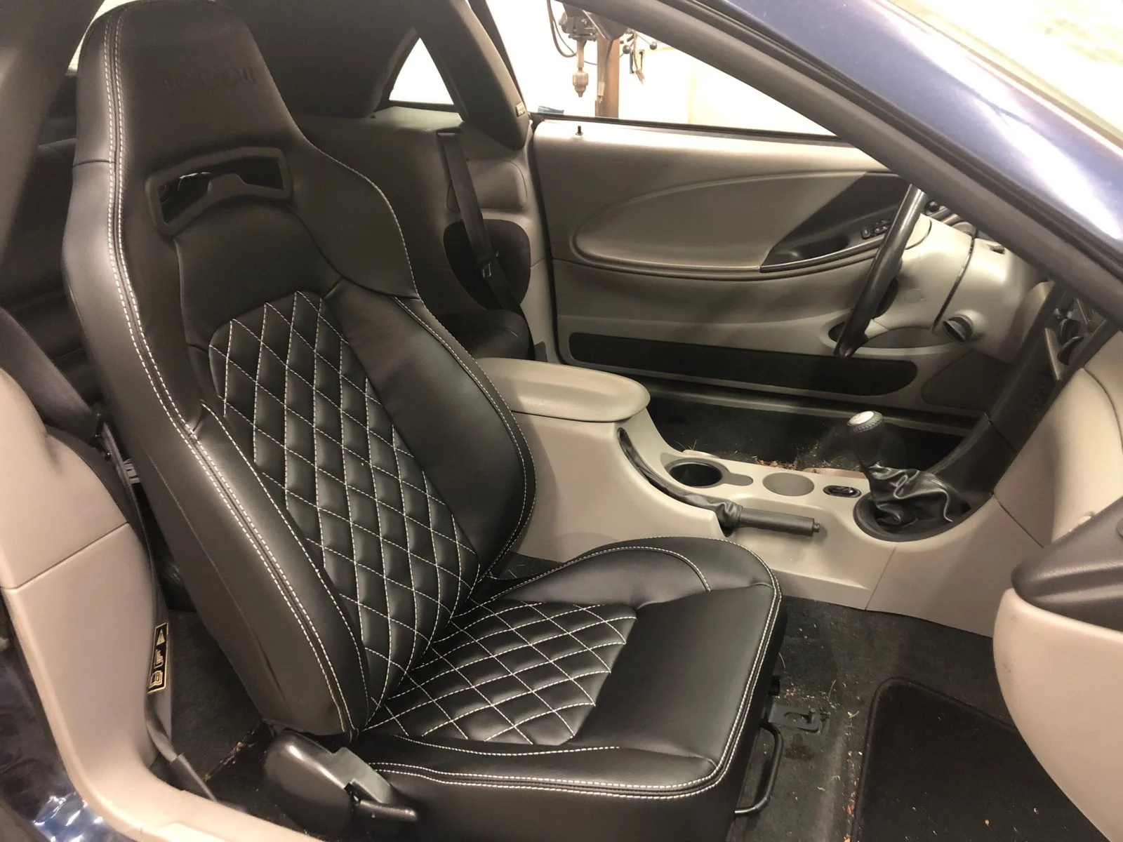

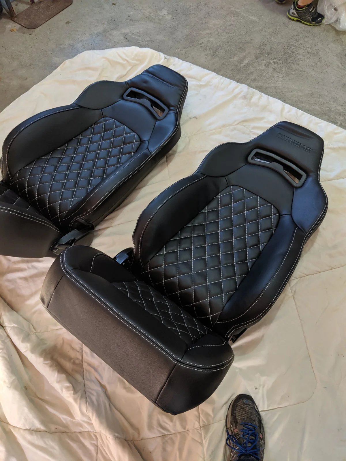

Seats arrived! Headrests a little crumpled from shipping, but should straighten right out. Side bolstering is just right for me... Definitely not as aggressive as a hardcore race seat, but plenty enough to hold you snug. The fake leather looks surprisingly excellent up close.

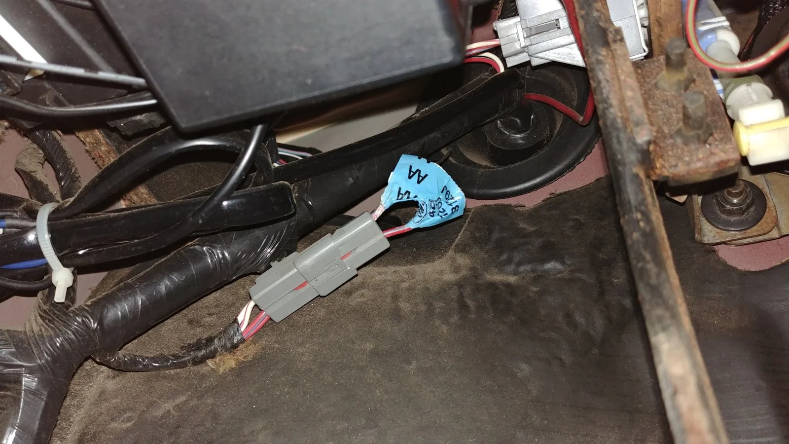

As far as I know, these cars don't have a neutral safety switch, just a clutch safety switch. The car should already have a connector for the clutch switch under the dash. There's a little jumper on a two pin connector above the drivers side kick panel, it's for the automatic cars(I'll add a picture). Plug in the clutch safety switch and unplug the jumper and the car shouldn't start without clutch pushed in. Hope this helps!

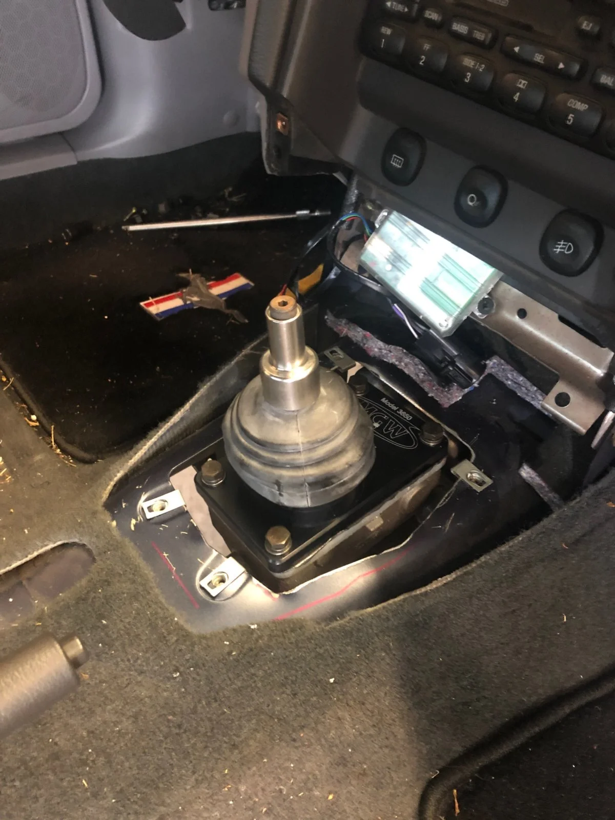

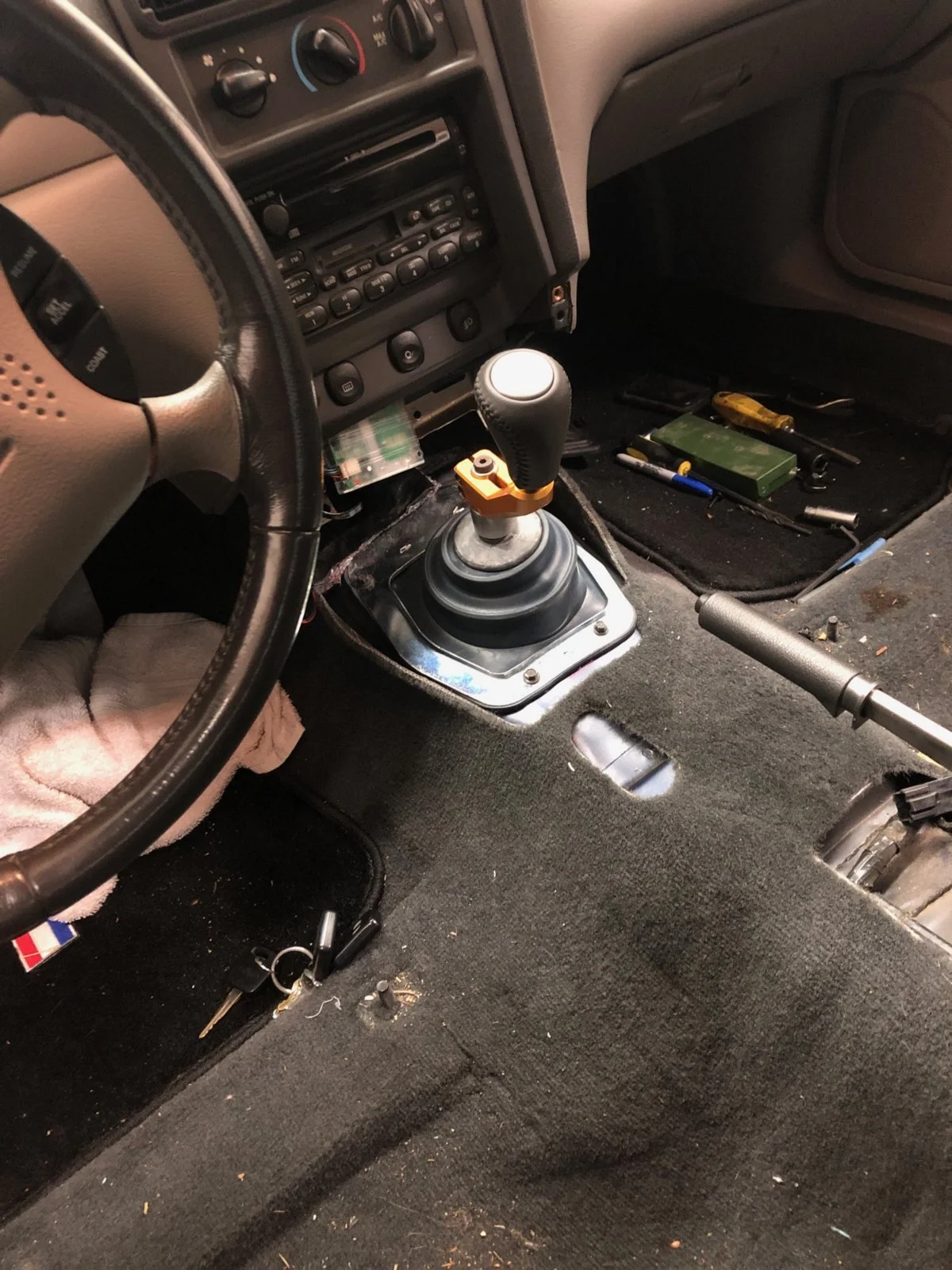

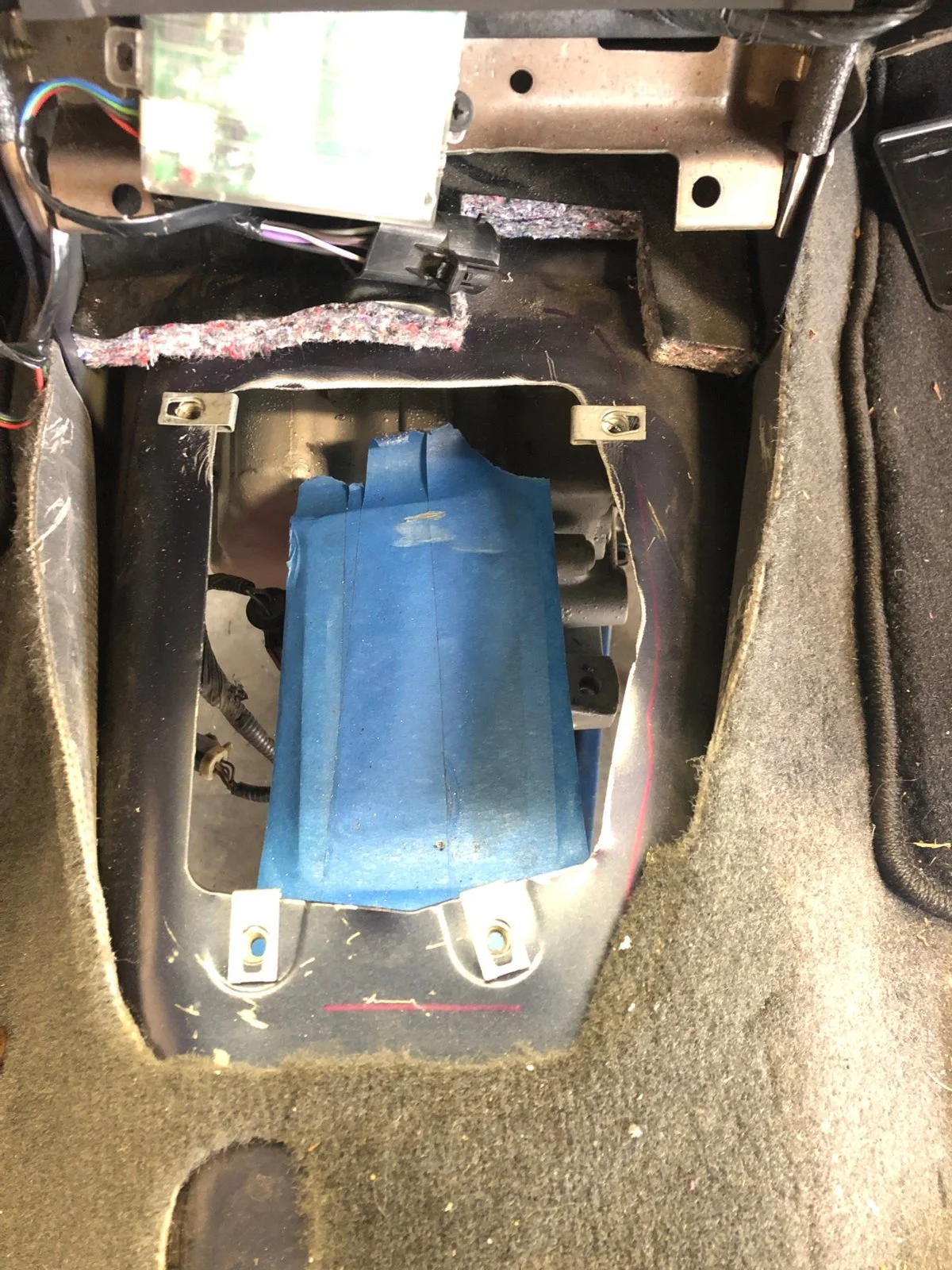

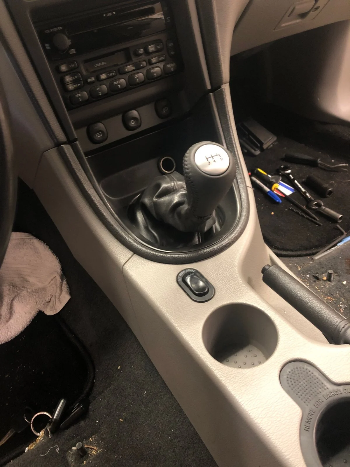

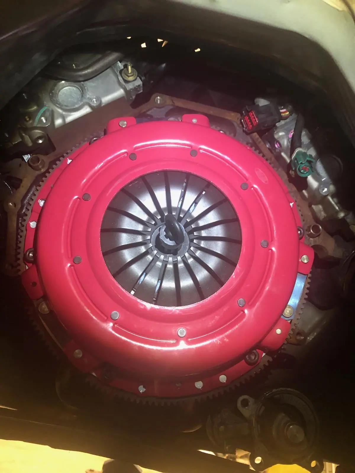

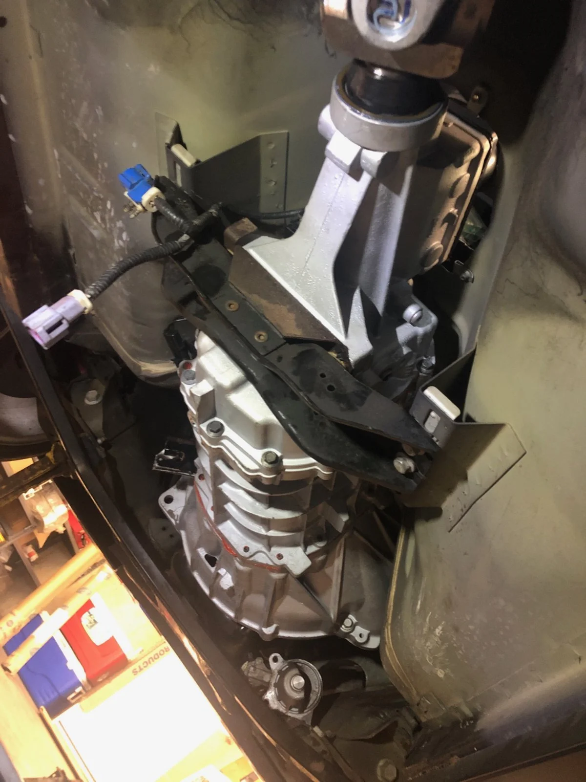

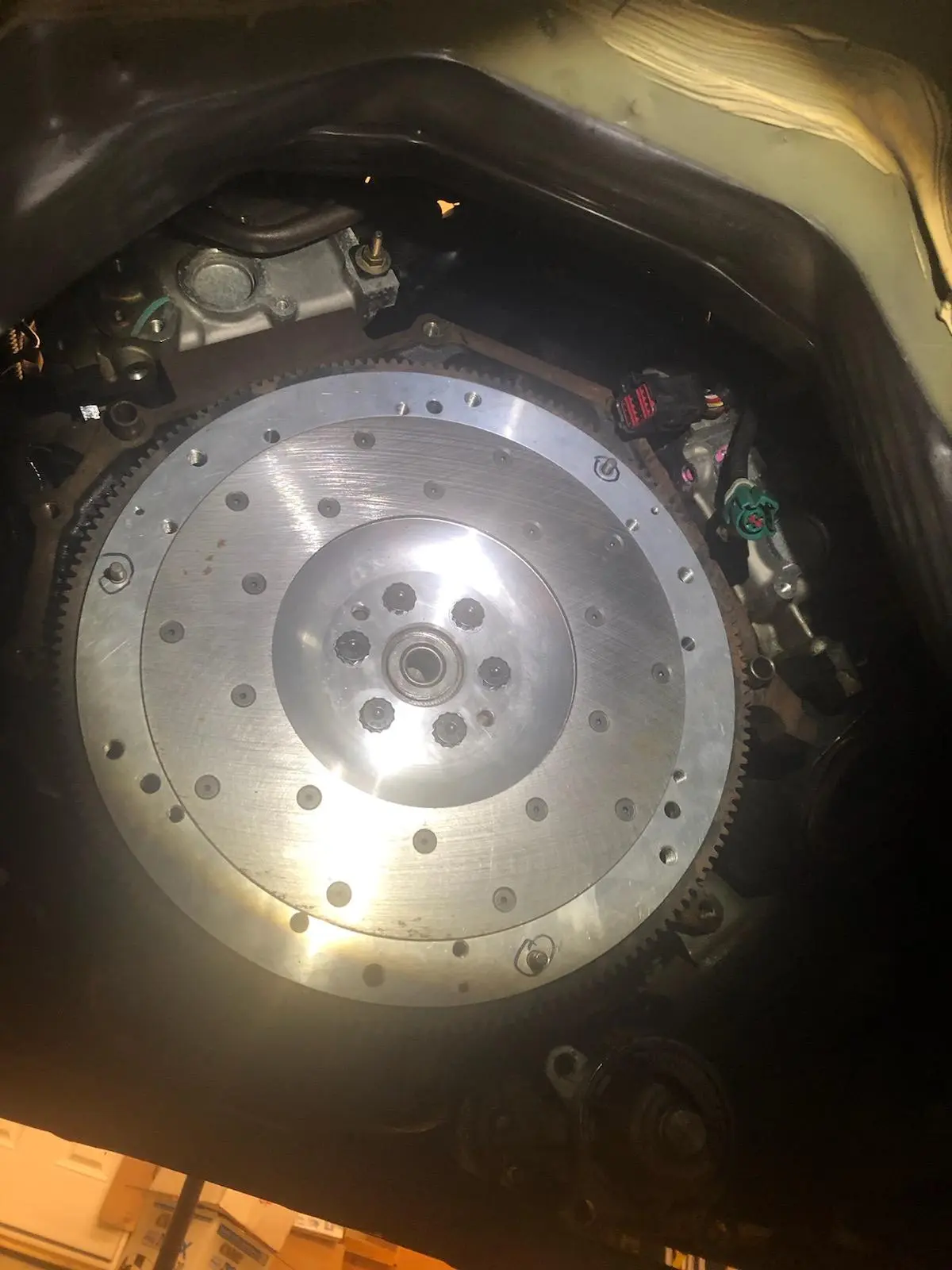

My friend Steve (excellent mechanic) has made a ton of progress on my car! The only real hiccup was that you need to change the cut-out in the floor pan for the T3650 to fit thru! We had read about this online, but it seemed hard to believe that the trans tunnel would be different. It is.
Tuning wise, Bama Performance (AM) emailed me a tune that should shut off the auto functions and keep the original PCM and PATS system functional.
Flywheel, clutch, trans, driveshaft, pedals are in. The neutral safety switch wire was indeed right there, with a jumper in it. Its working, as are the reverse lights. Now we need to put the interior back together and flash the new tune.

Car looks great. Seats are much lighter than stock... I'll try and get numbers.

Reinstalling seats (one shown in picture is just sitting in there)

Those seats look good. Can you provide a link for them to purchase. I plan on doing a rear seat delete and changing out my ss and ps seat to lose weight and make it sportier looking inside. This is exactly what i need. That's why I asked about the weight difference.
MUCH lighter. The stock power leather drivers seat is pretty damn heavy. I think both stock seats are about 100lbs. I'm guessing the new seats with manual tracks weigh about half that.
Dang! Well there goes another 800 dollars into my build. Those seats look good. I have the same color interior. I'll probably change out the door inserts to black ones to help match and get some black gt floor mats to go with it. The rear seat delete kits are also black.
