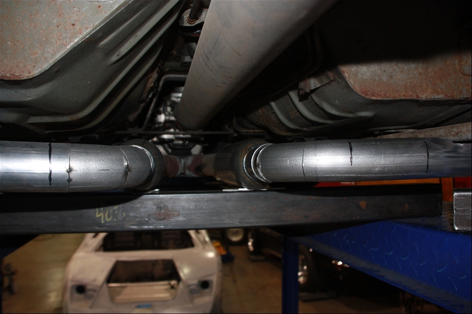

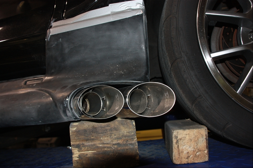

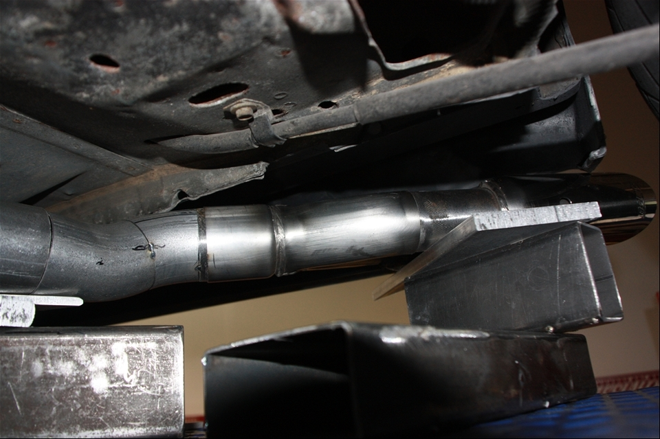

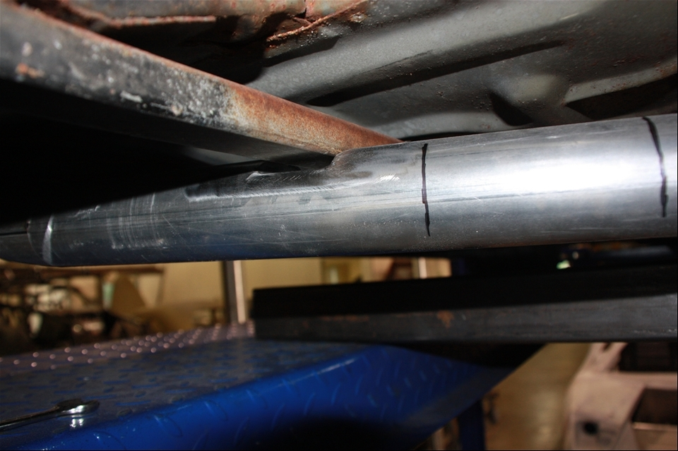

this is my setup i had built. BBK longtubes into a DR. gas O/R x-pipe that was cut down and dynamax race bullets added. from there it was notched for the subframe connectors and out to 2.5" borla slant cut dual intercooled tips. the tips i had cut and turned.
finished product
quick driveby video

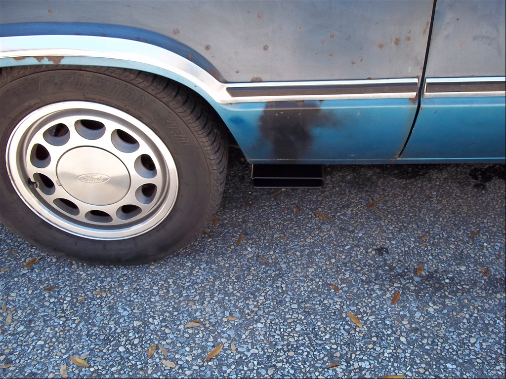

We had a set of 93-02 Z28 rectangular tips on side exhaust for a while on my oldest son's car.
Believe it or not, the exhaust sounded different between tips on vs just the round pipe. FWIW.
This was not on an SN... I don't know how they'd look on an SN.
The black is spray paint over some bare spots, the car is not perfect, he was 17 at the time.
I made fun of him over this pic, it looks like exhaust soot coming up from the tip. ;)

ProKiller, I must say your car is rather beautiful piece of machinery, I really like the how the side skirts wrap around the tips. Never would have thought about the Camaro style tips. Nice low profile look.
