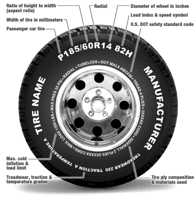

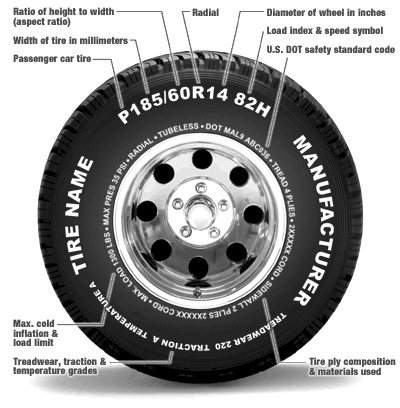

the 205 is the width and the 60 is the sidewall, or "aspect ratio" . the '60 is actually 60% of 205. thats how all that **** works. just an fyi. so youd be wanting to get a 215/50 or 55R15 for your car. but honestly, i'd go with something like a 225/50, they'd probably look great on phone dials.
Found a neato chart though....
