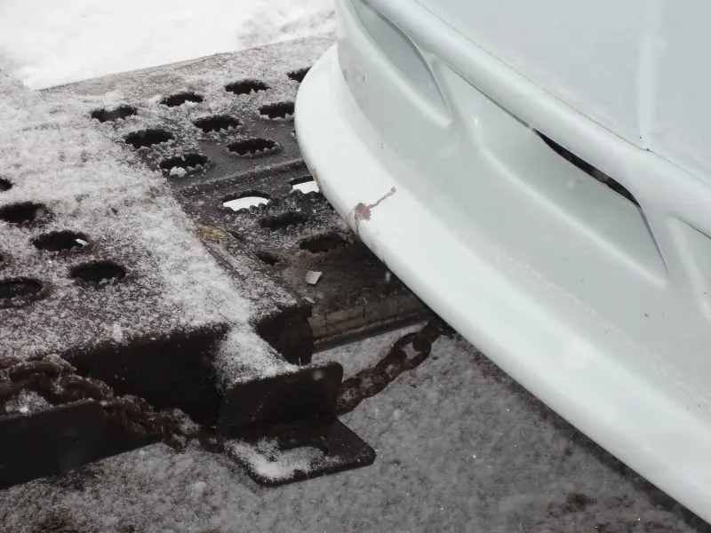

(PS, as I mentioned earlier, the car is being shipped from chicago right now. The trucker already damaged the front end so I have no idea what I'm going to do with a new skirt/ body kit. Doesn't look good from the pics)

I'd be making the shipping company replace the bumper.
oh they are, and then some. Insurance is payin out nicely because the splitter I have on there is bonded to the front bumper. It needs to be replaced. So that means the front bumper does to. Their insurance co is writing a check off of their own appraisel for $1900

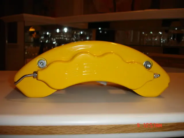

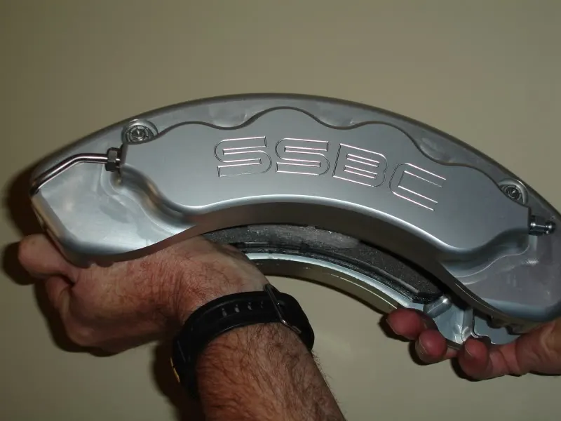

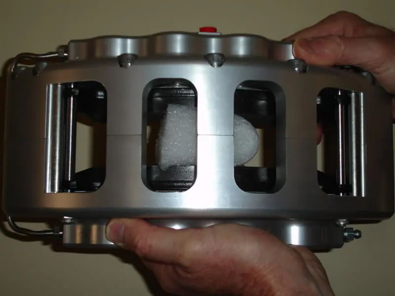

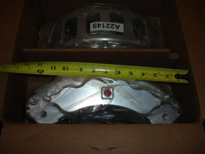

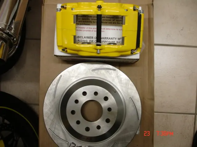

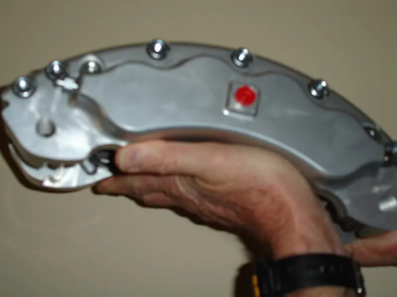

I HATE how long these custom projects take. The SSBC calipers just came to my house from SSBC. They had a delay because of one thing or another. So I took some pics for you guys. I just shipped them out to the shop doing the work. The hats will be re drilled for the stang and a custom bracket will be made. Also the calipers (and the rear wilwoods, superlite foged) are going to be powdercoated ferrari yellow. I'm probably 3-4 weeks away from getting them on the car. No matter though. The car is at a shop right now having a full sallen s281 kit installed, and xenon hood scoop (a little more aggresive than stock). I will be having a custom fat stripe painted on the hood and front lower portion of the bumper very very similair to the stang in the upper right corner of mossymuscle.com homepage. Enjoy the pics
You will be leaving everybody in the dust.. your brake dust :p Those things are going to be killer. I bet the only thing behind the wheel will be rotor and caliper.
are you still powdercoating the calipers yellow? Its gonna turn out sick!
ferrari yellow is the exact color being used.... :nice:

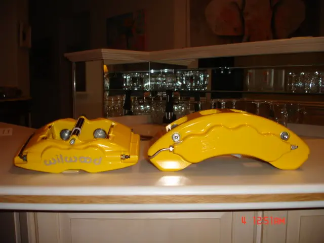

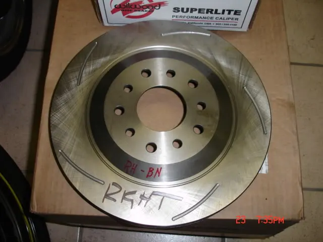

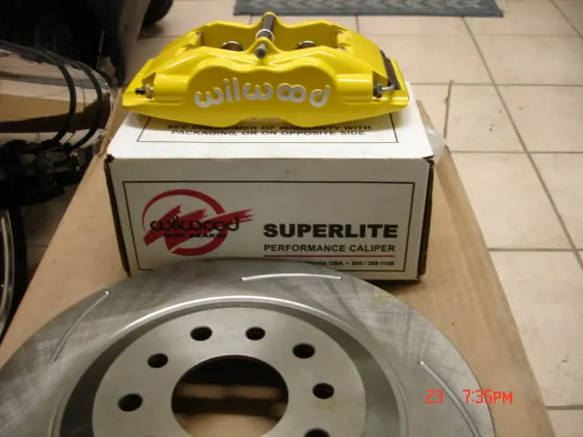

Rear brakes finally arrived at my home. Fronts will be in middle of next week. However car will be back in the body shop monday morning for what i hope will only be a week. So install will have to wait till she gets back out.
Here's some pics.

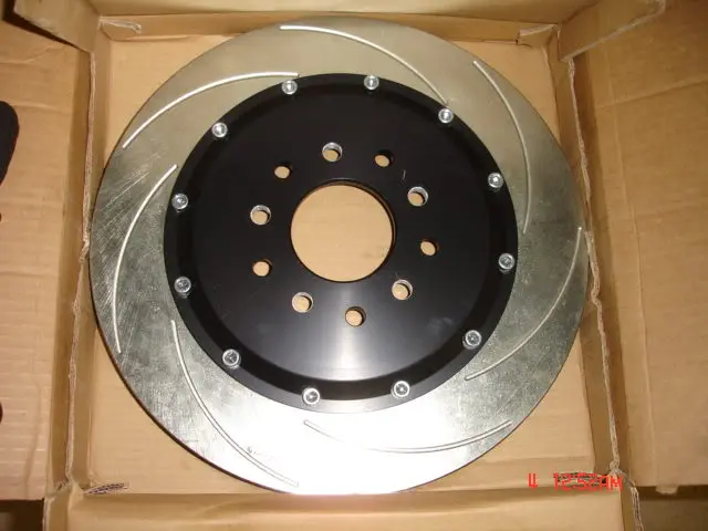

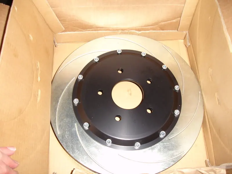

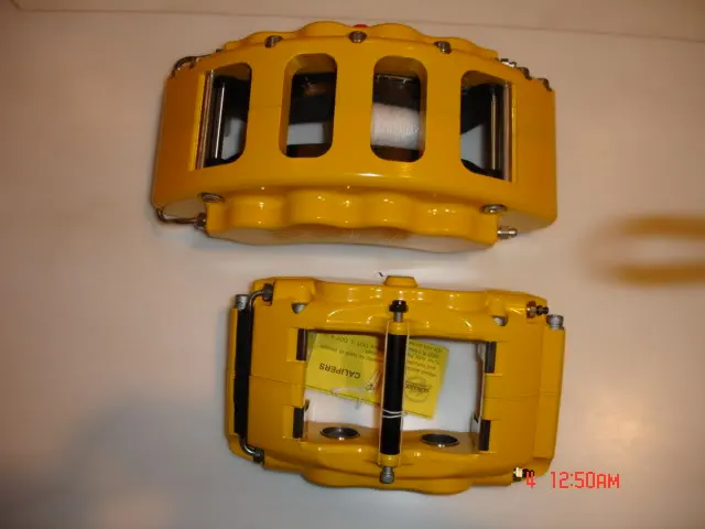

Front Calipers and Rotors are in. The look enormous. When the wilwoods came in I thought they were huge......they look absolute tiny now. Here are some various pics. I will probably have the brakes on by the end of the weekend if things go ok. I'll update with pics as I go.
Good lord I would take those willwoods in the front of my car, let alone the front SSBC's! Care to share how much this setup is going to cost in the end?
