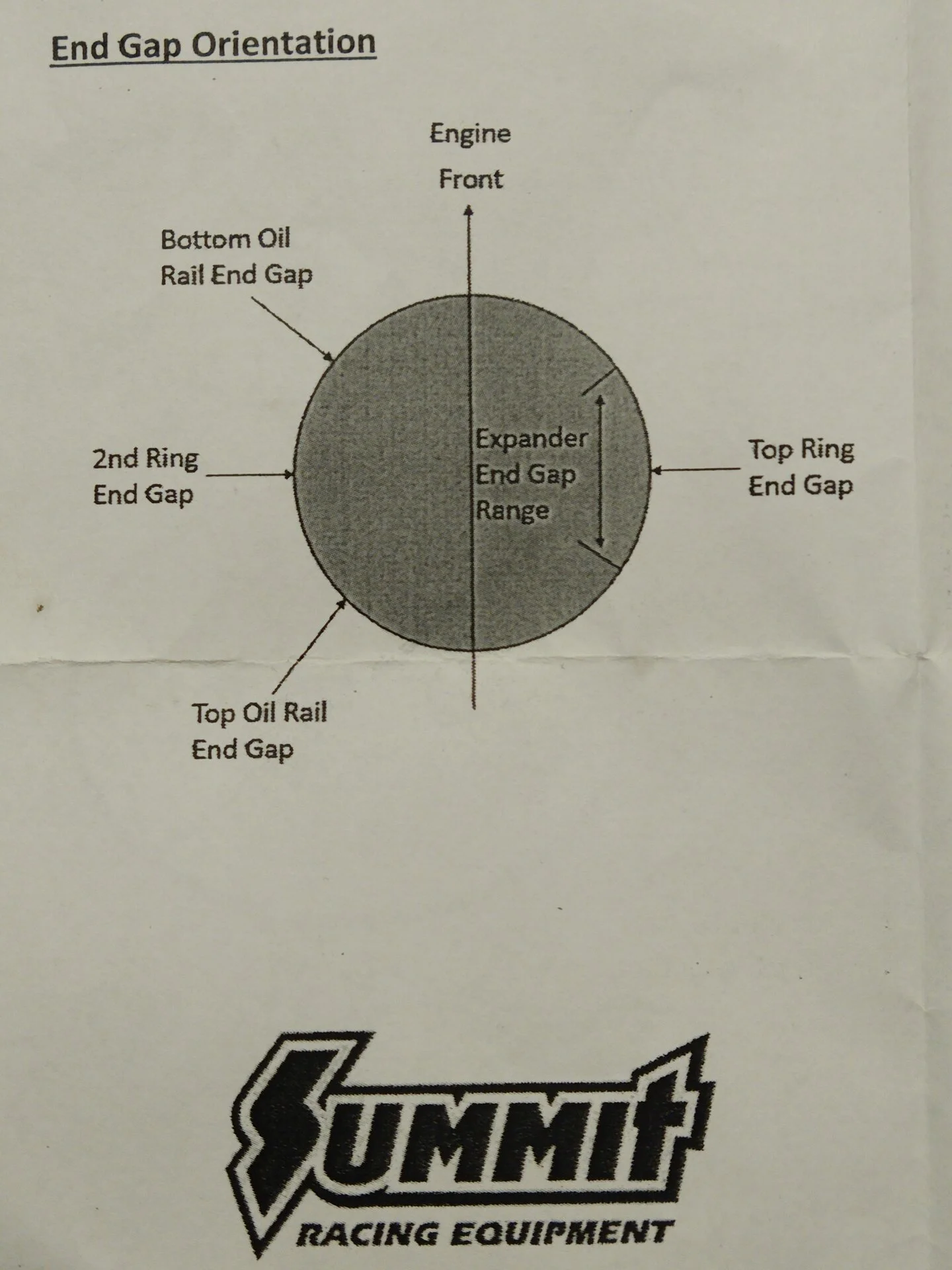

These are the instructions for some Summit brand rings...I have ones for Manley and Sealed Power too but cant find them ATM but if anyone has ones to add just to show the differences..
I was told by an oldtimer who worked for Ford from the late 60's through the early 90's said that aslong as the rings arent initially set wrong on the pistons and get broken-in right everything will work out as rings spin at different rates and ring gaps match up then unmatch until a bore gets so worn down the rings stop spinning on the pistons and if that happens the ring gaps get stuck in bad positions and engines develop blow-by and is hard to get rid of ...
For engines with some substantial mileage that all of a sudden develops blow-by he was a big fan of borax and the italian tune-up method to try to get the rings to forceably spin one last time and hopefully reclock themselves so the gaps arent inline plus said the attempt was 60% successful with 20% in engine failures aswell as a 20% in no change at all when performed on 18 engines..
Another thing that I forgot to ask is was your engine honed with a torque plate? Its essential to hone with torque plates especially with cast aluminum engine blocks........
Good Luck with getting a quick n easy solution to your problem but I have a feeling you may be rehoning the cylinders and replacing rings..........
