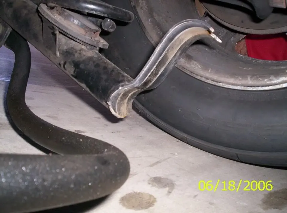

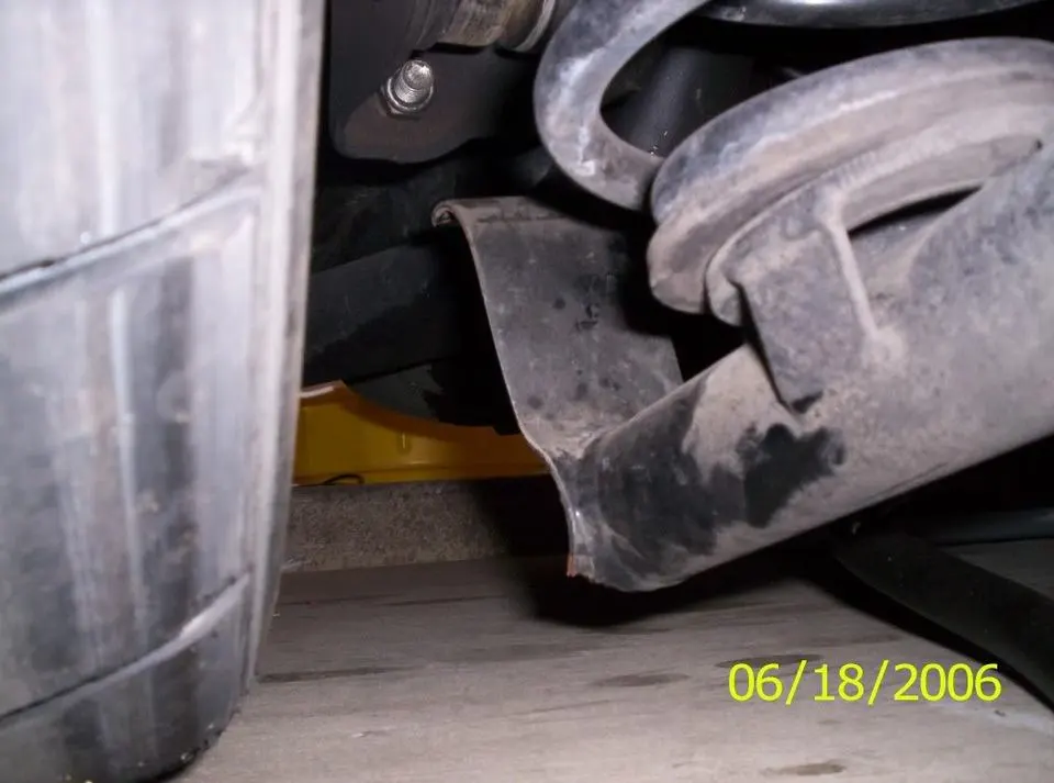

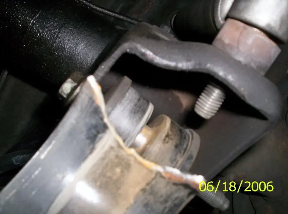

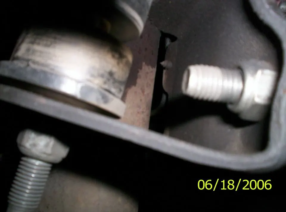

i was cruising on the 101 with everyone heading ona cruise up north with about 15 cars and i was in the middle lane between 2 other stangs within the cruis and the camera was tapin so i decided to show the camera a lil something..turned the n20 on then down shifted from 5th to 3rd at about 65 mph tires broke lose for a second then when they grabbed the control arm ripped right out and the right rear of the car slammed down and rested on the tire!!.....right rear tire locked up.....dont ask me how but i kept it in control and managed not hit anyone even though i was an inch from slamming into cars in both lanes next to me....sparks flying everywhere and everything...looked like some **** u see in movies...but no body damage or anything matter fact i am goin to look at it now and take some pics....ill be posting them soon.....

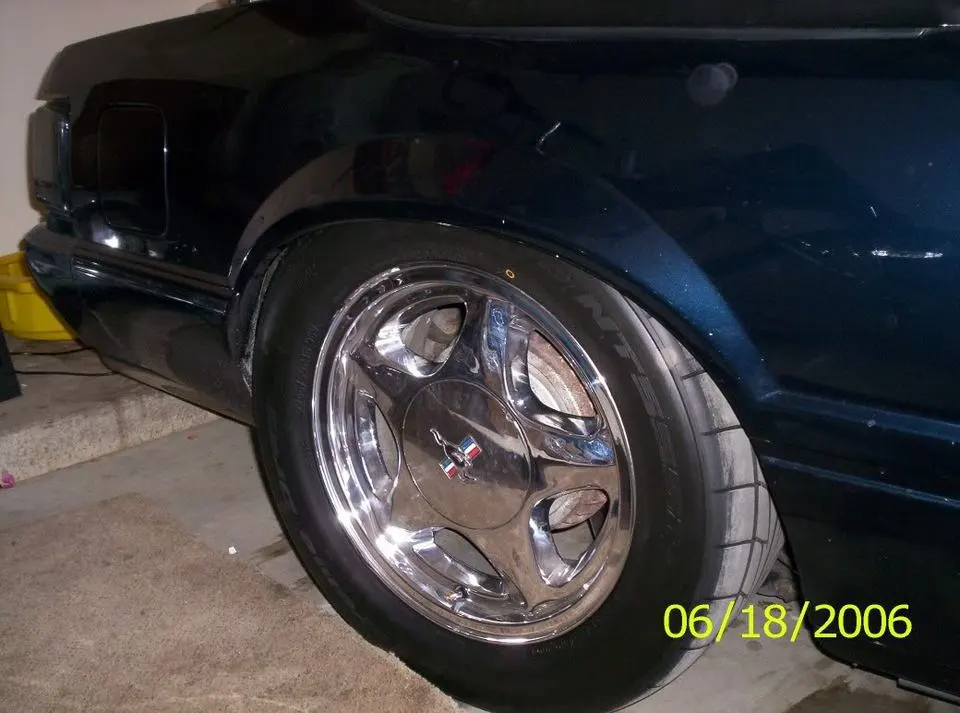

heres some pics

they were d&d guys.... for your concern i was fine the car as well....if i was goin justa lil faster like 75 or 80.....i think it would have been much worse....it was unreal how hard it was to steer and control that thing when it happened....also my tires only cleared the fender lip by like 1/16 of an inch any wider of a tire and i for sure would have a had a serious blowout as well...i think I know will be rolling the fenders a little bit as soon as i can.....im really pissed a d&d though...those ca's are only about 1 year old and i thought that if i was to damage them somehow it would be with slicks on launch.....not a 65 mph roll with nittos.....guess the 455 rwtq can get pretty nasty with the chassis
