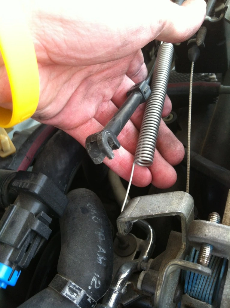

Wmburns I checked my throttle cables I found the one that is on top, and found a black plastic one that is on the bottom that hooks to the butterfly, but when I did so, it made the butterfly open up extremely almost open throttle.. What Can I do?

The spring is return spring #1, check where the butterfly shaft goes through the throttle body. There should be one on the side coiled around the butterfly shaft. The thing with the black clip is the cruise control cable. That shouldn't have any effect, but you can leave it disconnected and see if that helps the problem.

I just looked back at the picture, and return spring #2 is in the picture. It is the blue spring right below the throttle set screw.
