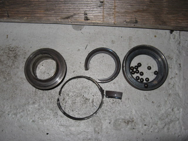

Two carnage photos. My squeal was definitely the throwout bearing. First here is the t/o bearing still on the fork. Looks a bit bad, eh?
I tried to get the t/o bearing off the fork, and it literally came apart in my hands! Ball bearings everywhere. Next photo is of all the pieces, plus the ball bearings I could find.
Slept late today, so I only got up to removing the bellhousing. The clutch itself is tomorrow.
Just got the clutch and flywheel off. The previous owners said it was a new clutch - new clutch my @$$! One rivet had a bit of a shine on it, the rest were almost there. The fingers on the pressure plate are all galled up too, as I expected. Also, my rear main seal WAS leaking - couldn't really tell until the flywheel was off. Looks like I'll be using all of my "just in case" parts I bought. :D
