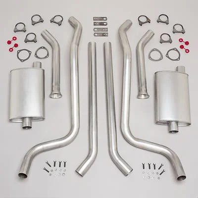

http://store.summitracing.com/partd...922451+4294908331+4294925084+115&autoview=sku
and have your buddy do the install, or do it your self and spend the savings on booze and chicks!
