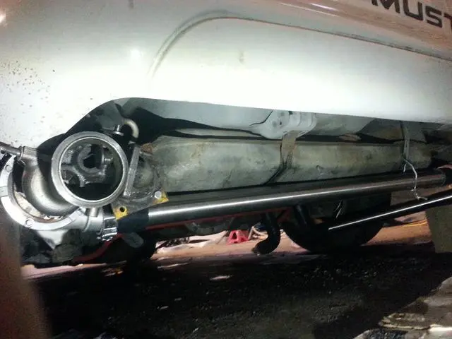

Just thought i would update:
My car is actually "slower" because it spins the tires way too easily LOL.
4.56gears and stock street tires = not a good combination.
I'm still adding a turbo for the top-end though. :)
