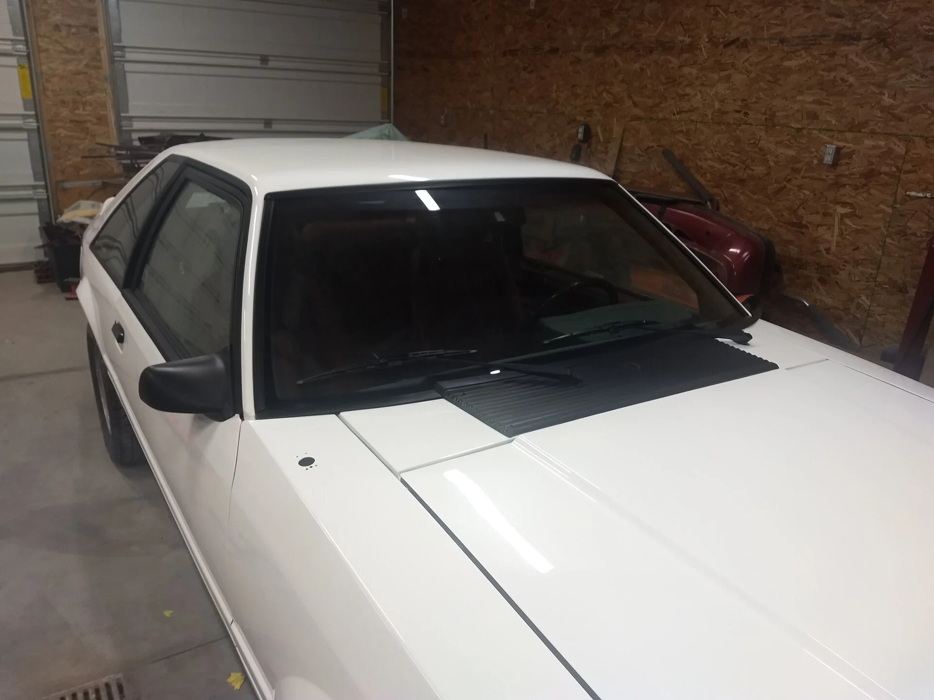

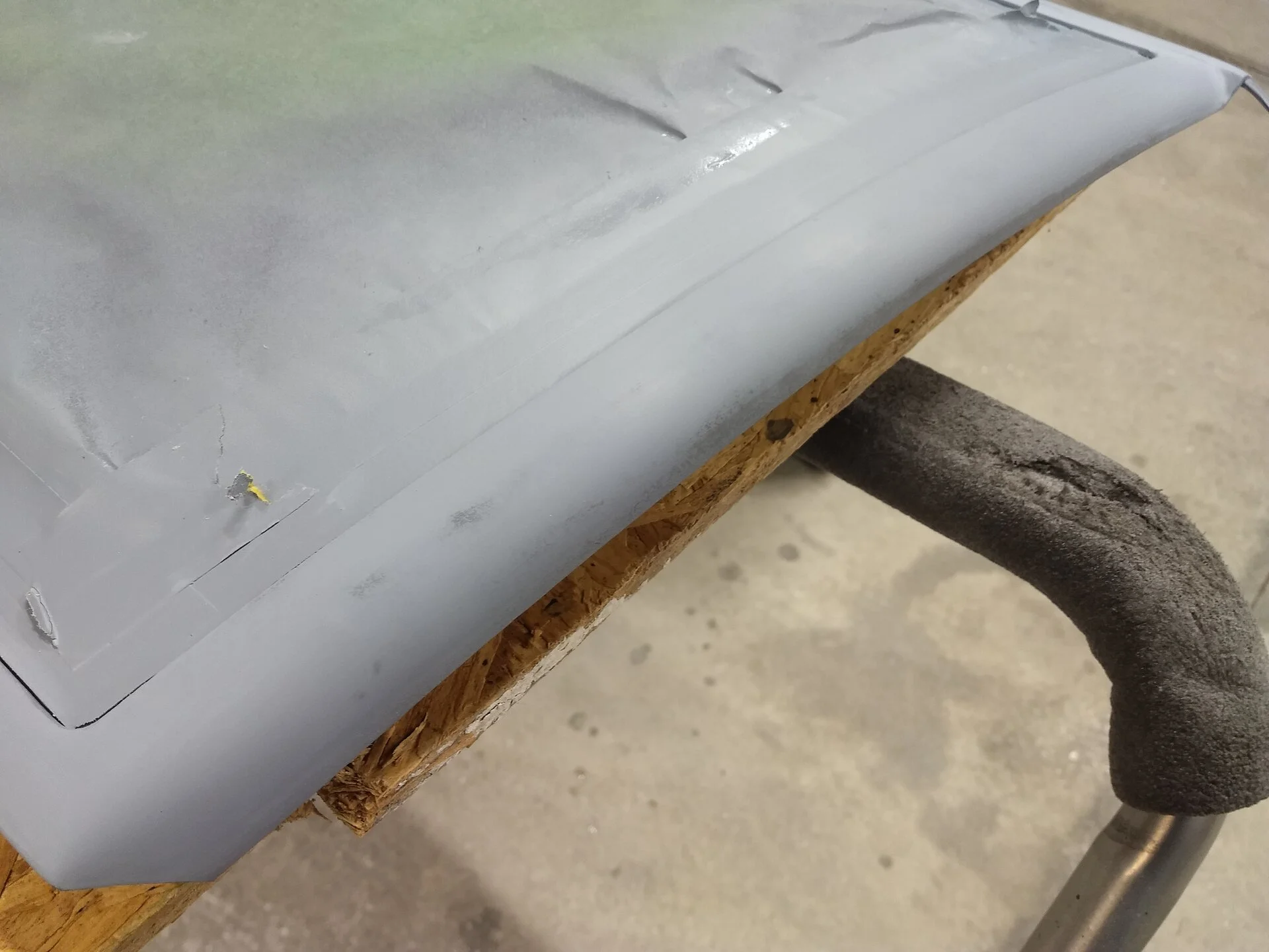

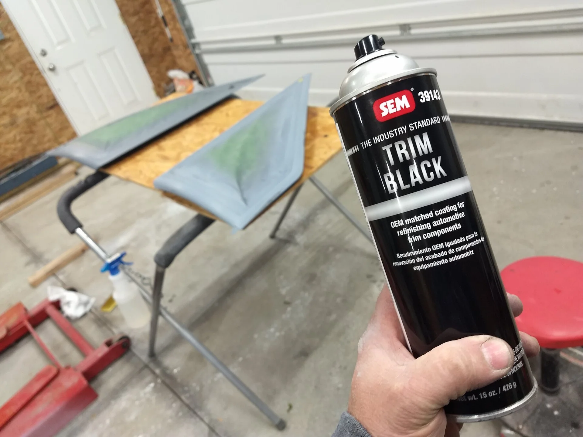

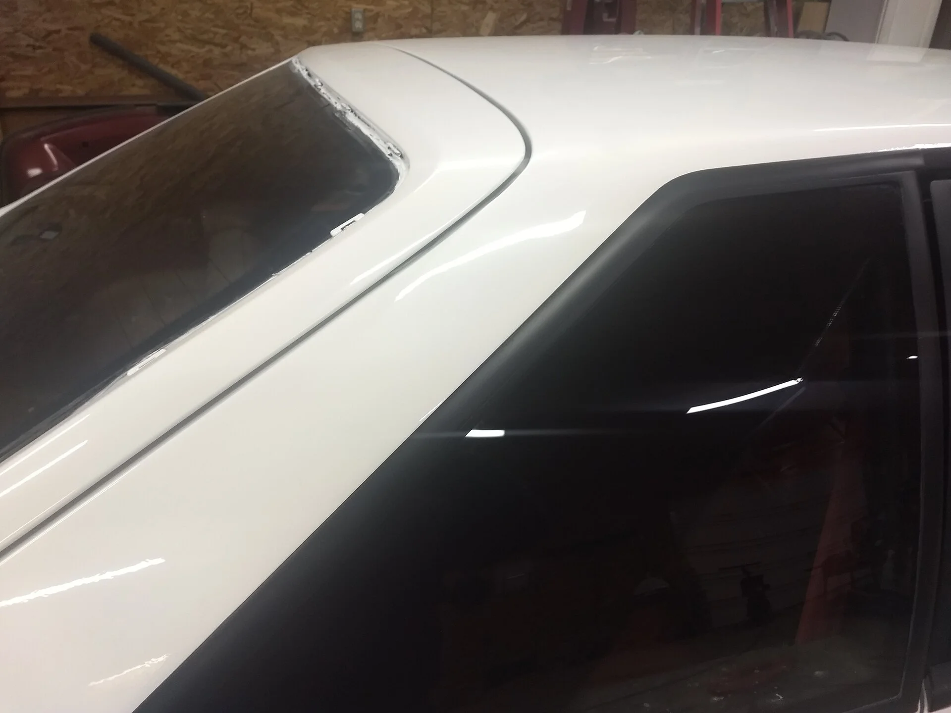

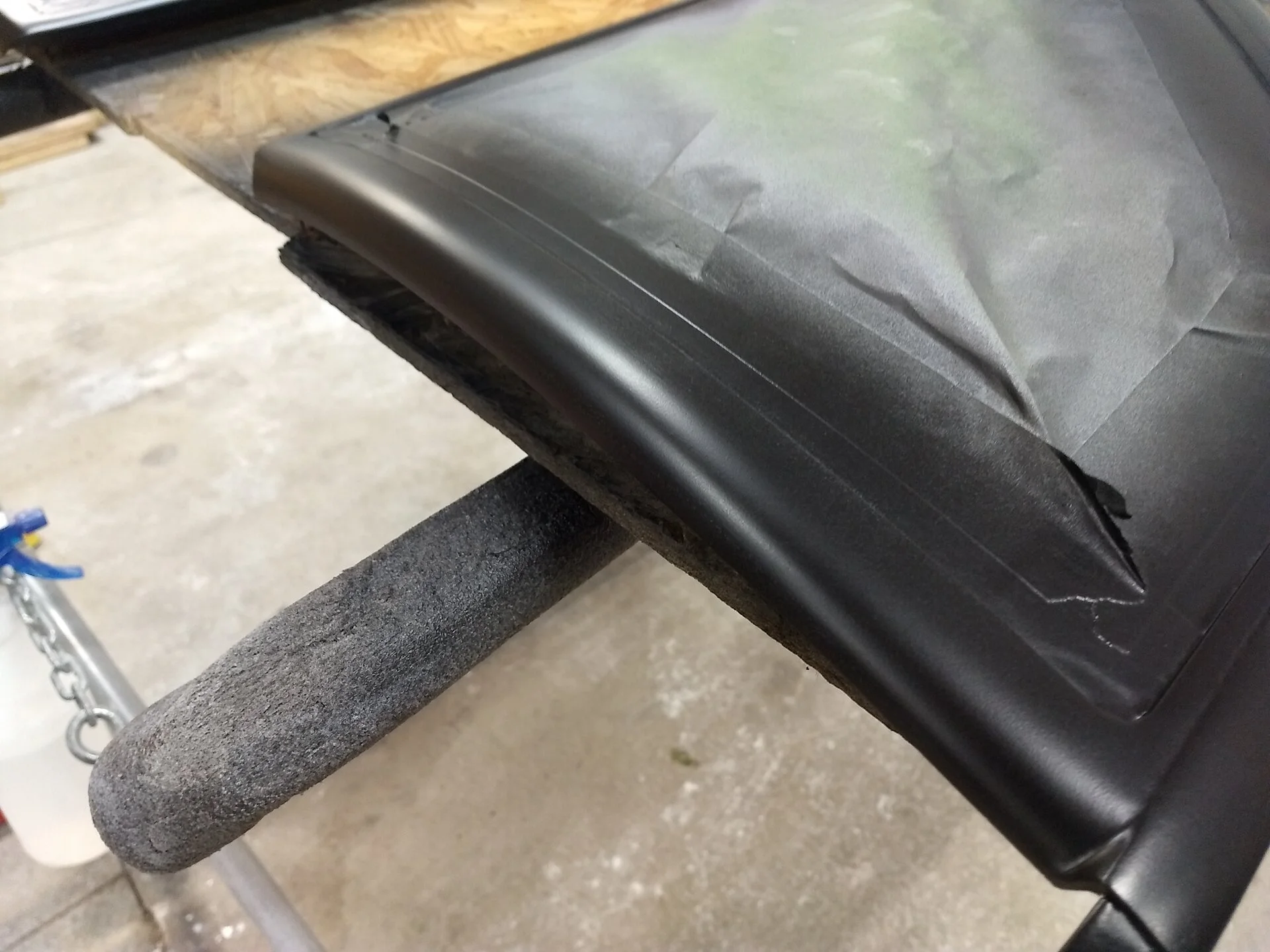

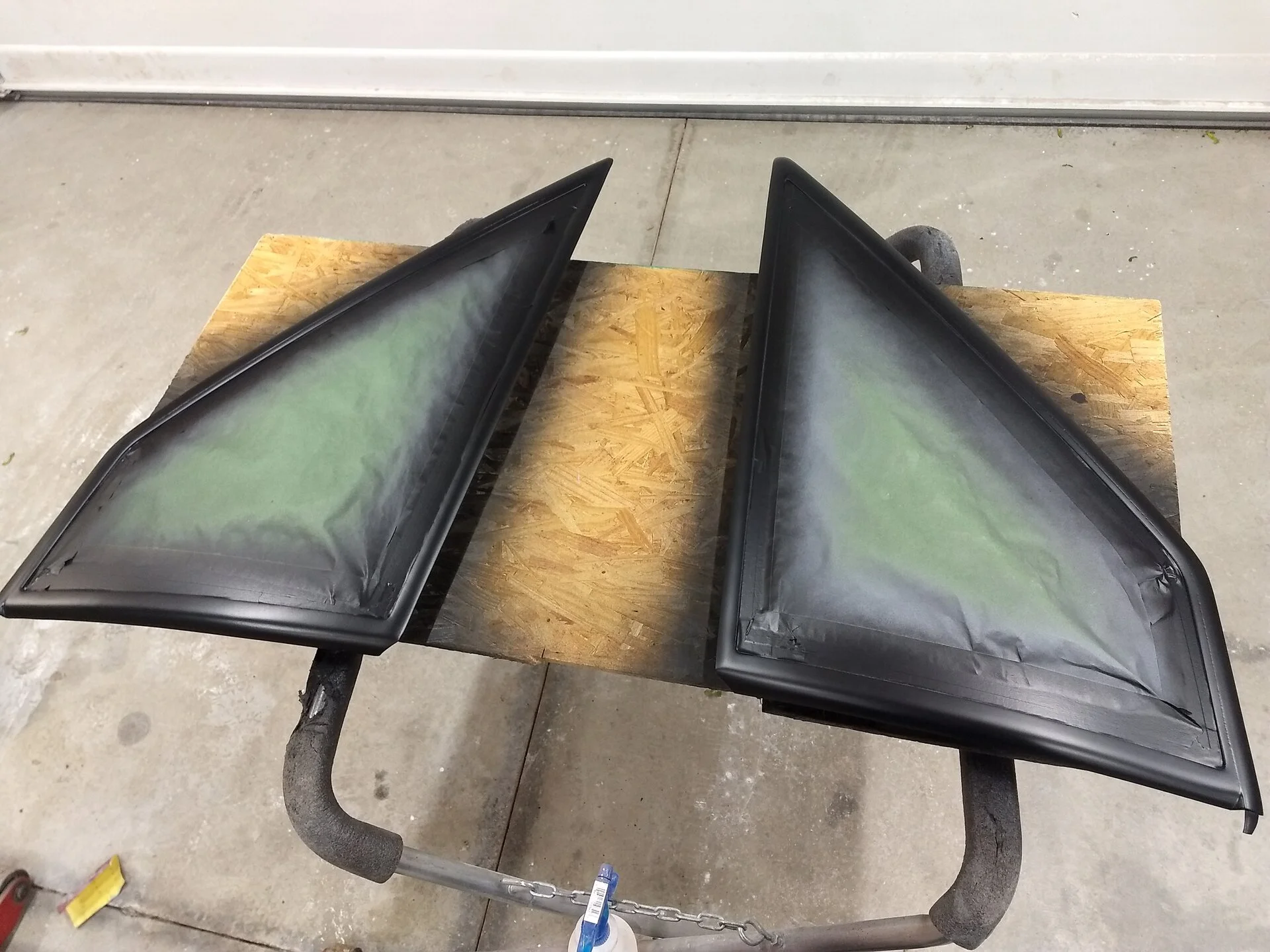

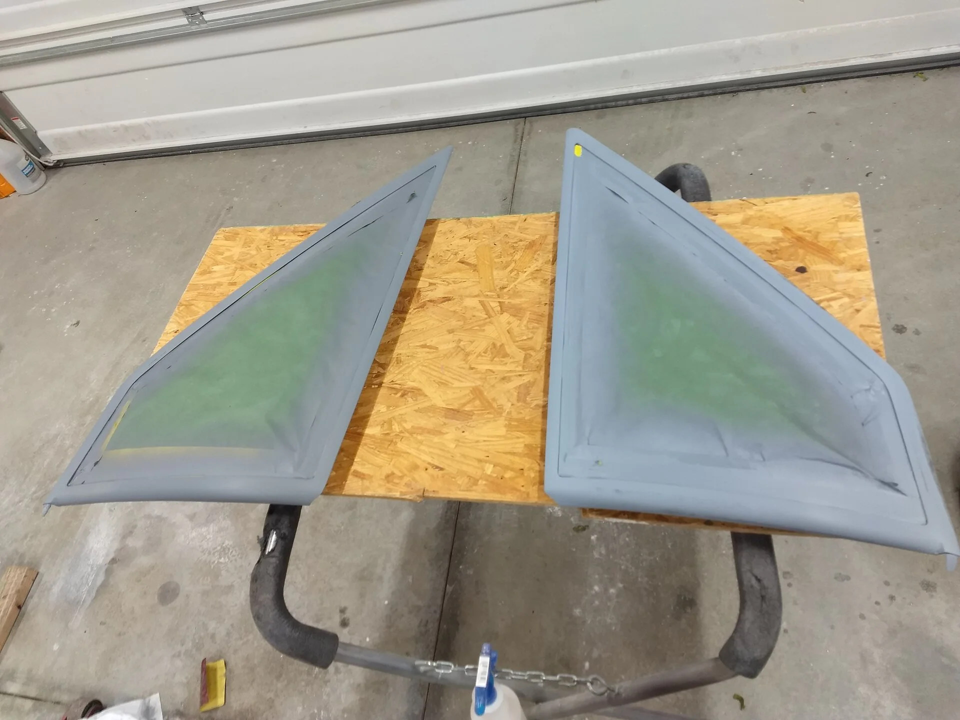

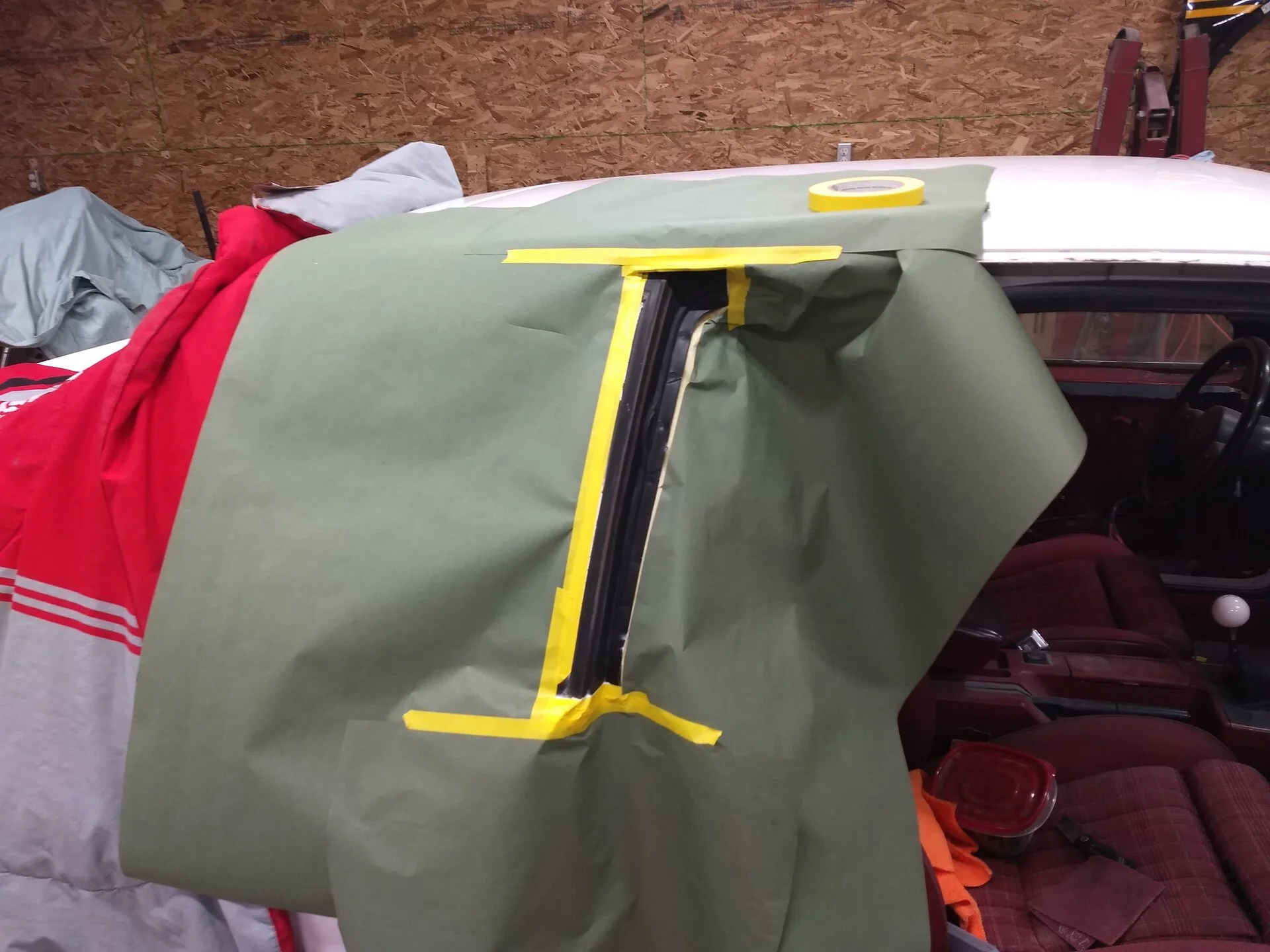

Ok, time for an update and a big picture dump.
Got the quarter windows done, I primed them, I sanded them with 180, primed again, then sanded with 400 and painted. I'm using Sem trim black on all the trim.
More coming, 5 pic limit.

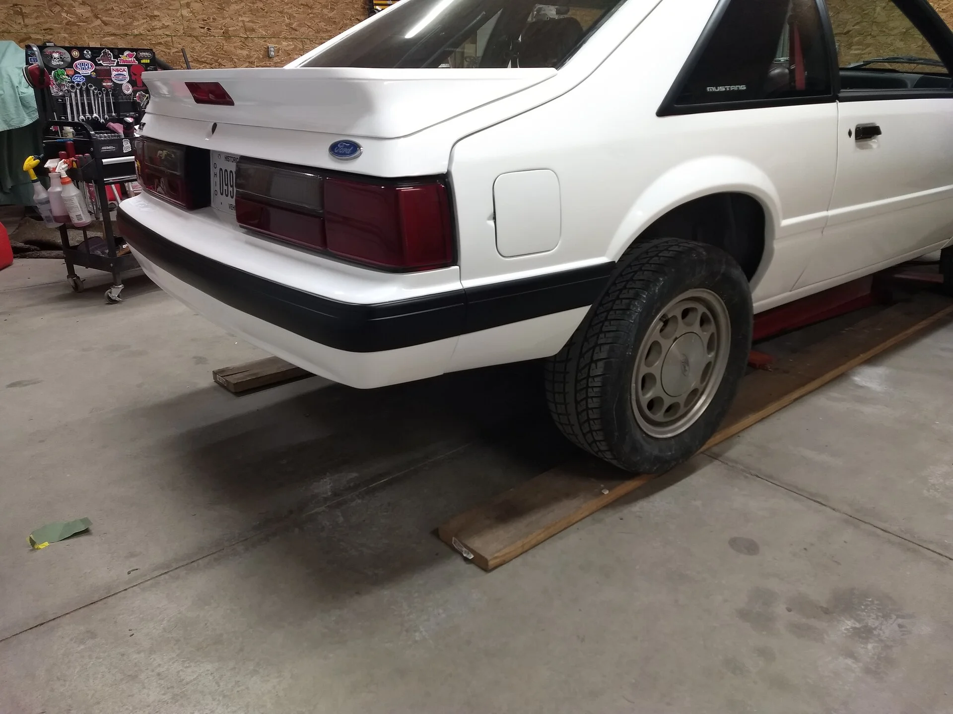

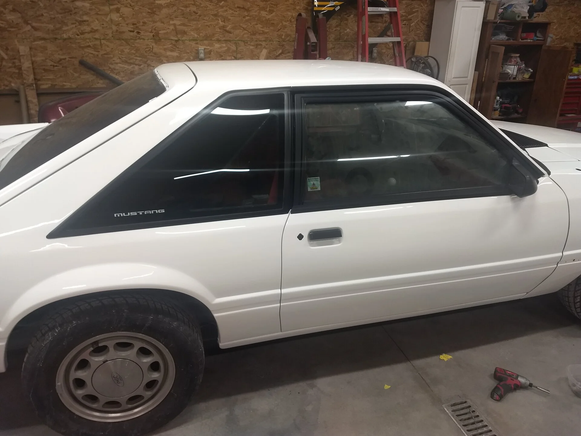

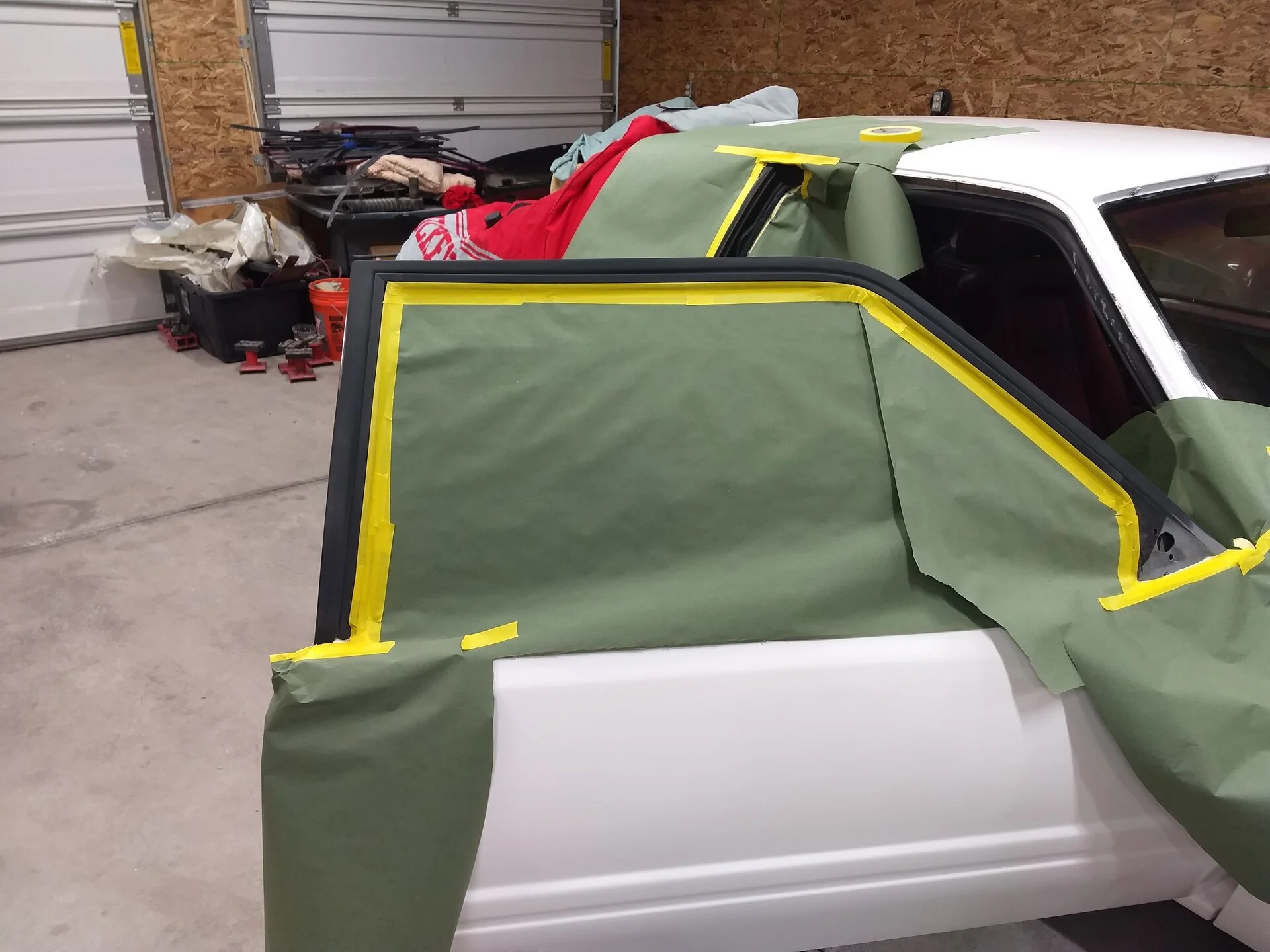

The following pics are of reassembly, every piece of trim had been cleaned, sanded and painted, except the belt moldings, those are the Daniel Carpenter reproductions. They fit pretty good, I'm happy with them.
Reactions: 67coupe, RaggedGT, BlakeusMaximus and 6 others

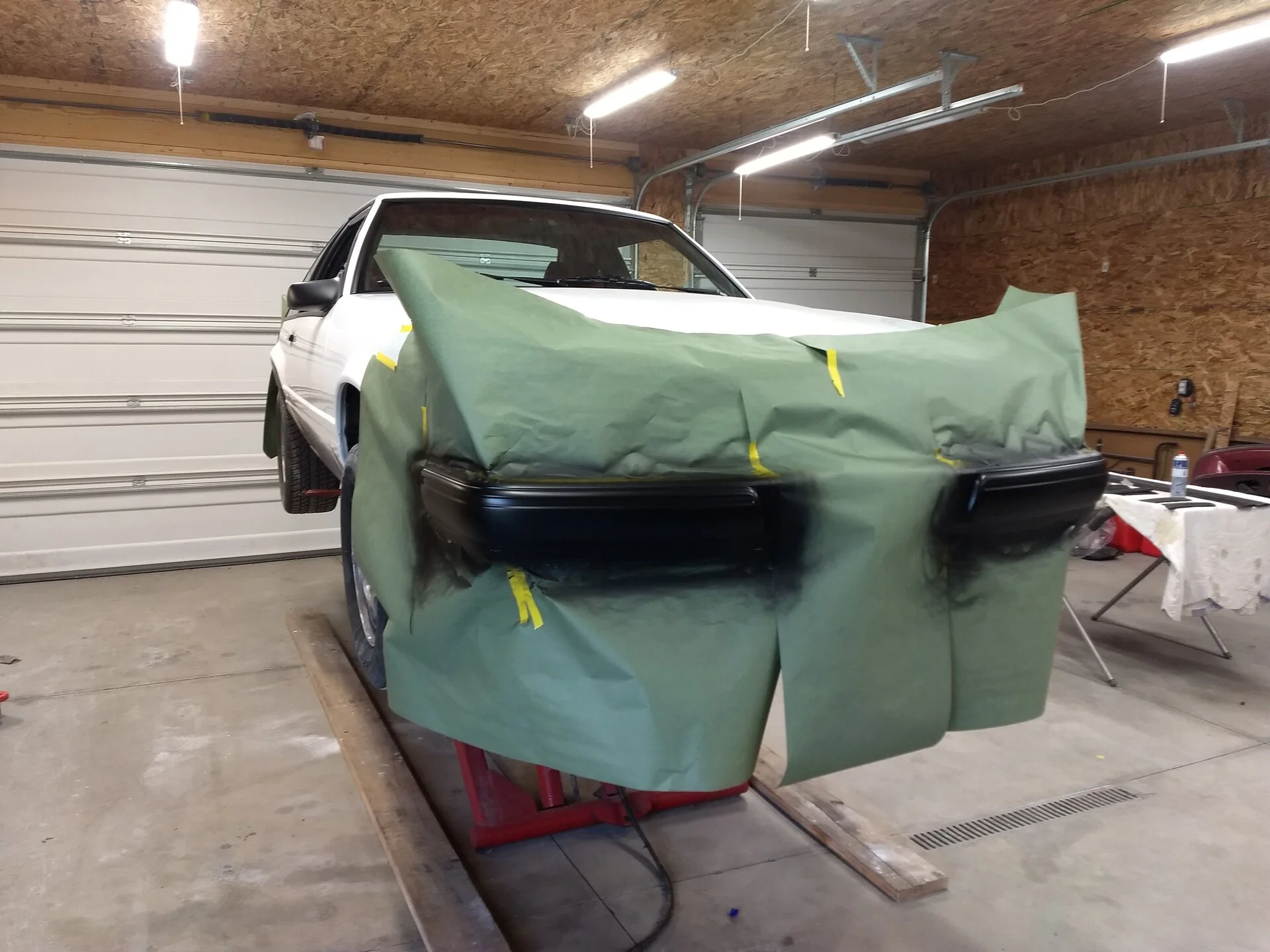

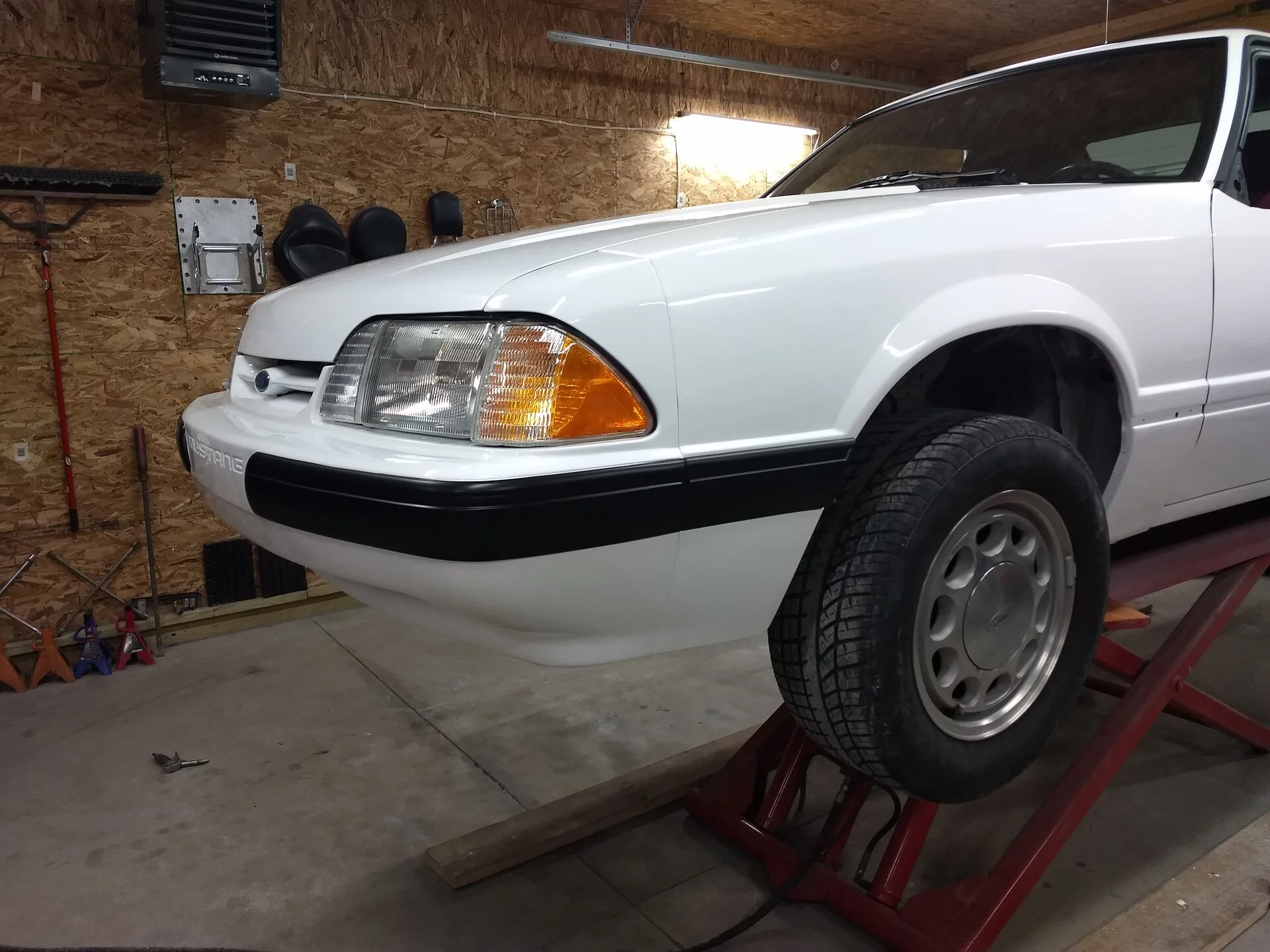

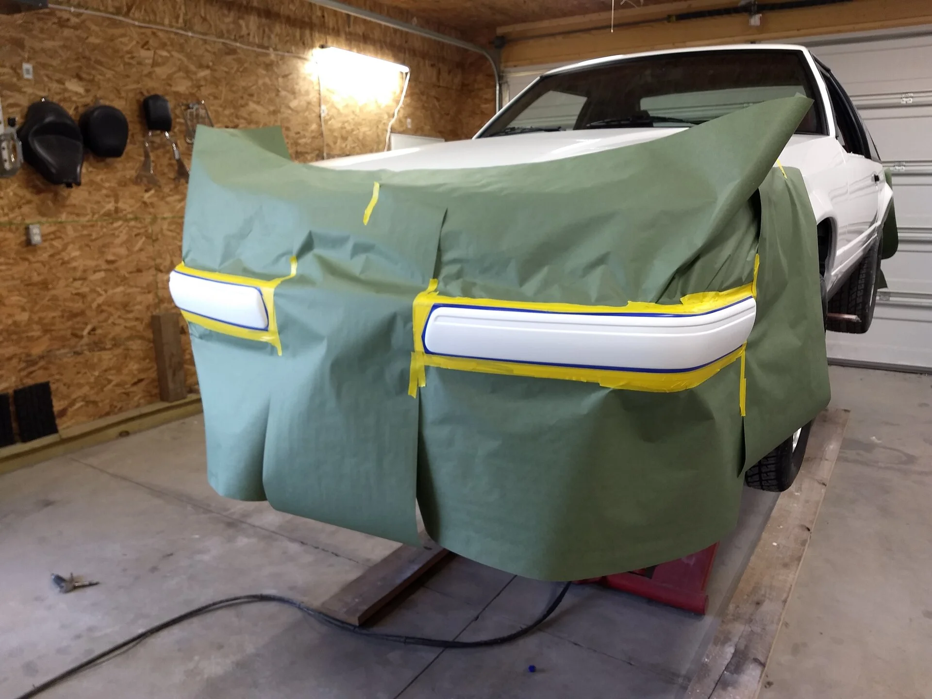

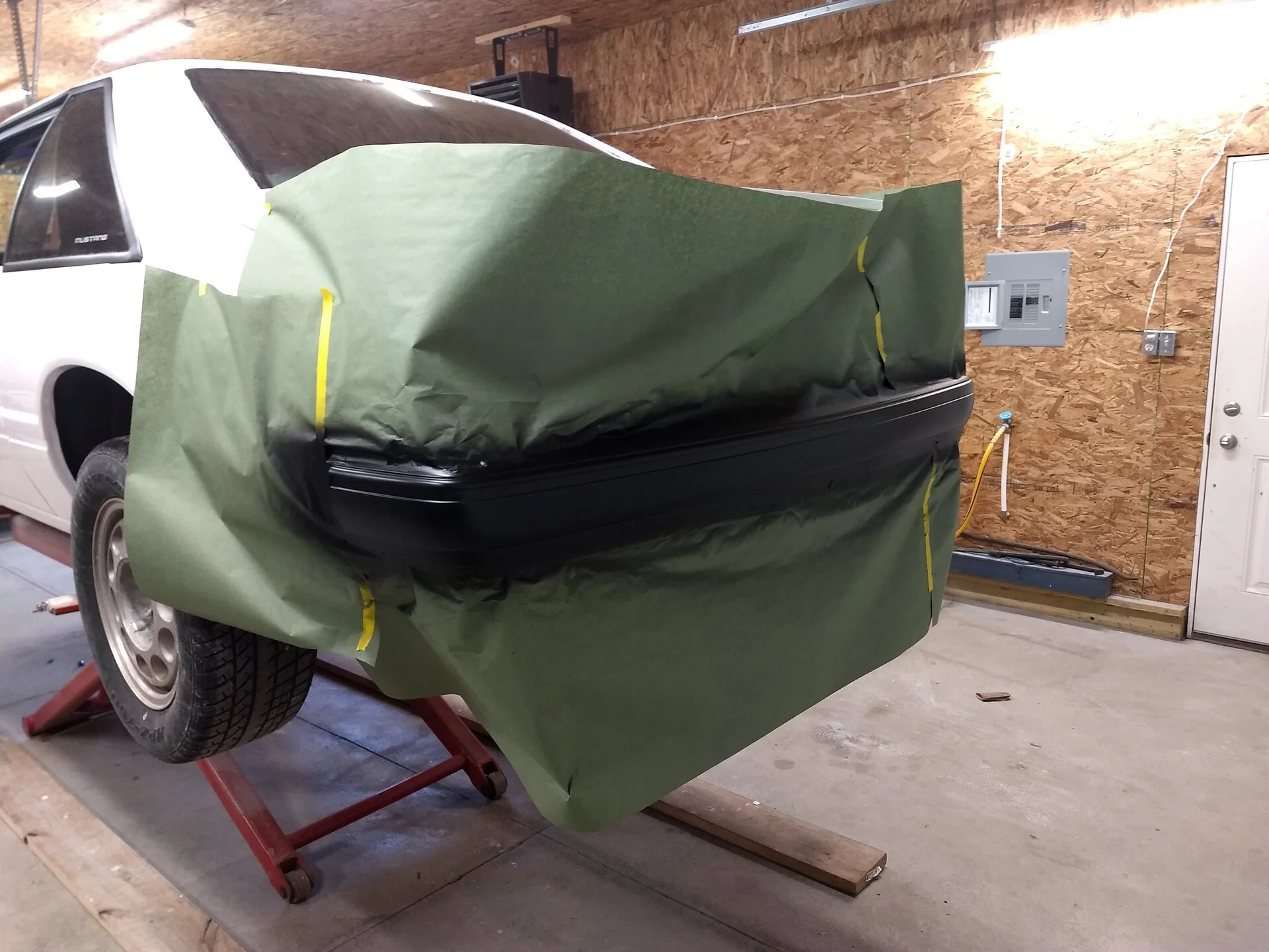

This brings us up to date, tonight I masked off the bumper moldings, scuffed with a red scotchbrite, and painted, then installed the fender and quarter moldings that meet the bumpers. I still have to do the other body side moldings, I have removed the metal strips, and retaped them, they just need painted and installed. Also need to repair the power locks and finish the doors. I ordered a set of generic lock actuators that should be here tomorrow.
In this pic you can see the wheel I cleaned, and polished a little spot on just to see how they will look.
I've put way more work into this thing than I wanted to, it's not perfect by a long shot, but it's coming out pretty good. I backed it out of the garage in the sun today and it hurts you're eyes to look at it because it's so bright.

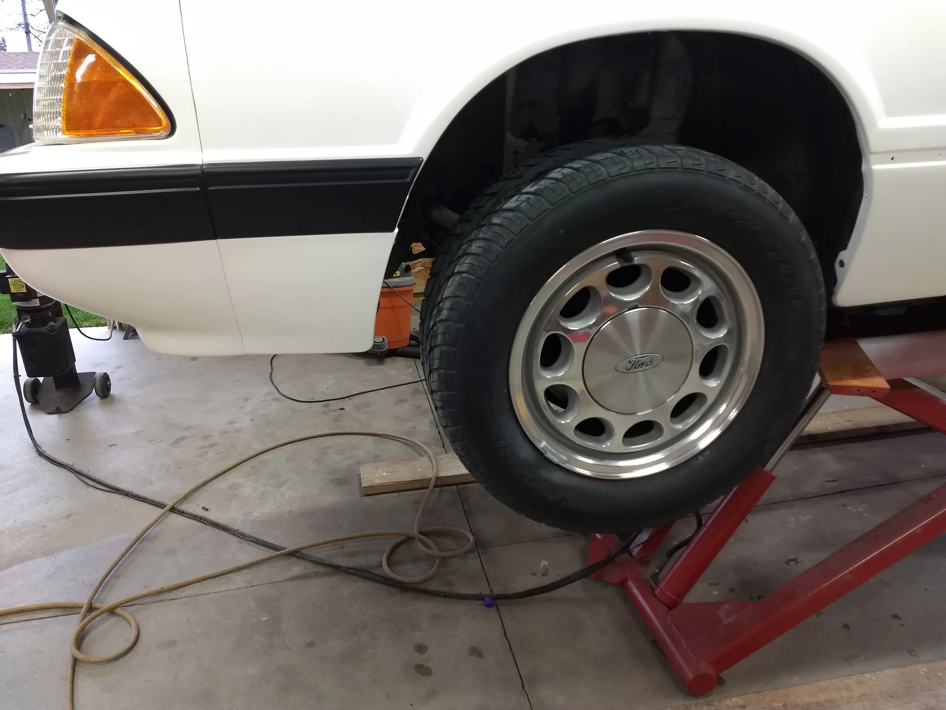

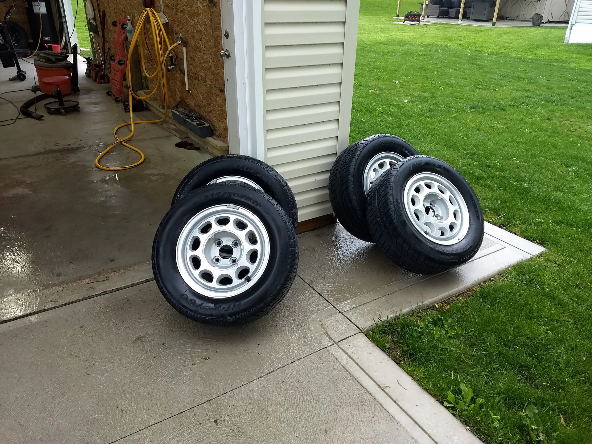

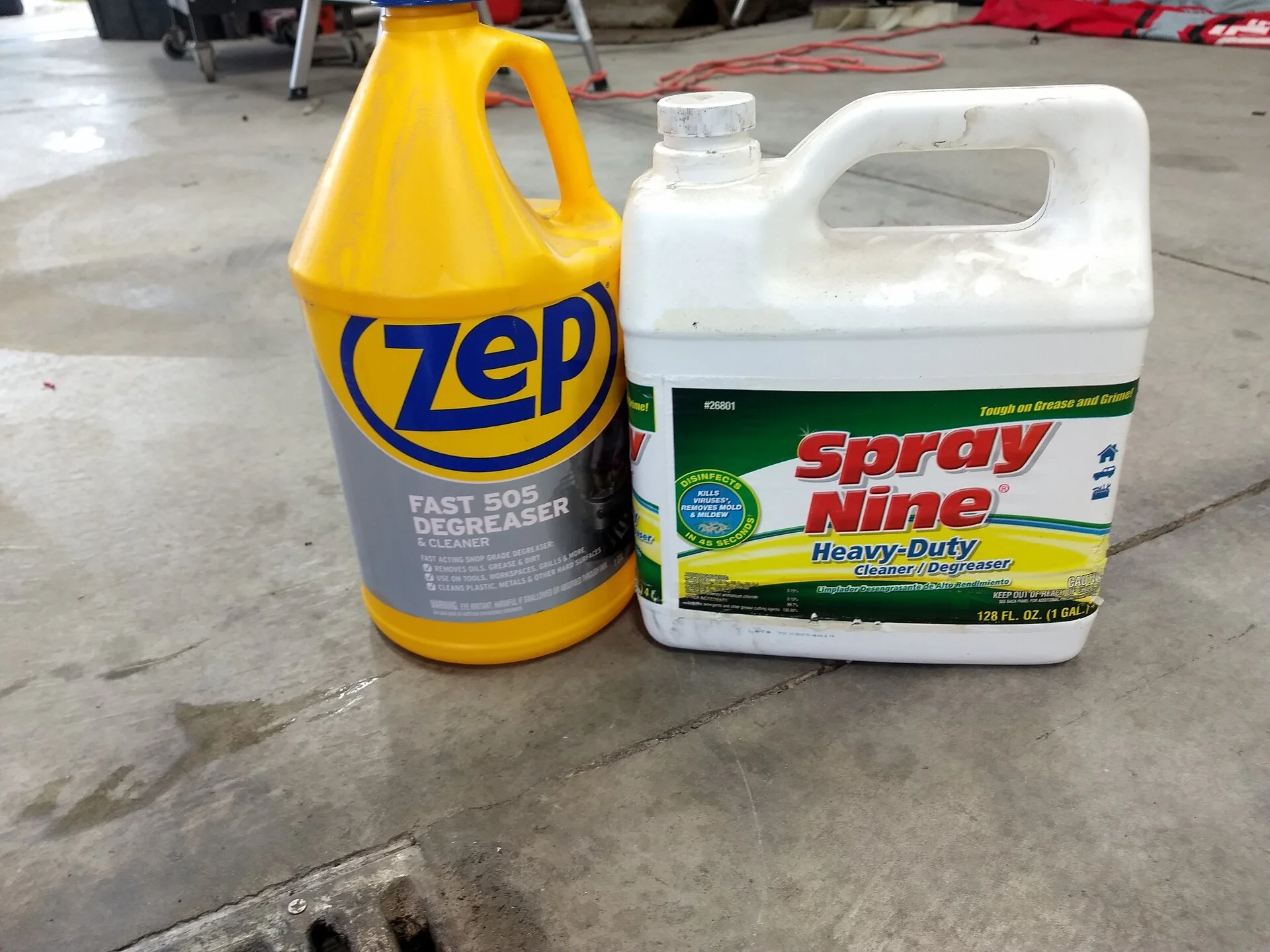

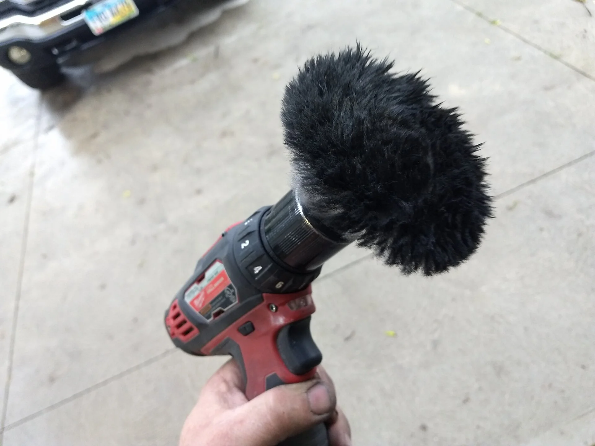

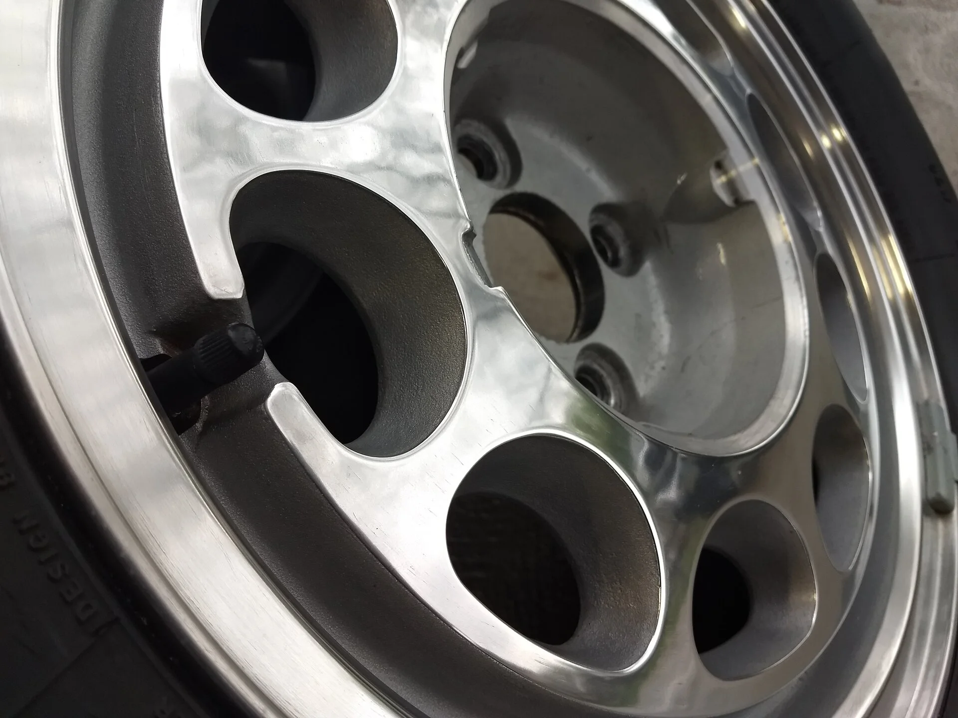

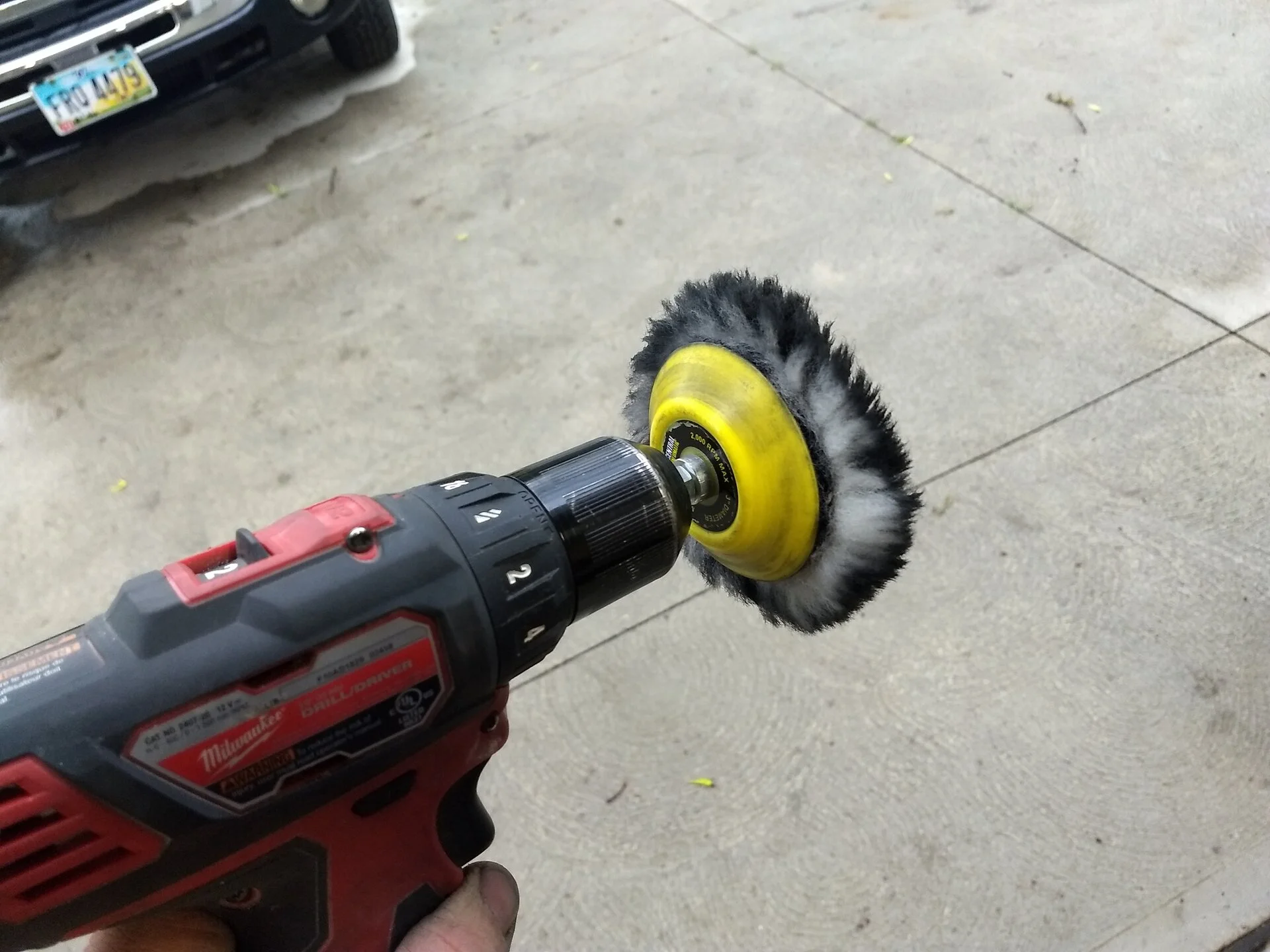

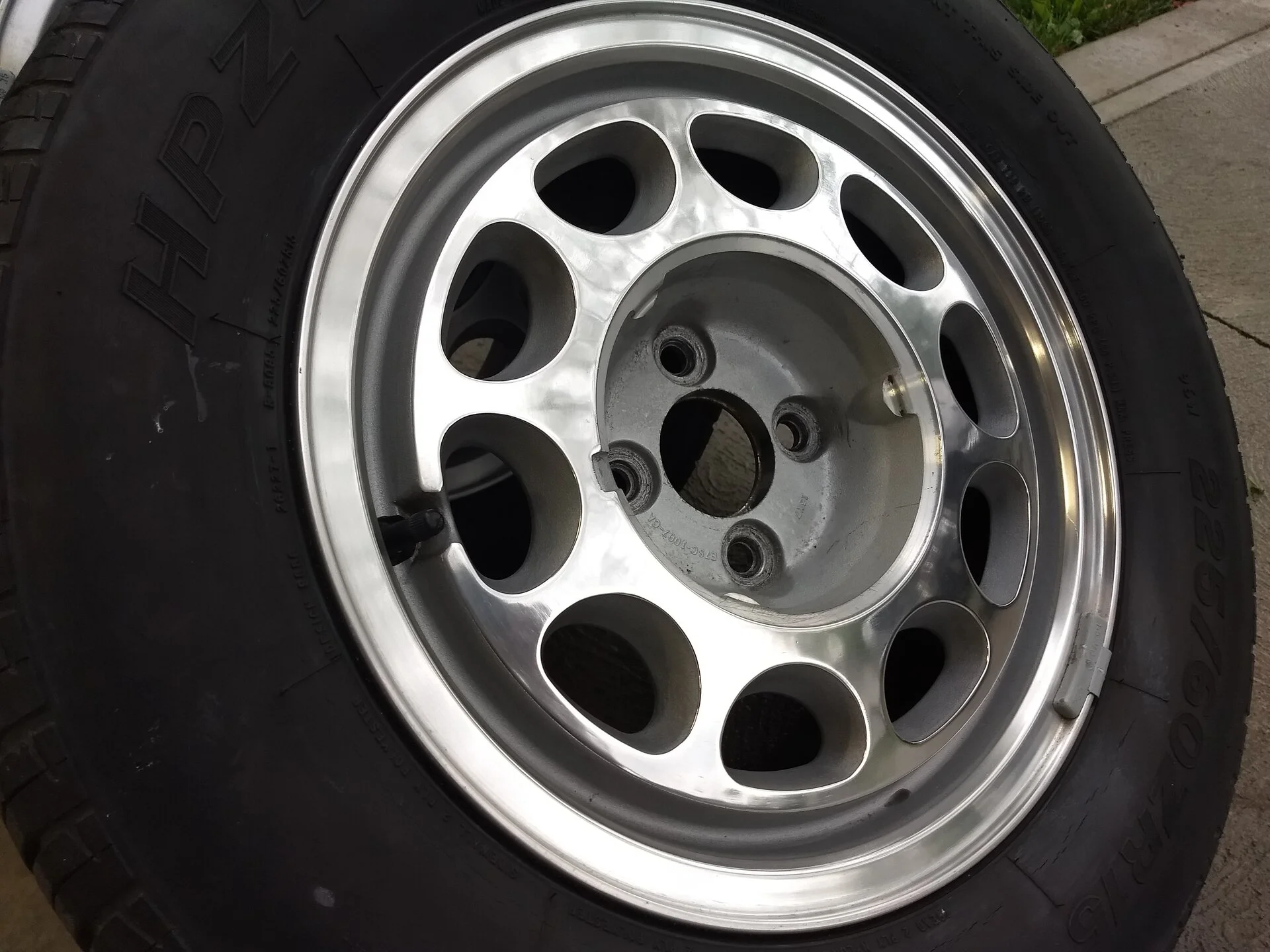

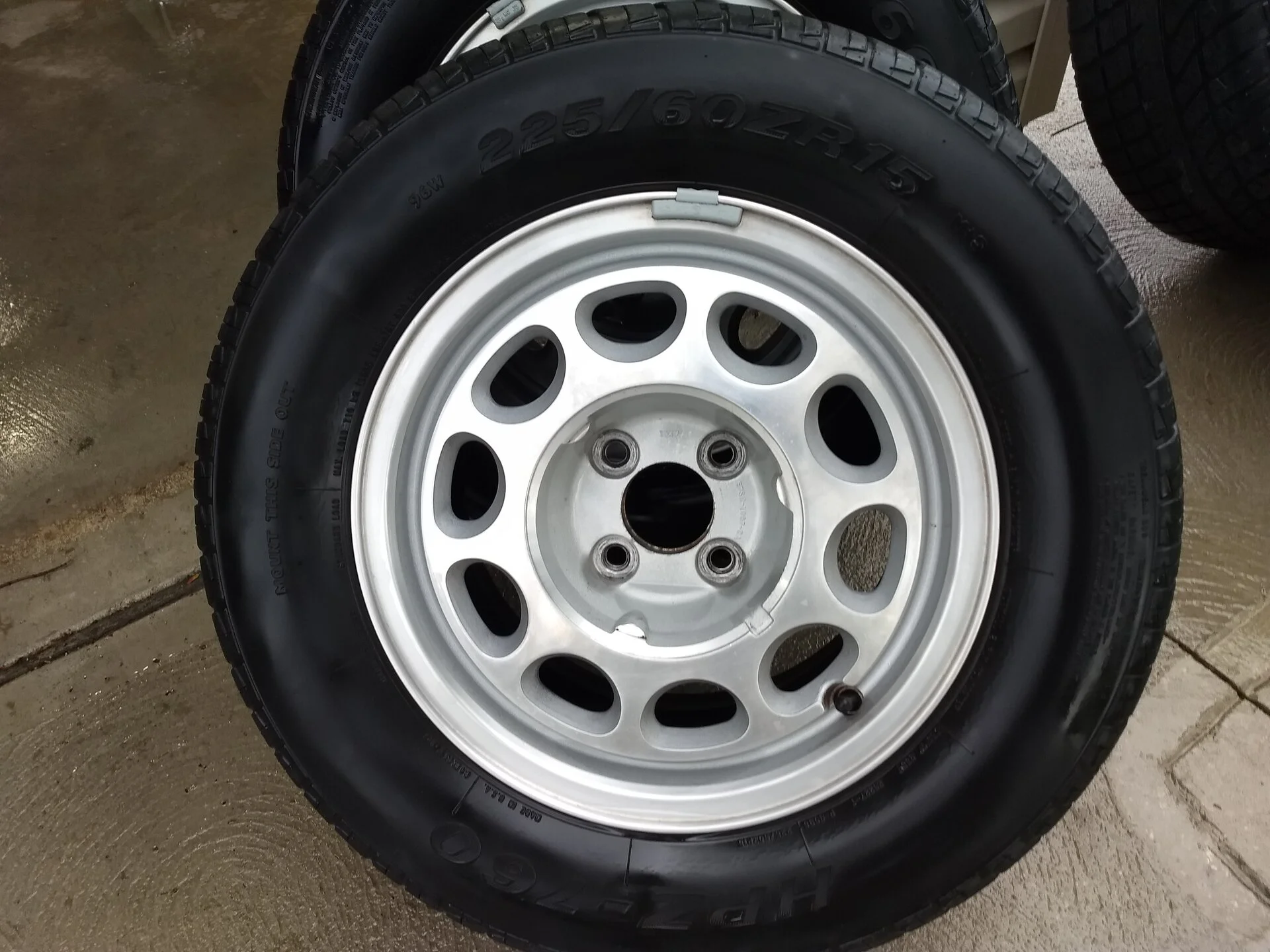

Took a half day off from work to get this car finished. I got the interior all back together, door panels, hatch panels, kick panels and sill plates. No interior pictures, but I did clean and polish my wheels, and I have pics of that.
First I gave them a good scrubbing, these things were pretty nasty, so I made a mixture of Zep degreaser and spray nine, but only because I was almost out of the Zep, or I would have just used it full strength.
I don't know when they were cleaned last, I've owned the car for a year and a half and never cleaned them. Anyway they were bad enough that I used a red scotchbrite pad to scrub the brake dust off.
So they came out clean, but really dull. I think 10 holes are supposed to have clear coat on them, but mine don't, maybe someone stripped them?
You can get these little buffer pad adapters at harbor freight, they come with 2 foam pads and this wool pad, it was white when I started.
5 pic limit.

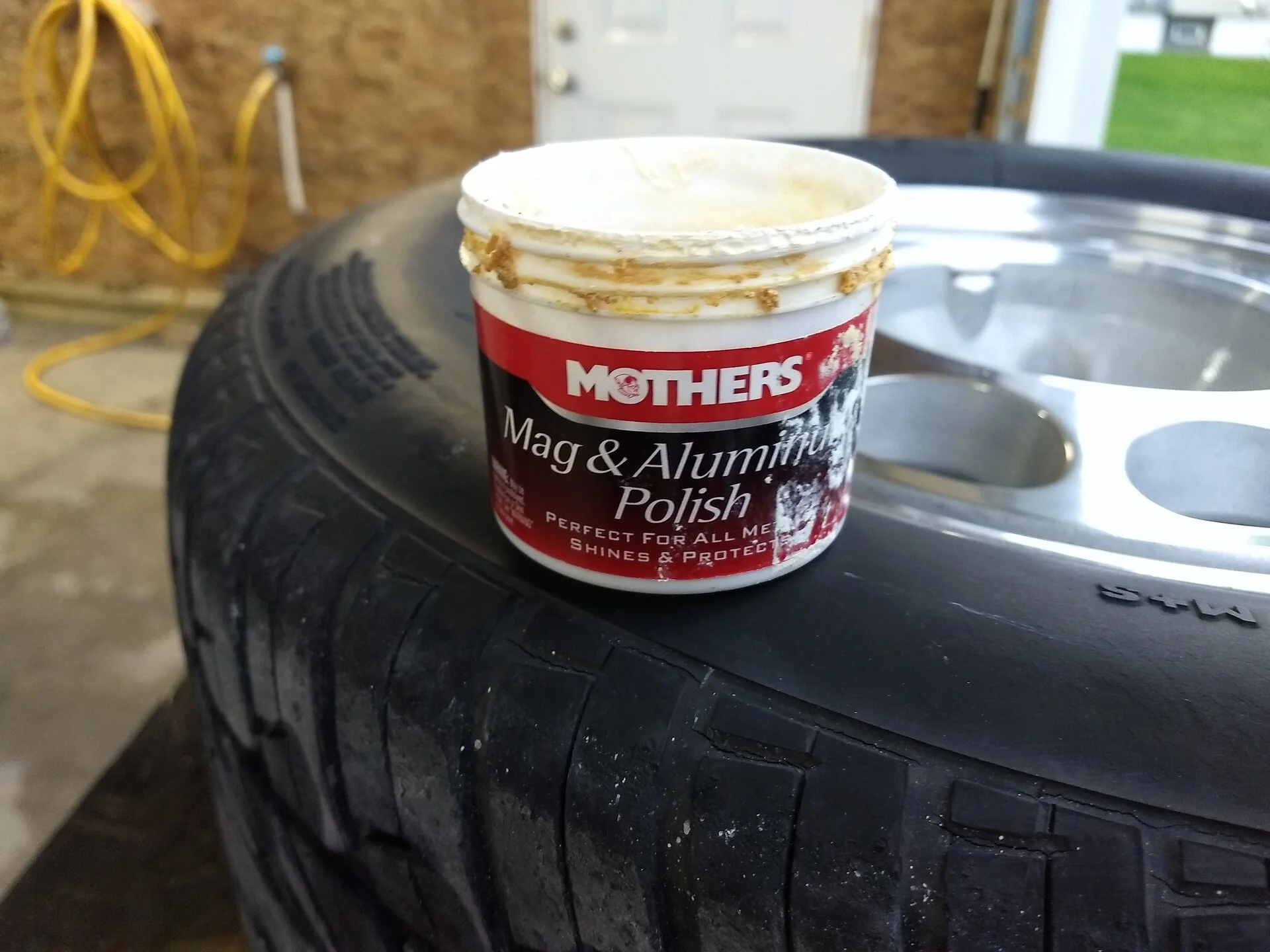

I used this mother's polish, a little bit goes a long way, I probably only spent about 15 minutes per wheel, the little buffer makes it quick. I used foaming glass cleaner to clean the polish residue off of the cast areas, and put a coat of wax on when I was done.
They don't look like chrome, but they're a thousand times better than what I started with, and didn't really cost anything but my time.
