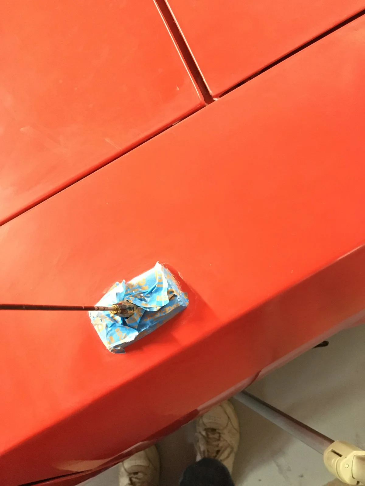

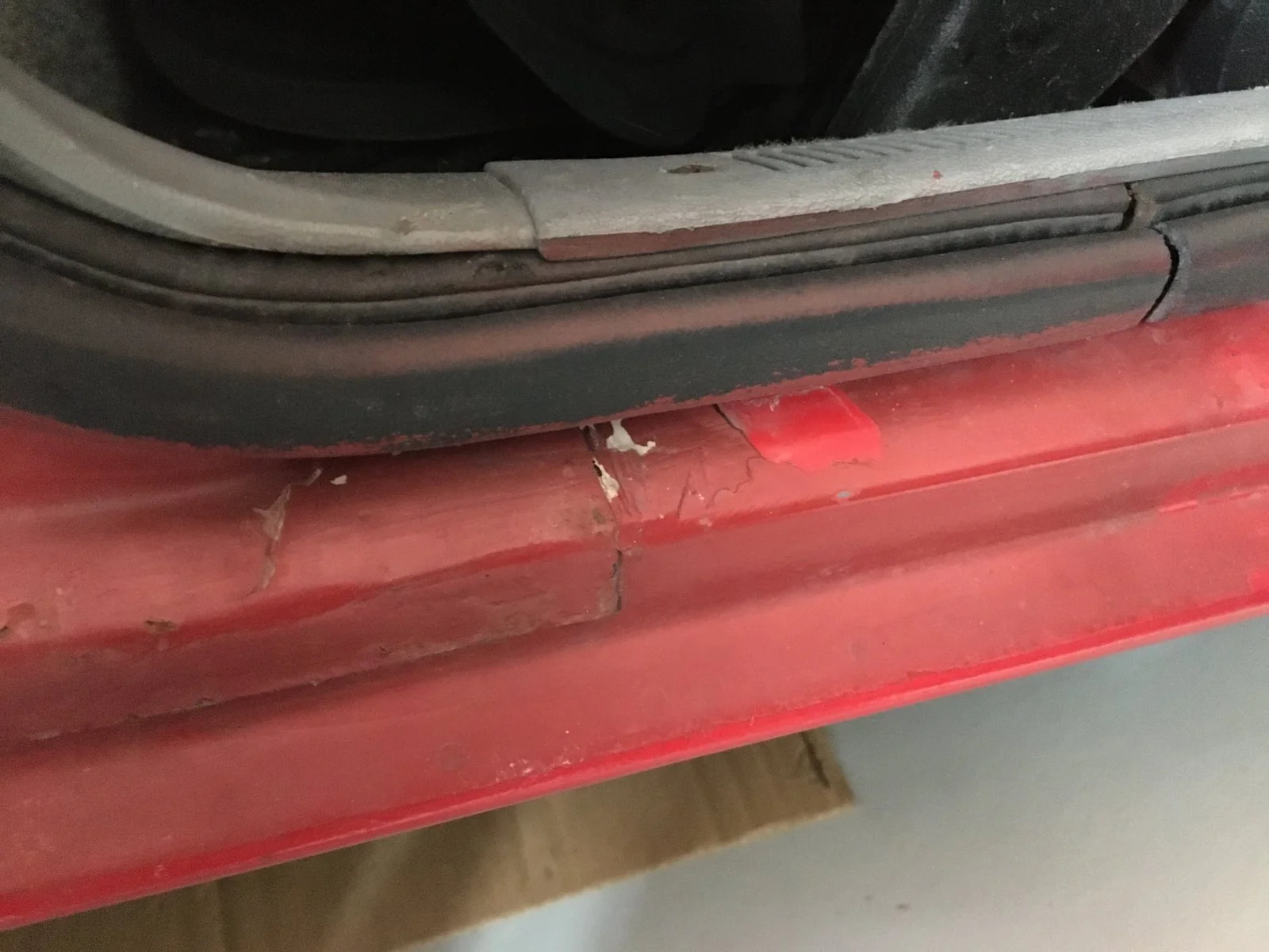

Started some investigating on the body this week. Turns out the paint is NOT original. I'm not sure if this was a full blown rattle can deal, or if the PO got the super budget package from Maaco. I tried to polish the paint to bring back some shine - my goal is to have the paint looking like a new car. But there really wasn't much of a difference. so I bought some 1500 grit (the finest my local auto parts store had) and did some wet sanding. Immediately the water turned pink, indicating to me there was practically no clear coat.
So I'm thinking now I'll order some 5000 grit from the internet, but it that fails, she may need a whole respray (after body work of course). Also, its probably time to order a history report to see how many accidents she's been in. Who do you guys like for Reports? I've had good luck in the past with checkthatvin.com.

Either the water turned pink because you cut through the clear coat , however thin it may be,
or it's a single stage paint, without clear coat. Although from the pics it looks like it has some clear ?

Yeah, I’m pretty sure its a rustoleum special. Which means lots more body work for me!

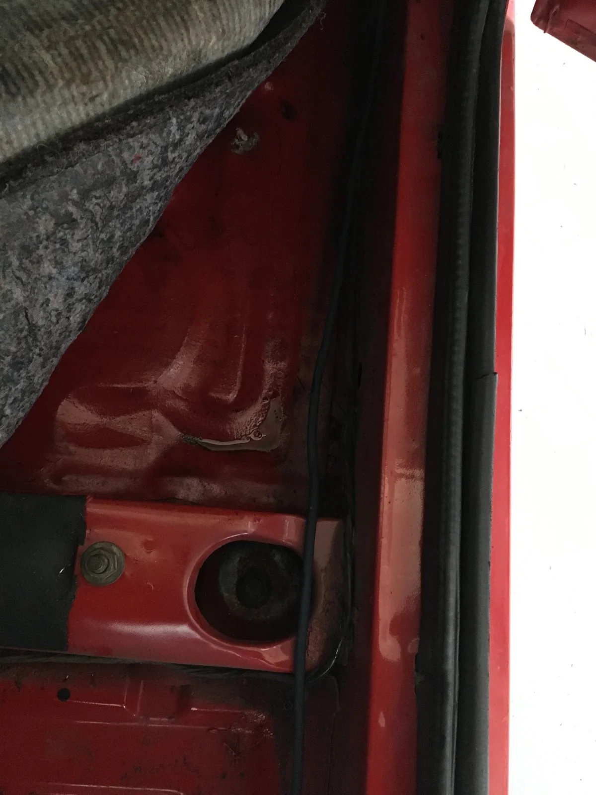

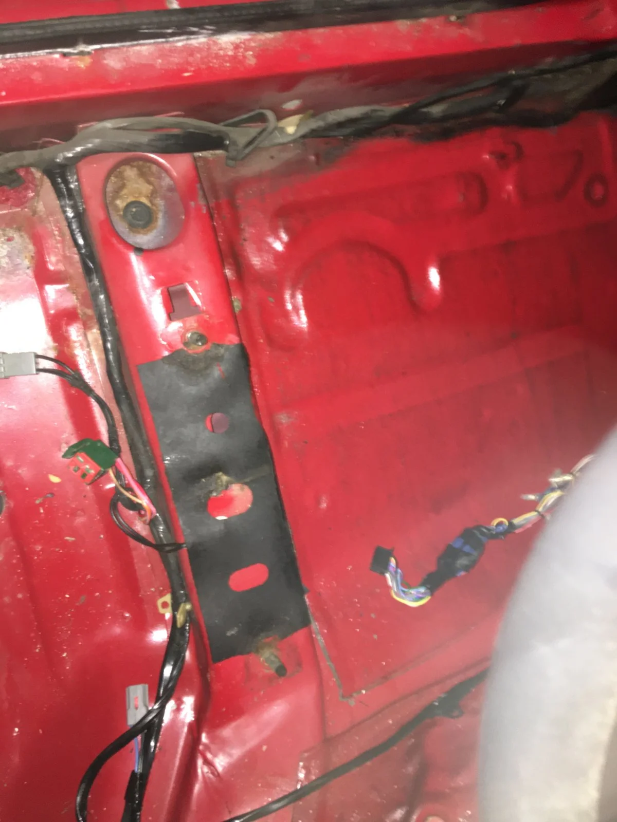

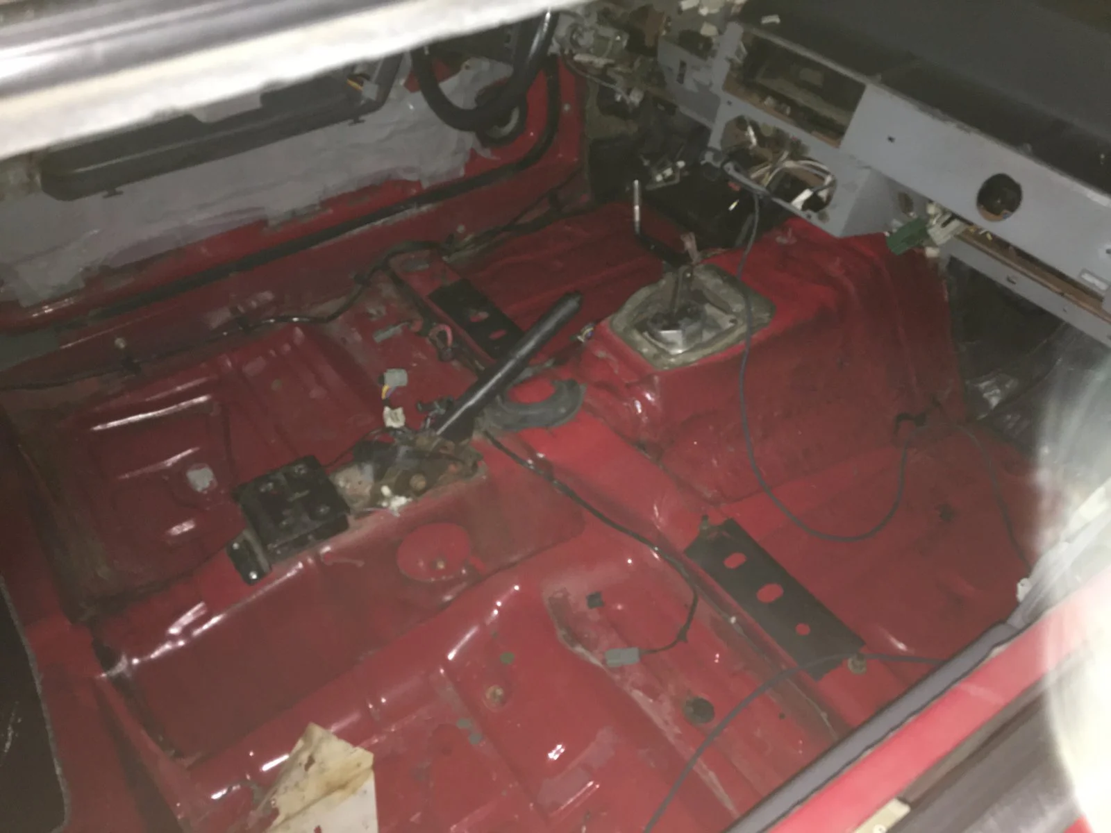

I started tearing out the dash and the interior so that I could confirm what i had hoped when i bought her, that the floor pan was good. And it was! See pics below. The only rust is inside the seat mounting cross rails and a little by the rear quarter panels. Not so bad. And Ive been wanted to try out something I read on the internet, where you wash the carpet in a large washing machine and it comes out looking nearly brand new.
Unfortunately, for reasons i don't understand, the insulation under the carpet on both the drivers side and passengers was sopping wet. It didn't smell like coolant or anything, just dirty water. This mustang has been stored in my garage since i bought it in February, and the only thing i can think of is that water got in when i pressure washed her a month ago. But i mean, this was so so wet, and it confuses me. But I'm planning on replacing all the weather strips and seals anyways, so i guess its ok.
Also, i got a part that is critical to this restoration
I don't know if you have yet...but check the cowl...under the plastic cover. In my thread I'll be showing how to use screen to cover the area under the vent...and over the air intake horn on the passenger side. That intake horn is the favorite way for vermin to get inside the car.
Check your heater core.
Thanks for the suggestion! I don't think its that since it did not at all smell like coolant. However i will probably be removing the heater core at some point anyways to make swapping the wiring easier when i do my 5.0 and to flush the heater core.

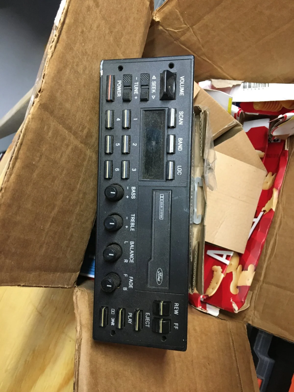

That's not the original radio for a Mustang.
That's a 87-89 Lincoln Mark 7 head unit. Should say E8LF-19B165-AB on the side somewhere
Itll still fit though though right? Just have to get the right wiring harness.
Thanks, ill be watching your thread for sure. That sounds a lot more likely than door seals leaking and the water running down to the foot wells.

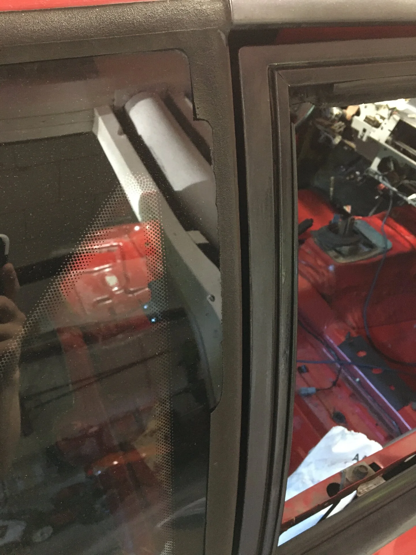

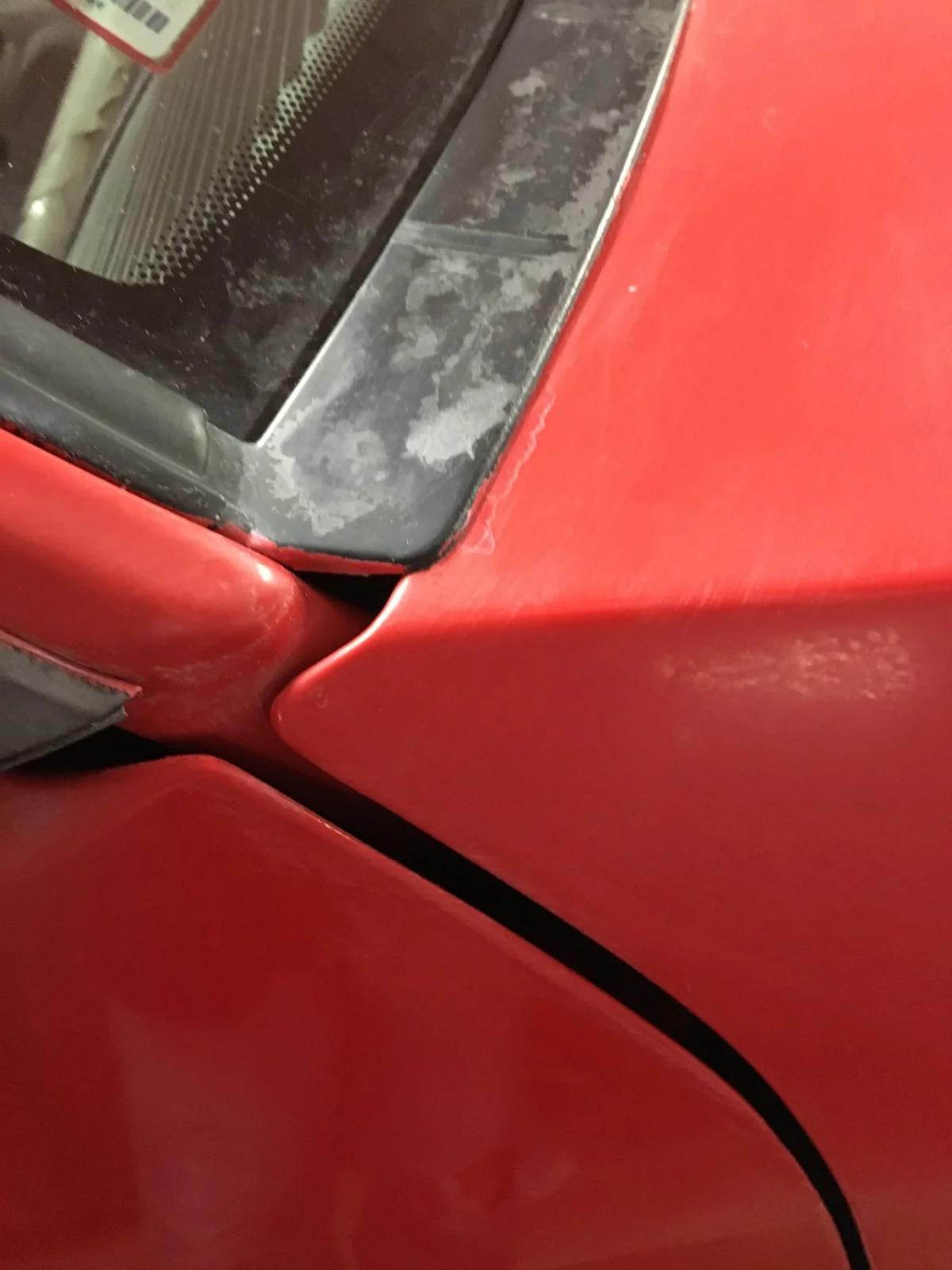

I'm taking off all the trim to prep her for paint. But i'm stuck on what to do with the quarter glass. The molding around mine is torn away. Seems like everyone here uses a high build primer, sands, and paints it like new. Is there another option for me besides replacing the whole window?
There’s no way to fix that. Not that hard to replace. There’s 9 bolts and then butyl tape holding them in. Used ones pop up on eBay, kinda pricey.
