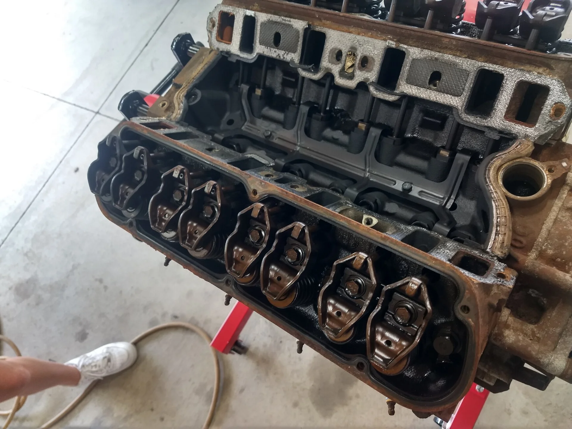

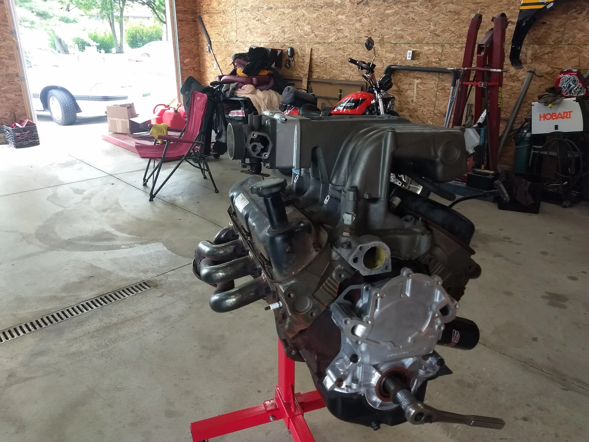

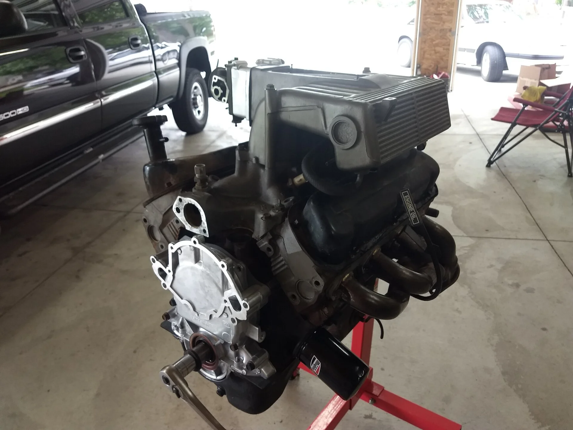

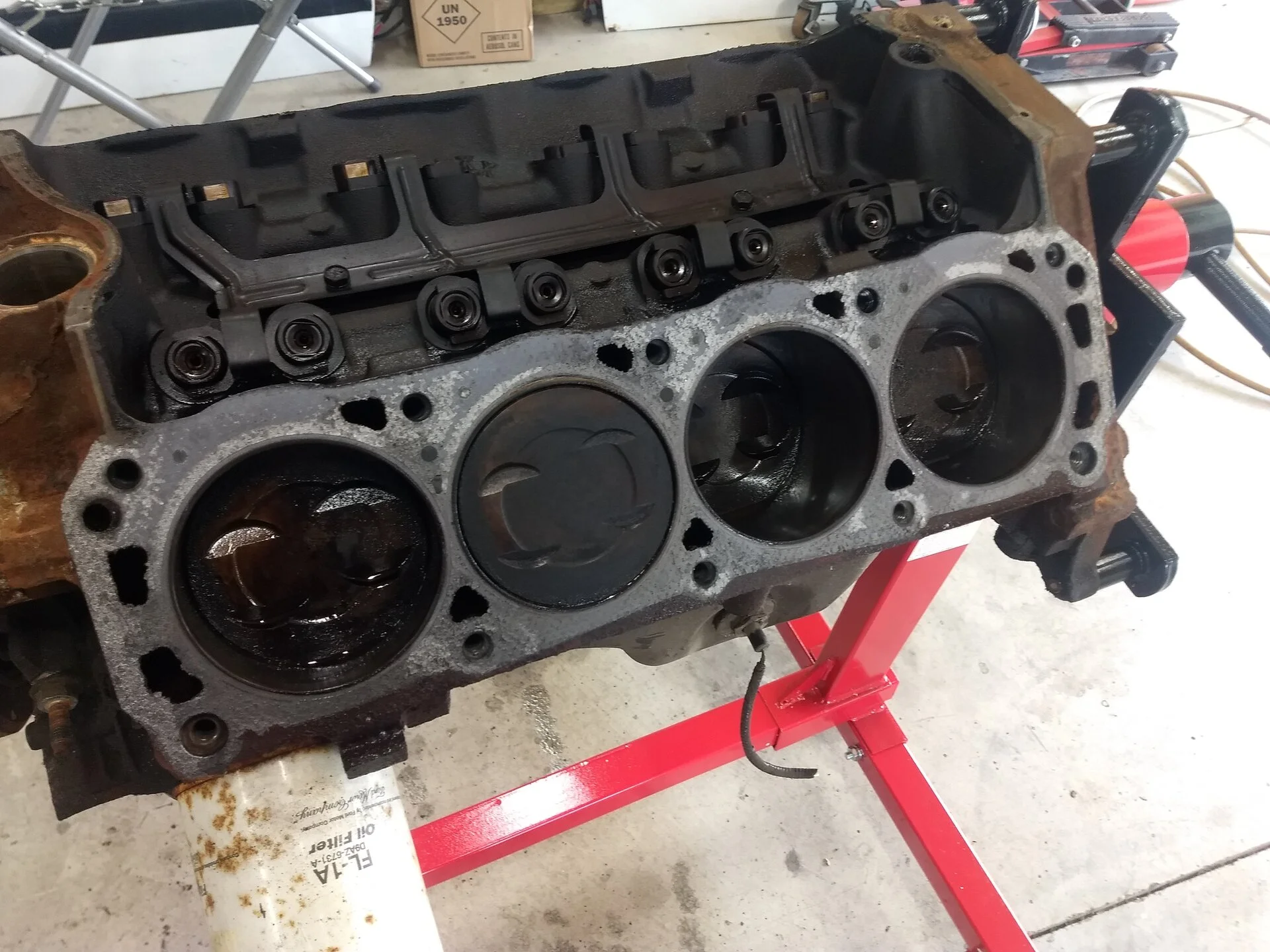

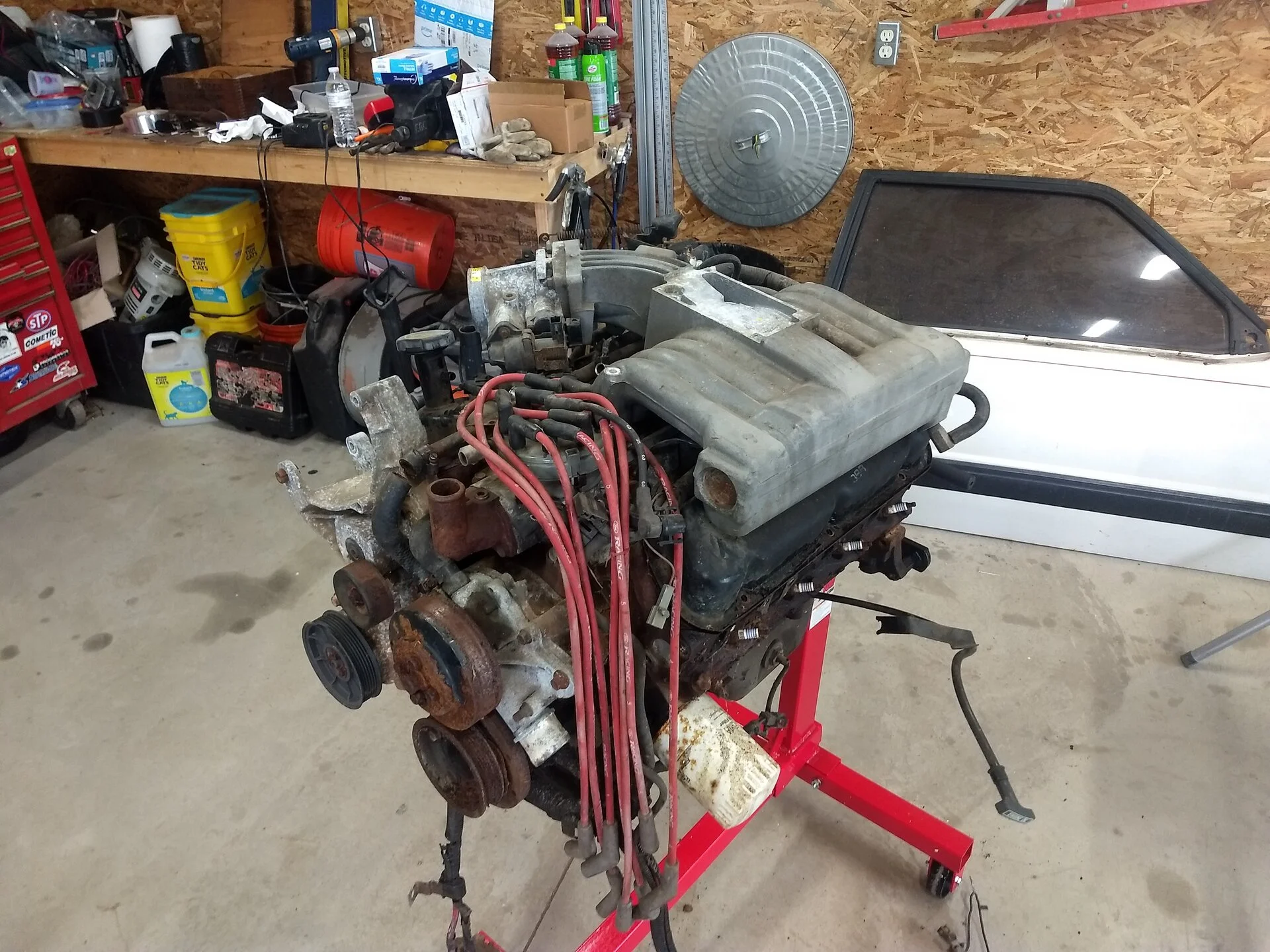

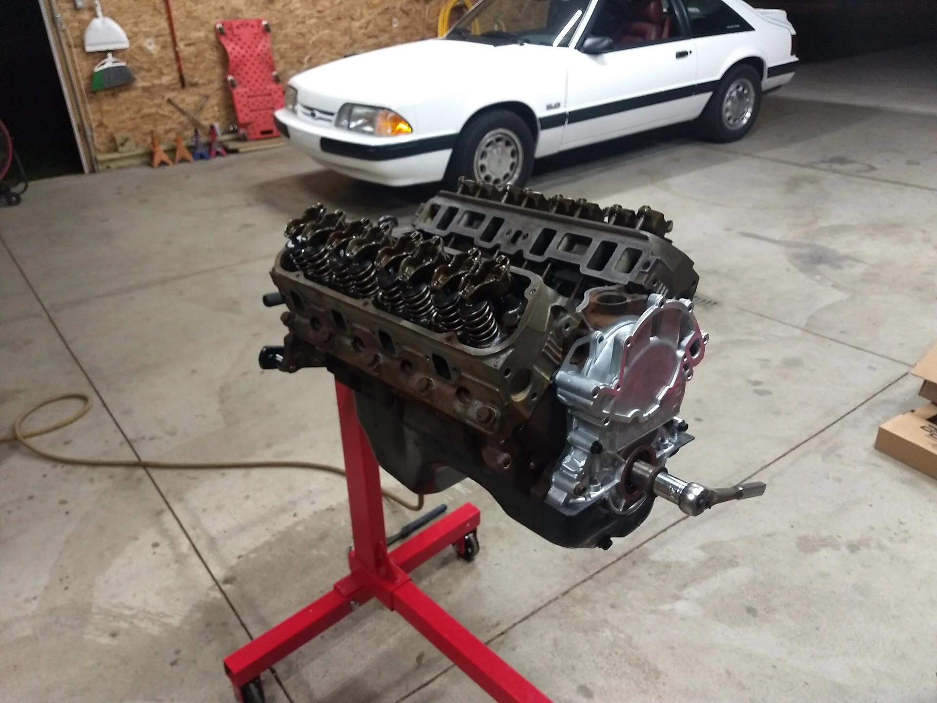

I'm doing this a different way than most would, the engine in my car runs so good, I can't bring myself to tear it apart, so I found another engine for cheap, and I'm going to put the P heads, b cam, and Explorer intake on it and then just do a quick engine swap.
I have the other engine torn down, I'm waiting on gaskets and some other parts to show up, and then reassembly can begin.

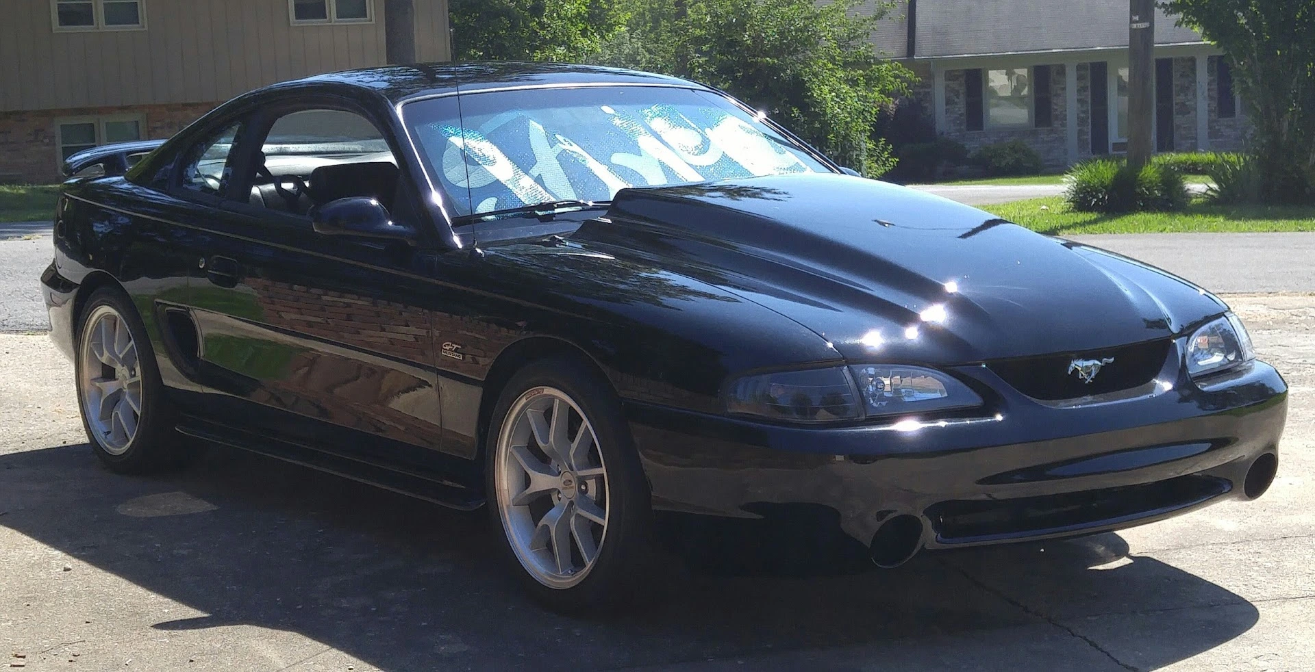

Whats up with the car Gravydog

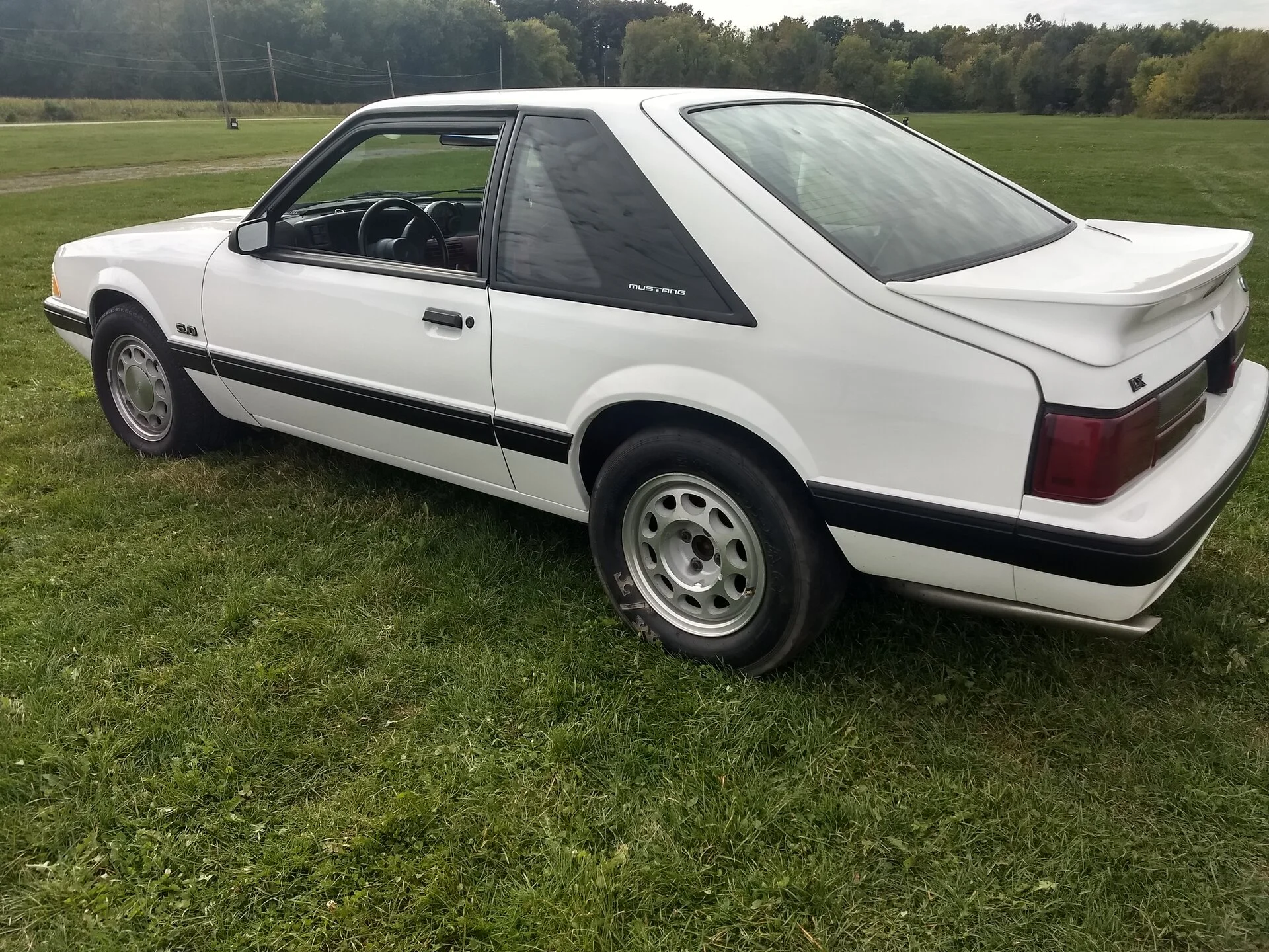

Not a whole lot, just been enjoying it this summer. I drive it almost every day, it hasn't given me a bit of trouble, and gets a lot of attention, seems like everyone knew someone that had one back in the day.
I have done a couple of small projects, one was slotting the holes in the k-member to correct my screw up from when I did the frame rails, that worked out fine and I was able to align the front end. The other was rear gears, I was originally going to go with 3:73's, but I decided since my car has a 4 cyl T5, that 3:27 would work better.

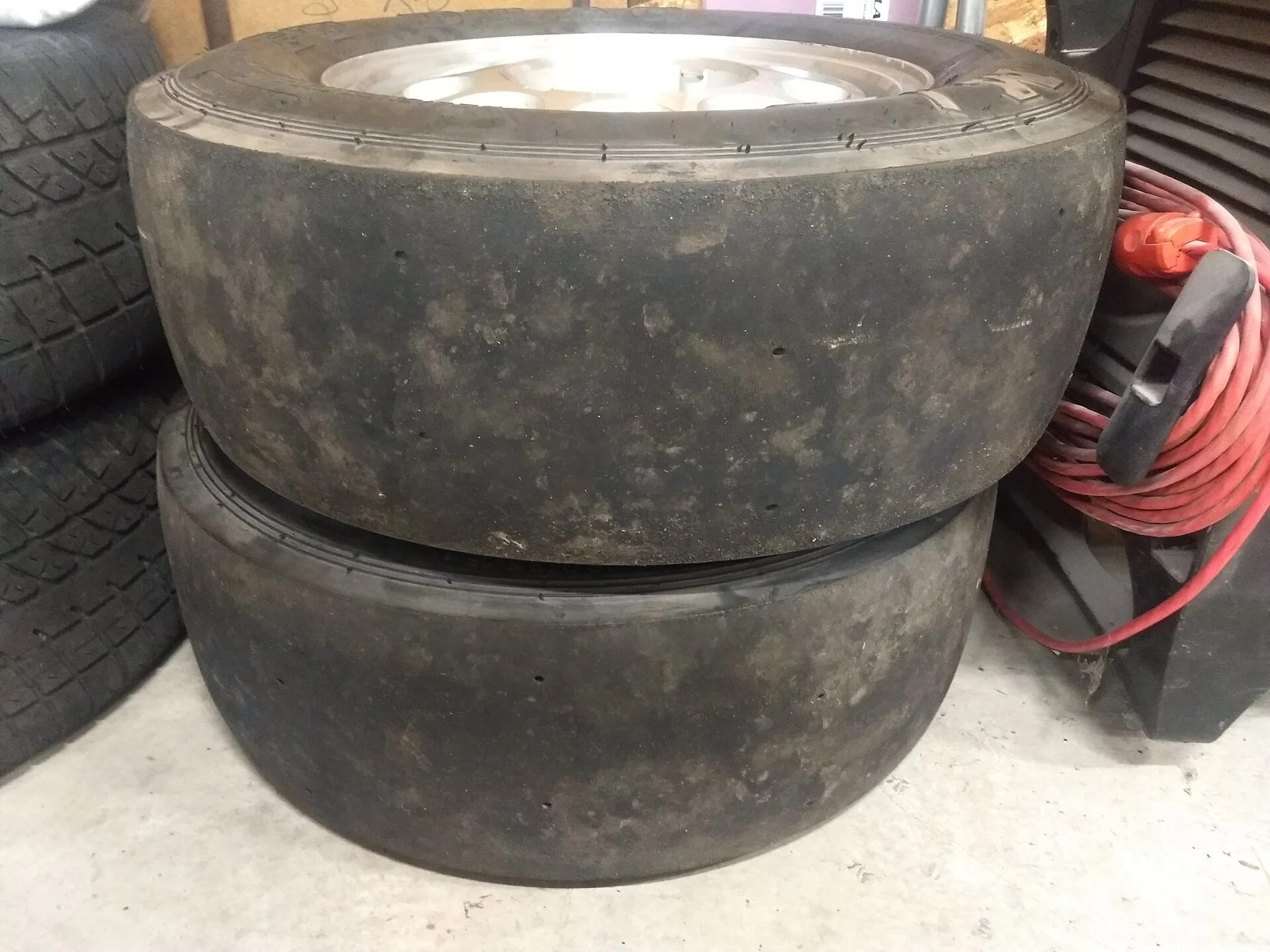

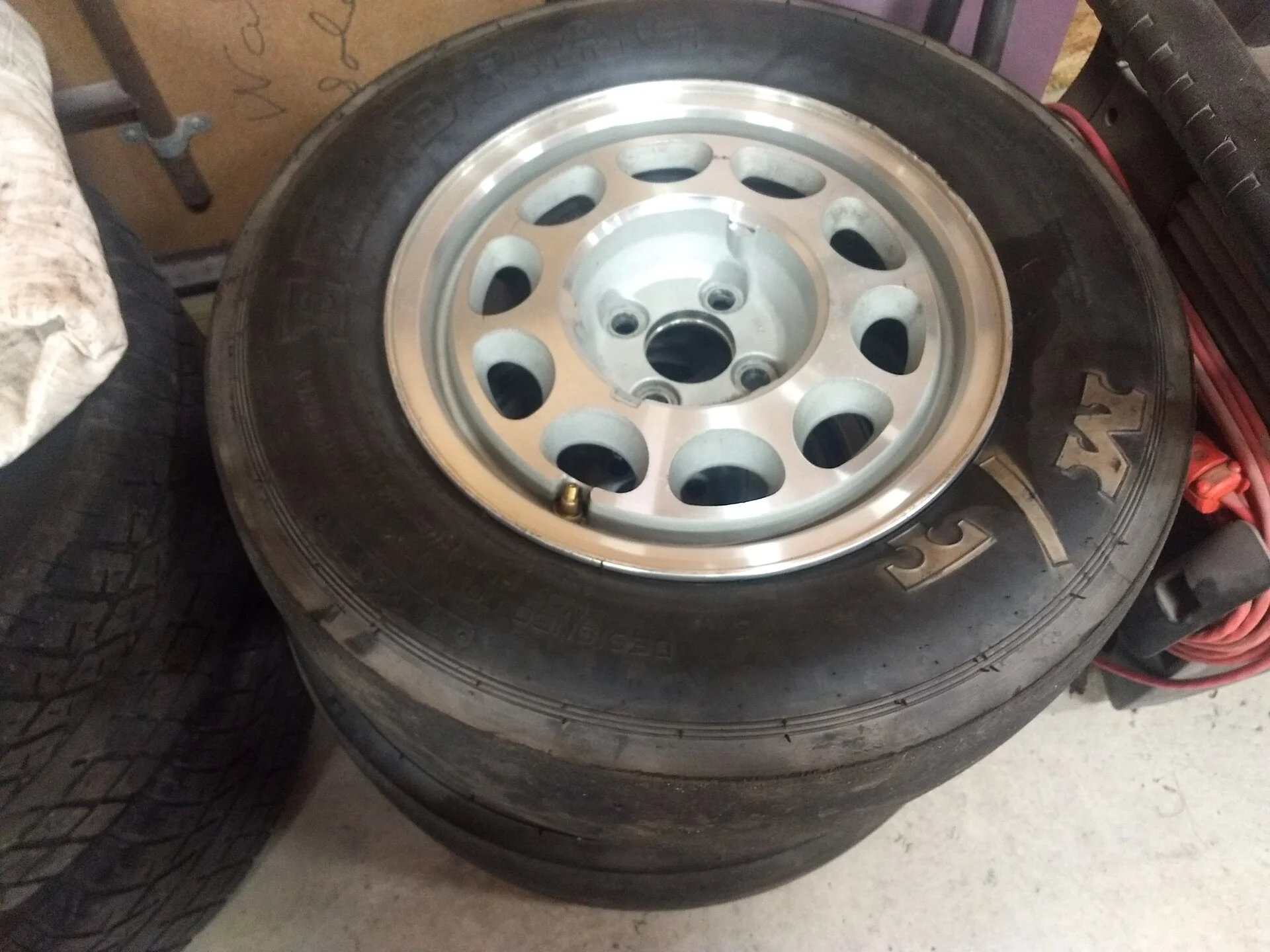

I also took it to the drag strip, we have an 1/8 mile track about 20 miles away. One of my best friends has a Focus ST and we went on a test and tune day, we had a blast. With the 2:73 gears, the best I could do was a 9.70, but that was babying it through 1st gear or else the wheels would just spin. The good news is, I got an awesome deal on these.
They're 26x8 and came on the wheels, I'm hoping to get back to the track in the next couple of weeks to try them and the gears out.
I also got the new used motor ready to swap, but I want to run it stock at the track first.
Run down on the motor is, stock 94gt bottom end, B303 cam, Gt40p heads with Trick flow springs, Explorer intake, BBK shorty's, Explorer 65mm throttle body, 70 mm mass air. Really just a bunch of junk, but it should make for a fun, cheap street car.

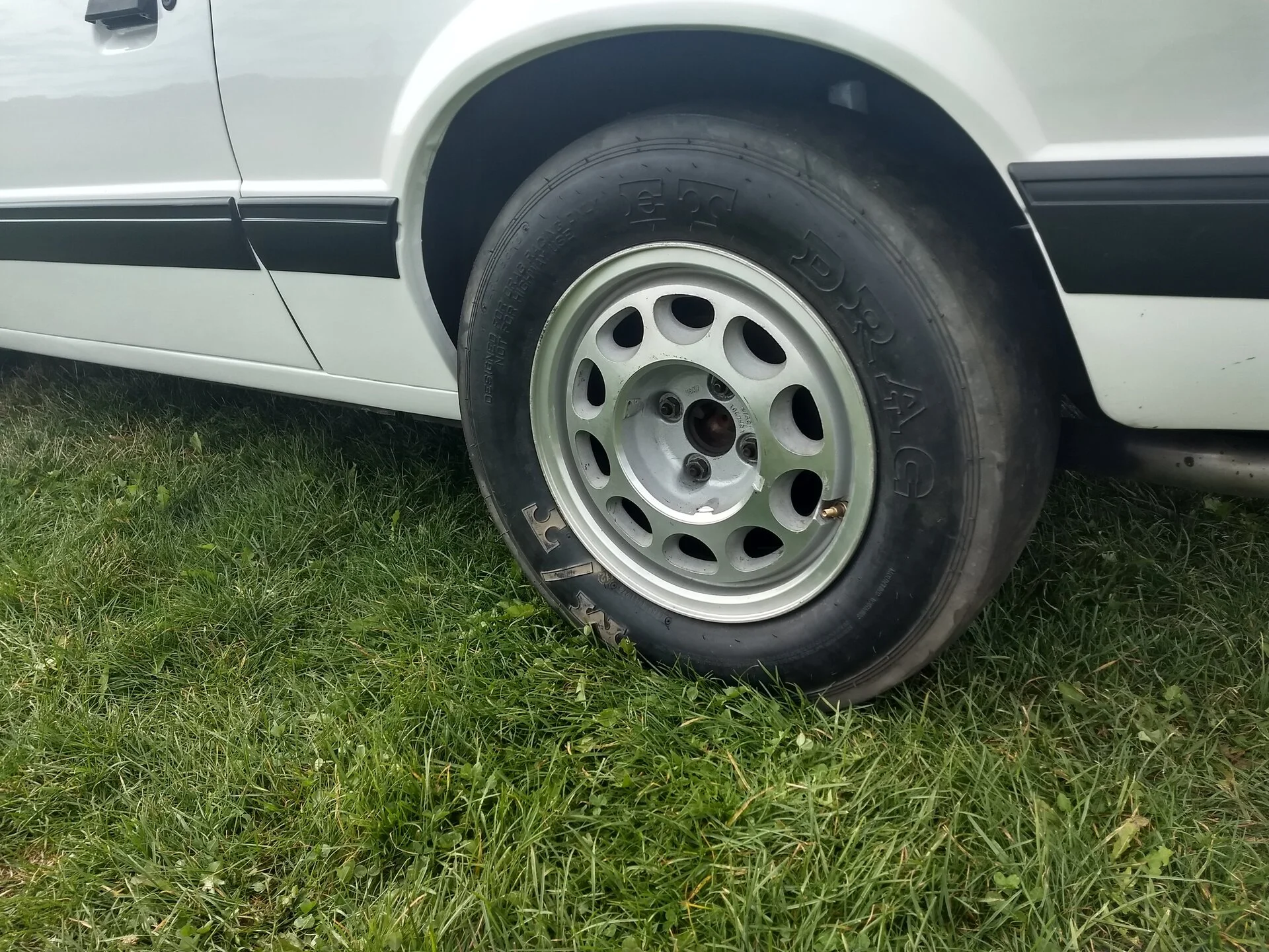

So I made a total of 10 passes, it was a test and tune day. This was my first time launching a car with slicks, so I'm still learning how to drive it. The weather was great, about 58 degrees. My first pass out of the gate I ran a 9.2, I played with air pressure in the slicks and kept getting faster, I ran a handful of 9.1's. I was getting a feel for the launch, and played with shifting at different rpm's, I had a couple of 9.0"s, with a best of 9.004. I was trying to break 8.99, but just couldn't, on my last pass I missed 2nd gear, and decided that 10 passes was enough, I still had to drive the car home, and it was still in one piece.
This is what I have been waiting for, now I can do the motor swap, and have something to compare it to. I'll update when that happens.

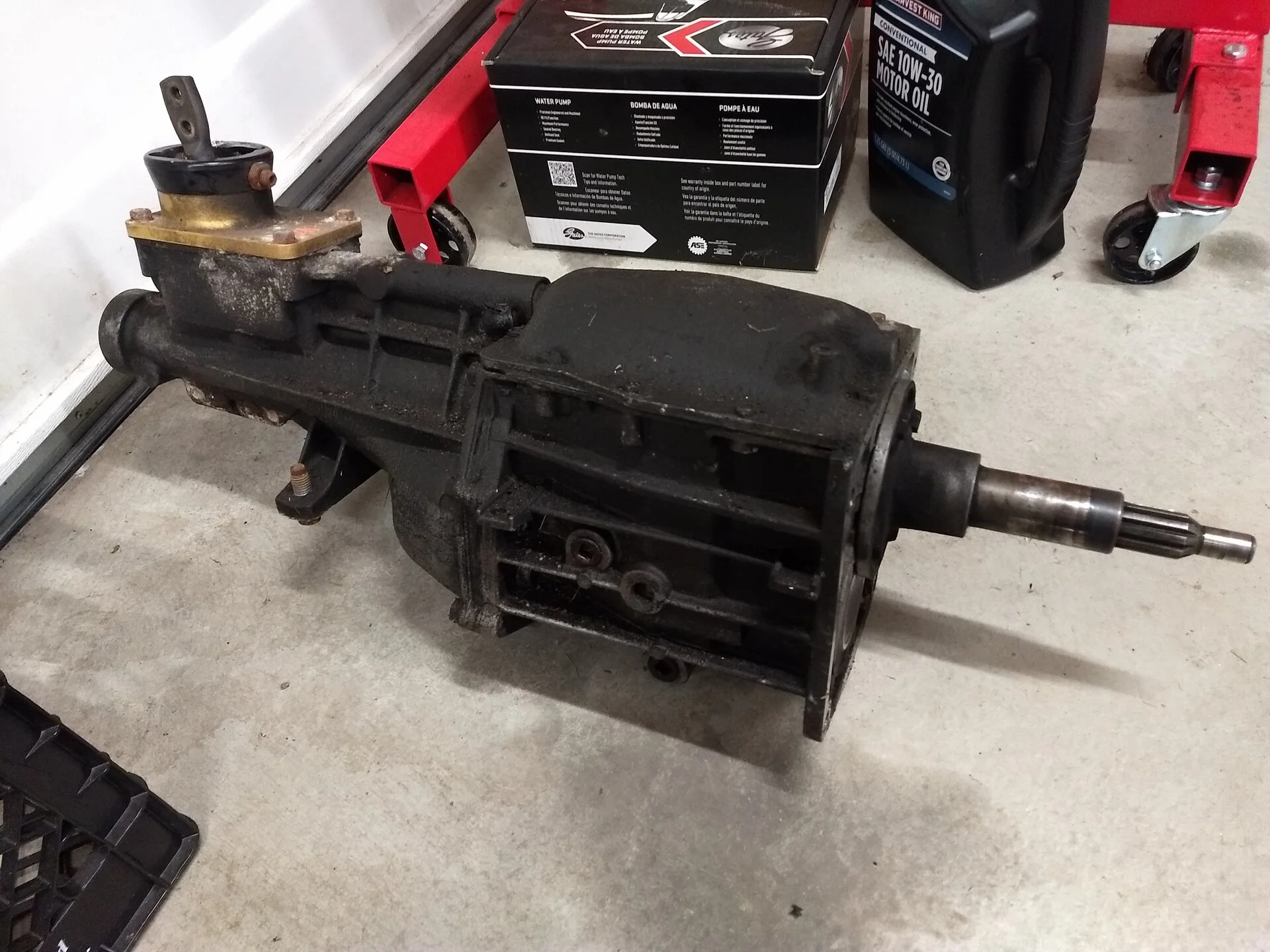

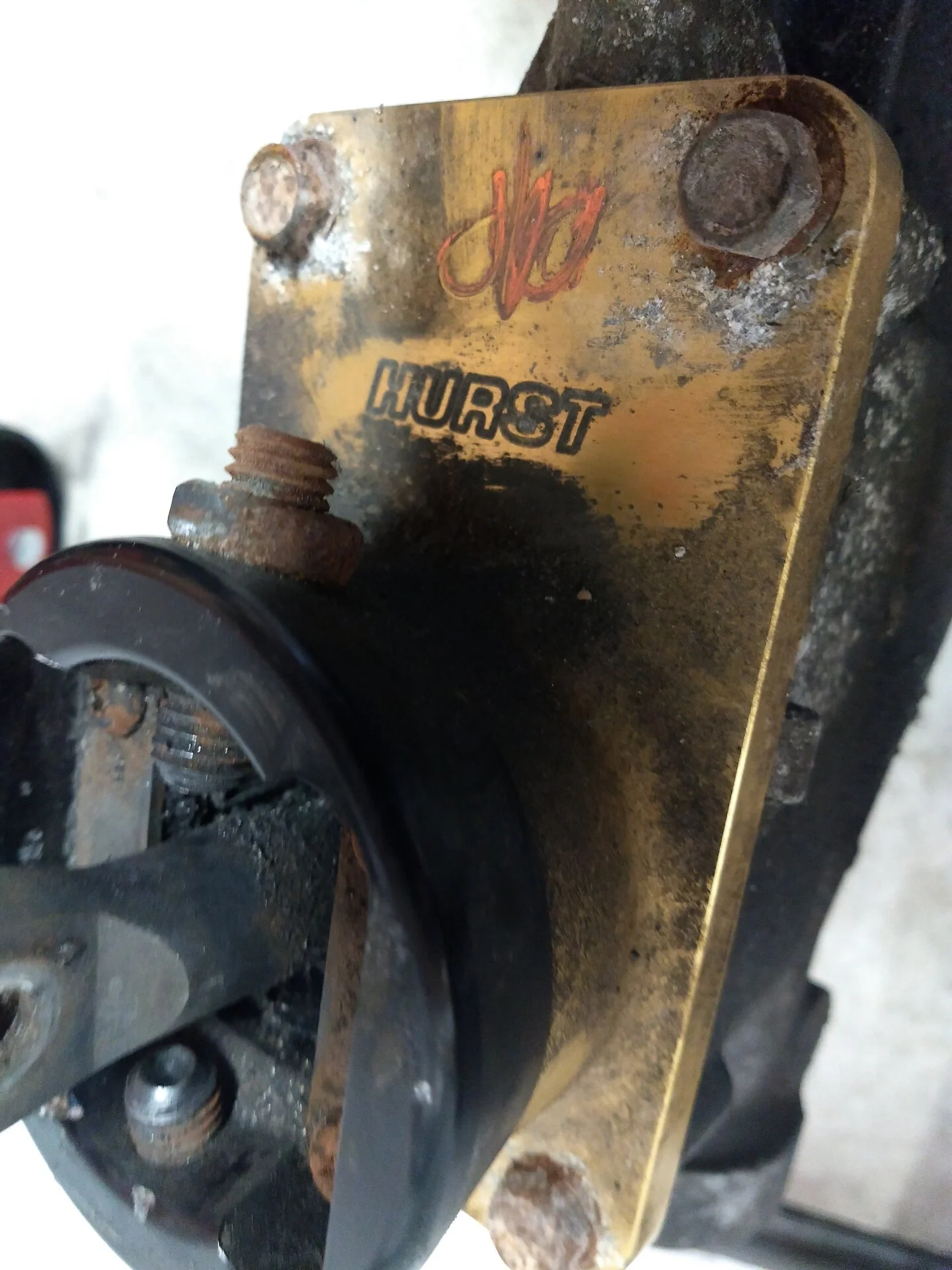

I found the last piece of the puzzle at my local Pull-a-part today, it's a T5 out of a 2004 with a V6, I know I will have to switch the input shaft, and the tail housing, but for $112 out the door I had to get it. I didn't even have to pay extra for the Hurst shifter! Now I can ditch the 4 banger trans that's in there now, I might have to rethink the 3.27 rear gears though.
