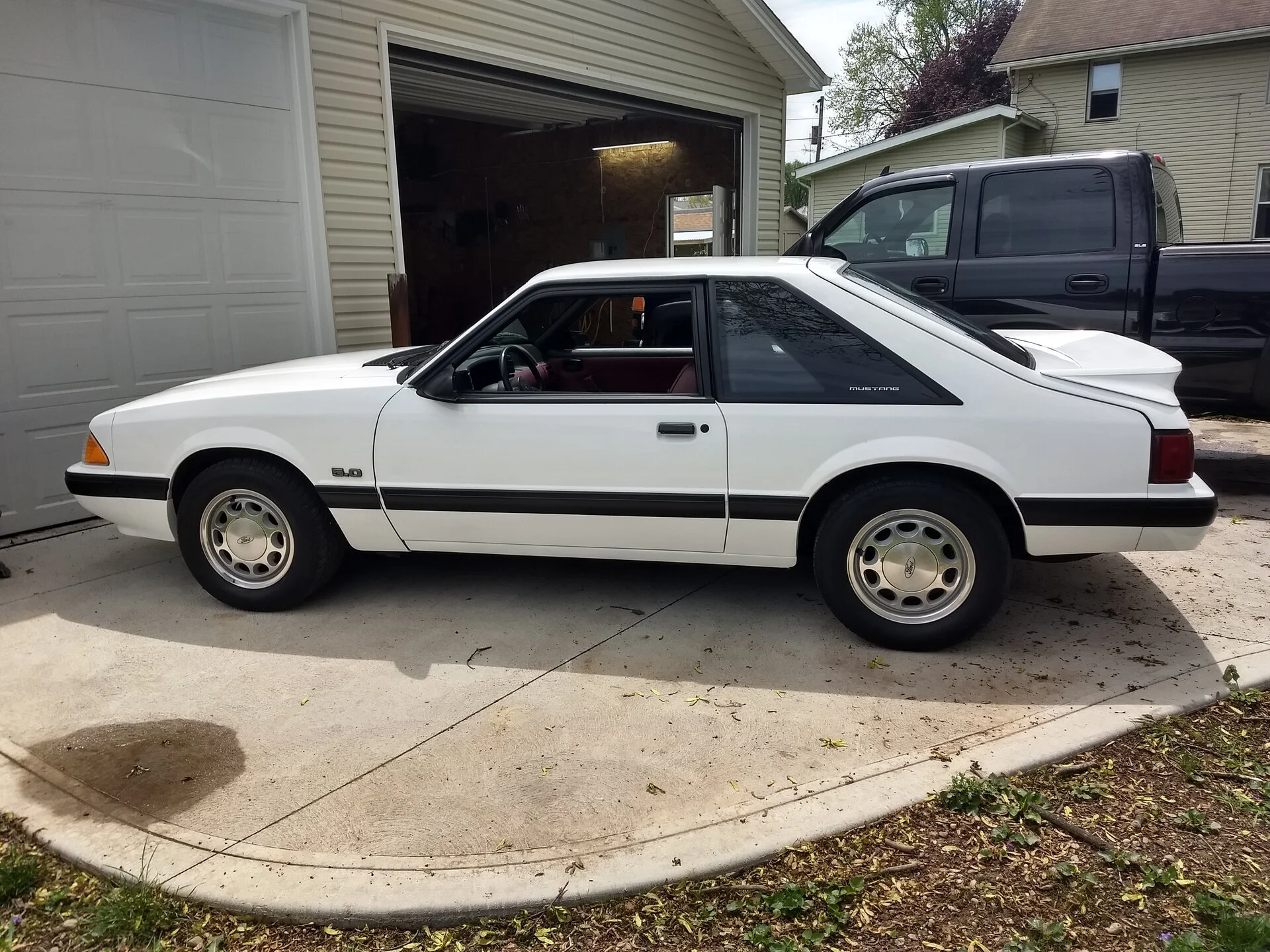

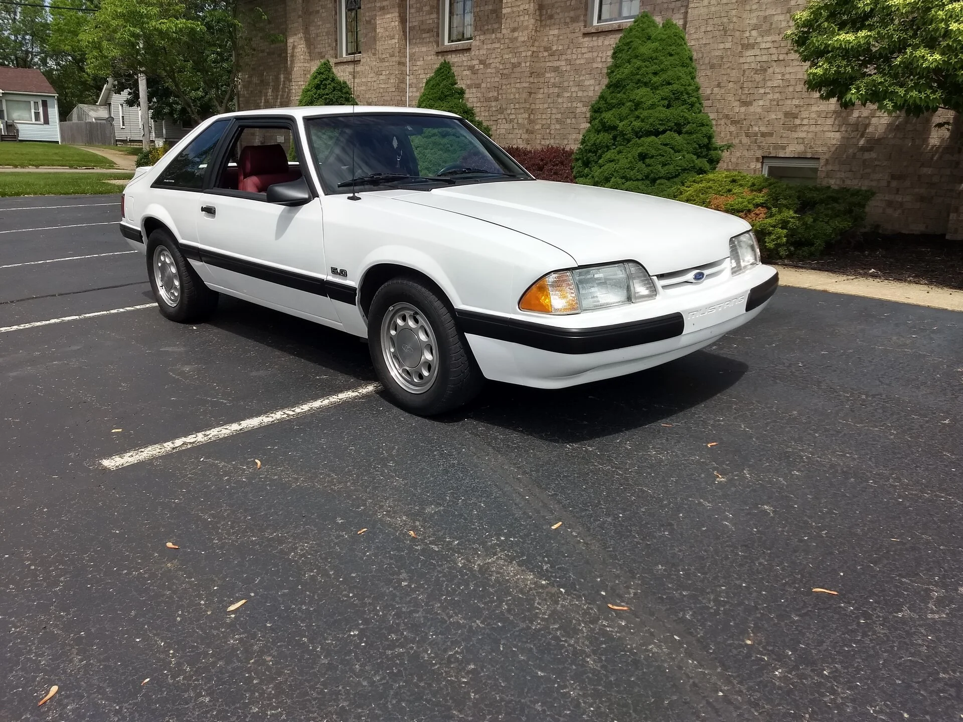

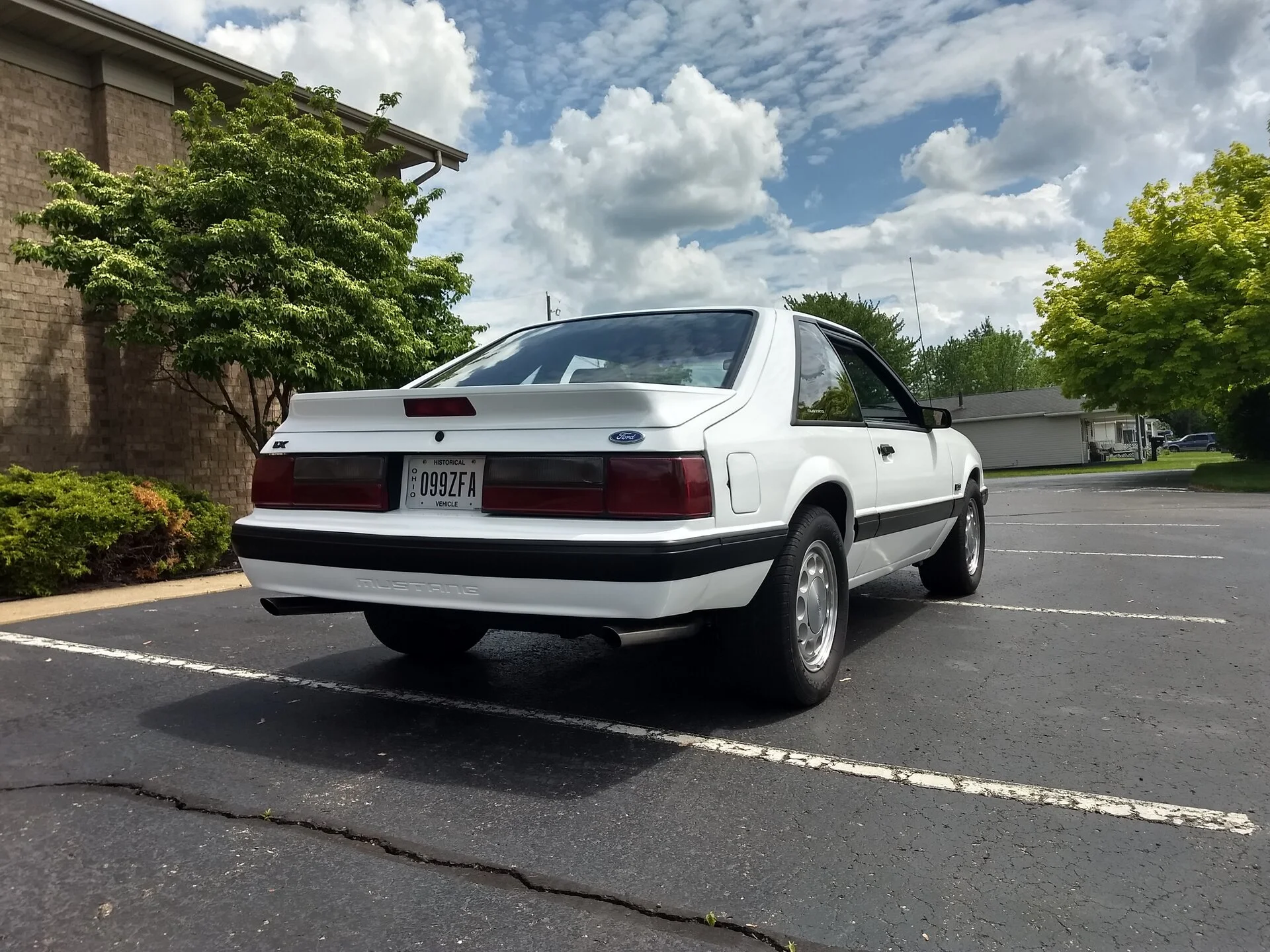

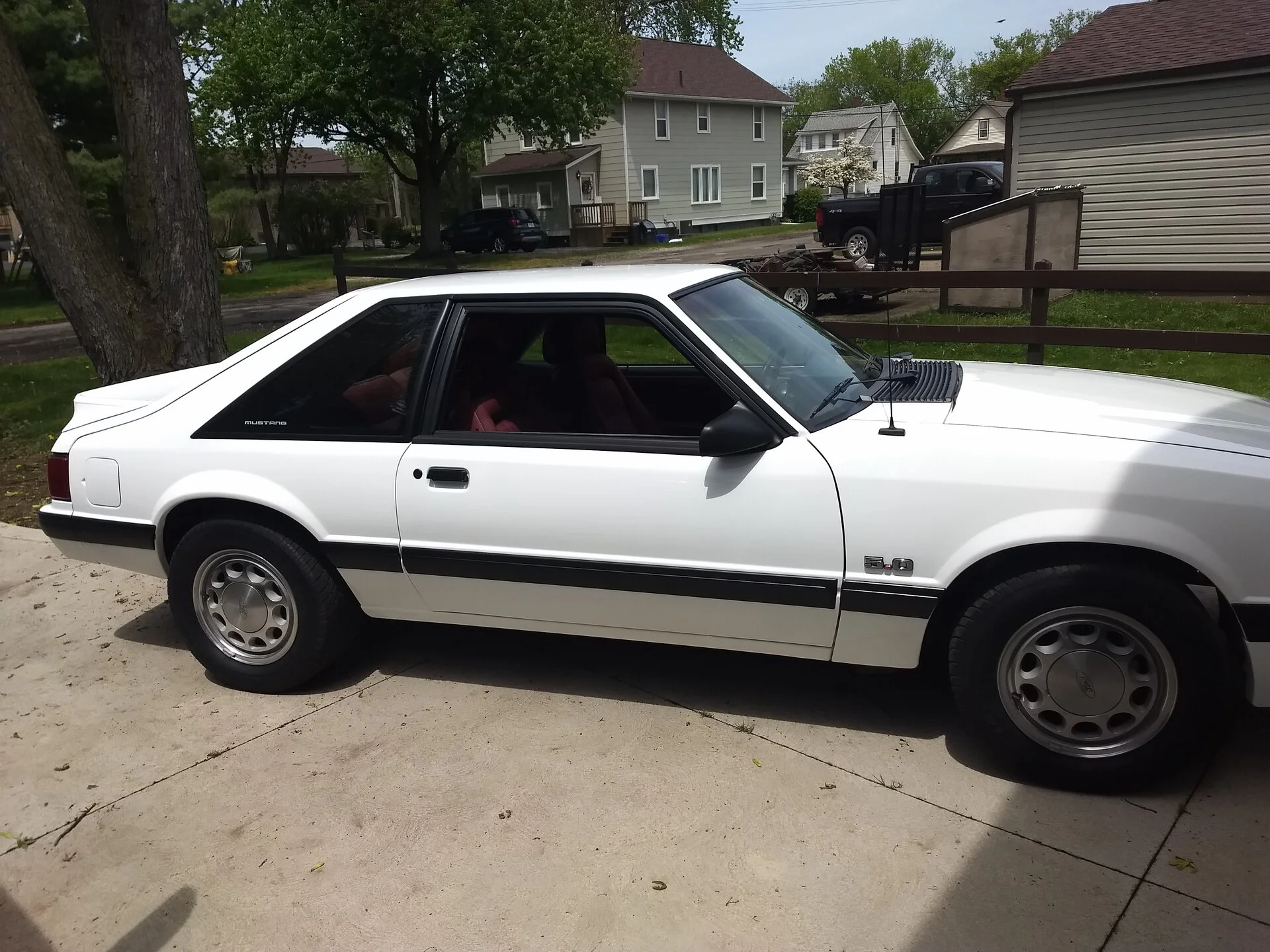

My 10 holes don't have clear on them, someone had to strip them at some point, I'm glad they did, less work for me. I would love to have some different wheels, but I spent that money on heads, cam, and intake.
Anyhow, it's all back together, I'm using it as a parts runner today, getting my truck ready for our Vacation in a couple of weeks. Just a couple of quick pics, I'll get some better ones later.
Reactions: BlakeusMaximus, Cheapskate207, Willybill32 and 2 others

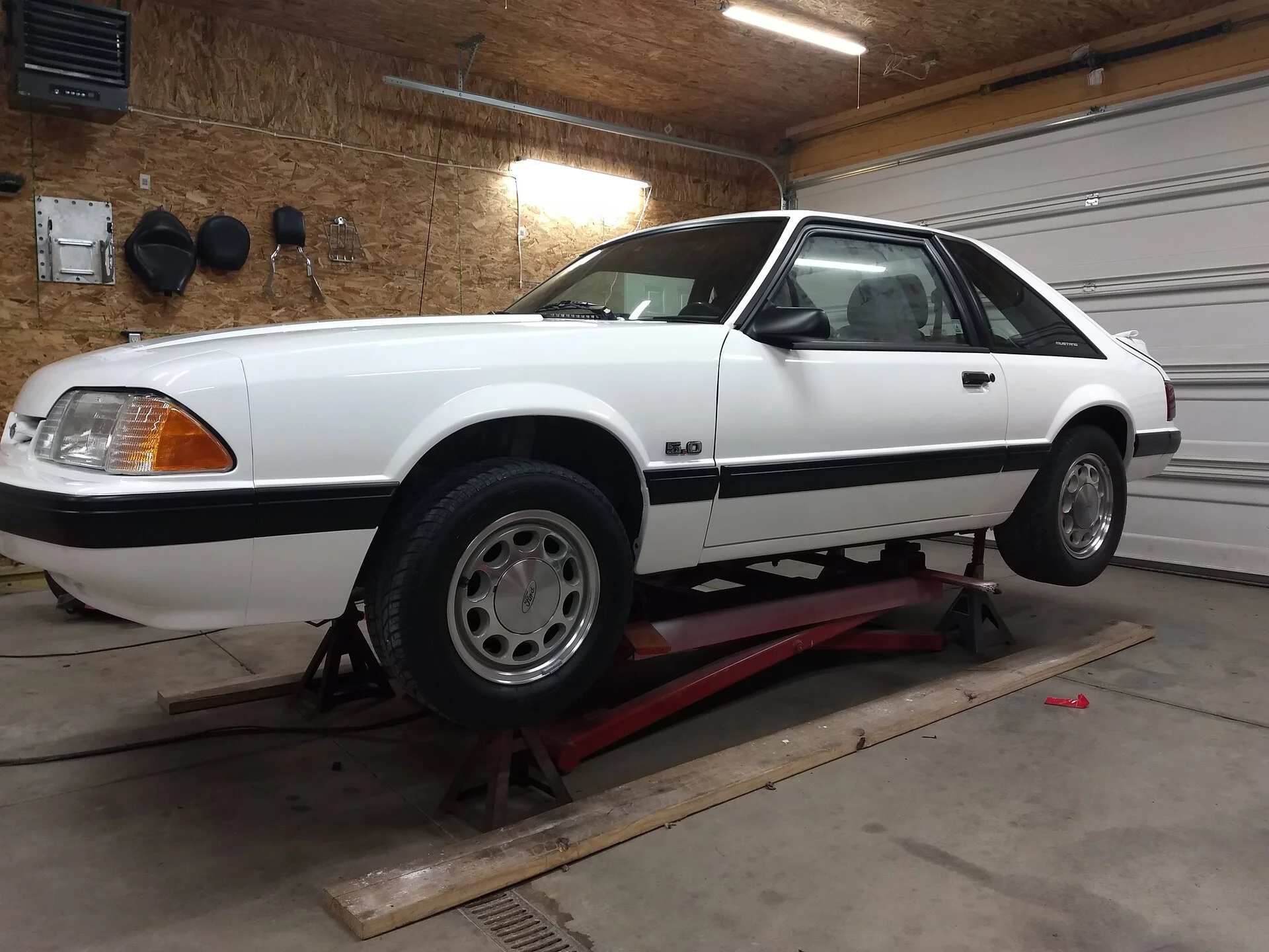

What kind of lift do you have under the Mustang?
It's a Norco midrise, it looks weird in that pic because the car is actually on the jackstands. I was putting the moldings on, I wanted the car to be on the suspension because it flexs so much, when it's on the lift the doors don't open right, so I slid the stands under the rear axle and the front control arms. If you go back to the beginning of this thread, someone else asked about the lift and I showed it in better detail.

So when it's on the lift the doors don't open right?
Where does the lift contact to lift it?
I find this disturbing because of the amount of flex it takes to make the doors a problem, this is not a convertible.
Gravydog
dripping from every hole
Oct 6, 2019
157
356
73
Canton Ohio
May 16, 2020
#217
  • May 16, 2020
  • #217
The lift pads sit on the flat rail that is welded to the floor, and the rear torque boxes right in front of the lower control arm mounts. It doesn't flex a lot, just enough that the doors give a little pop when you open them. Definitely not like a convertible, I know what you mean there.

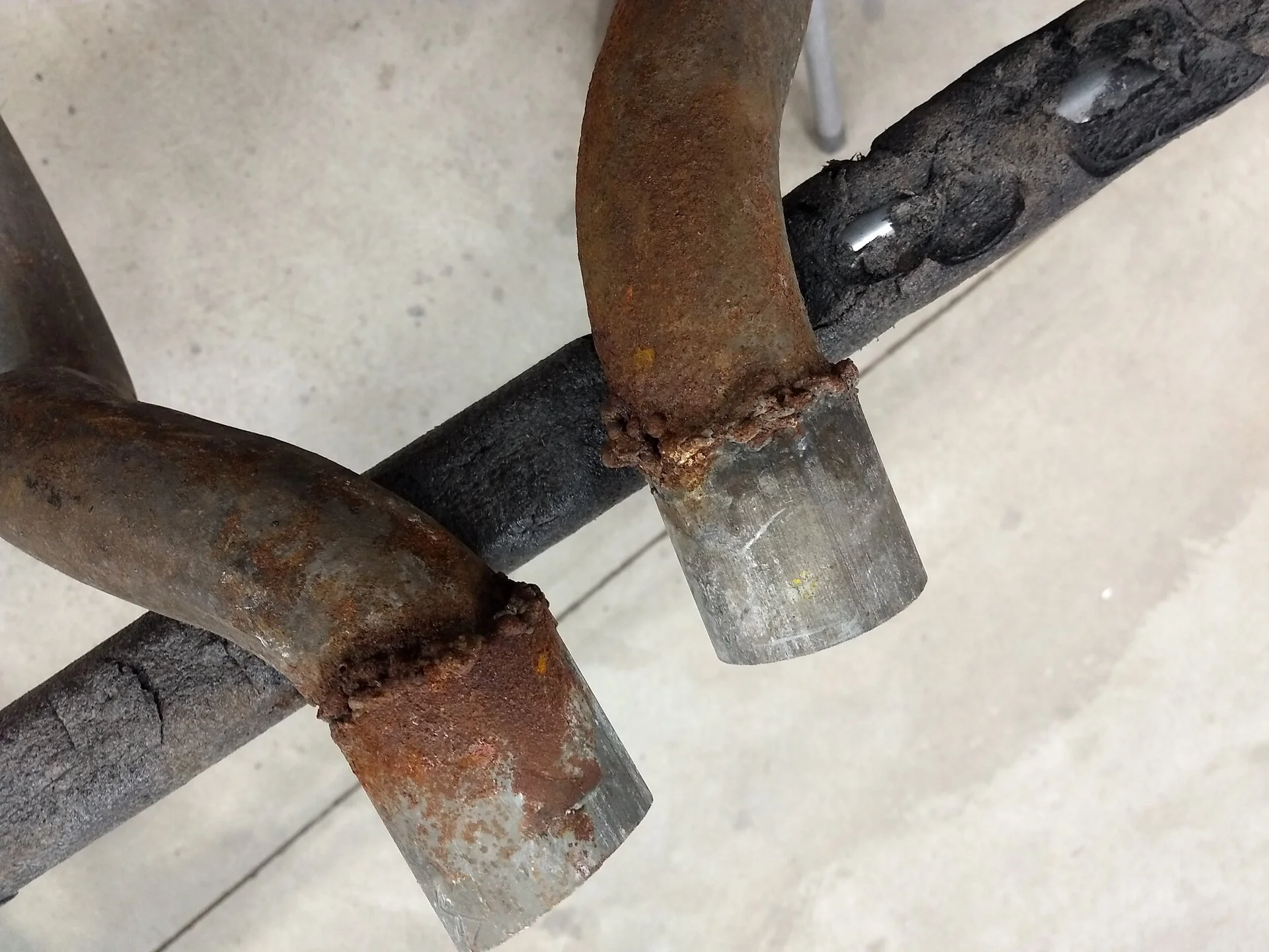

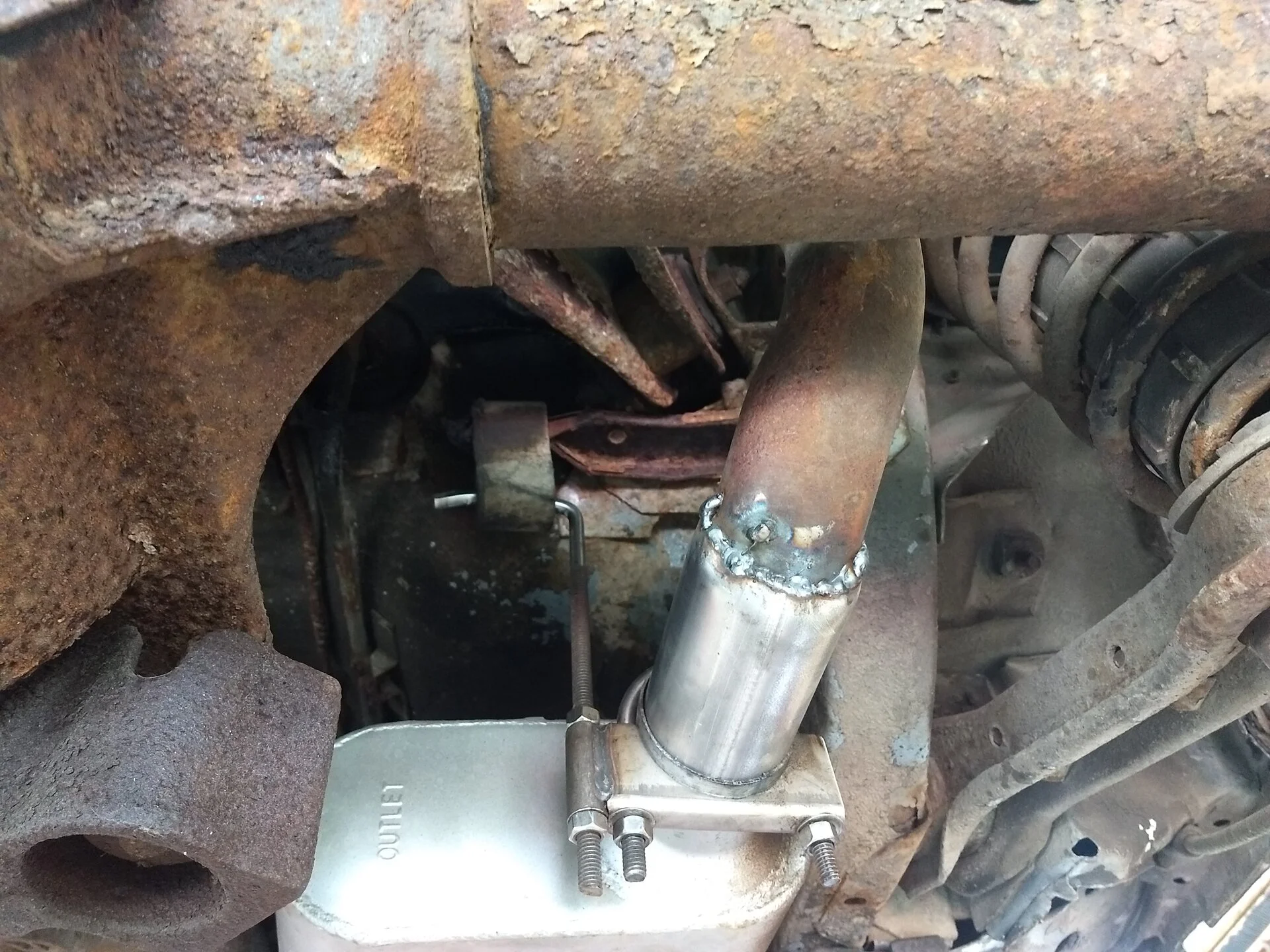

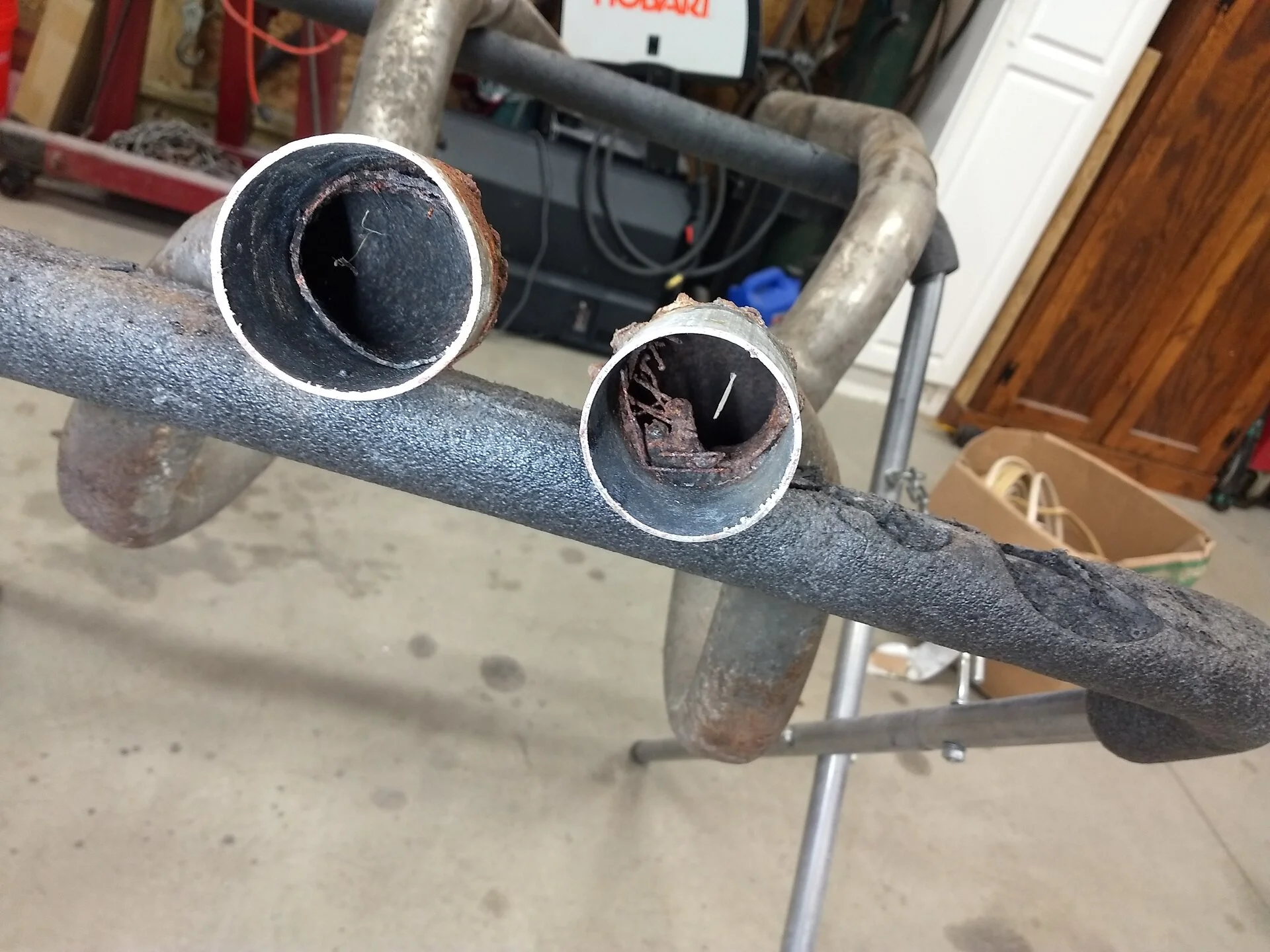

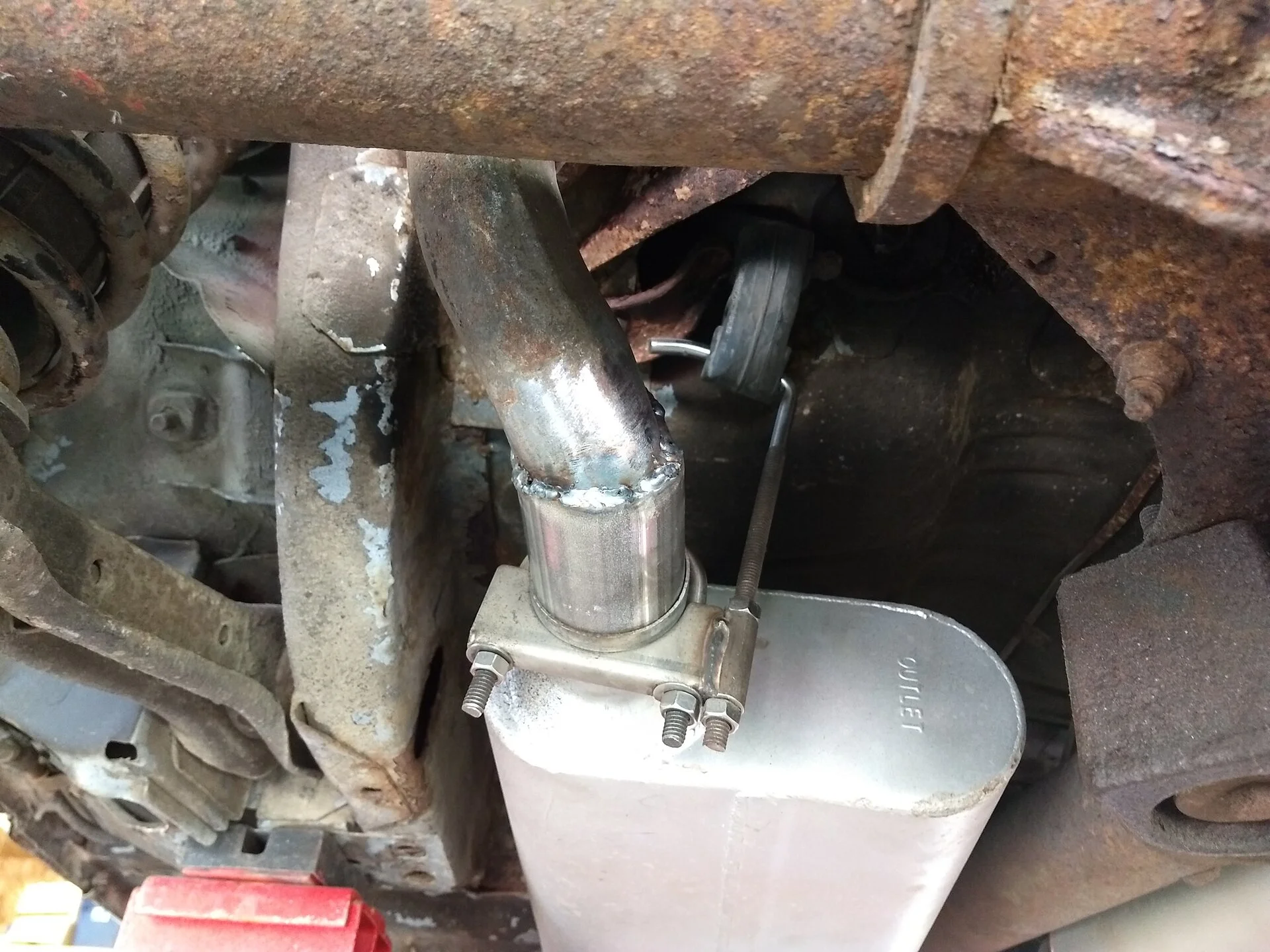

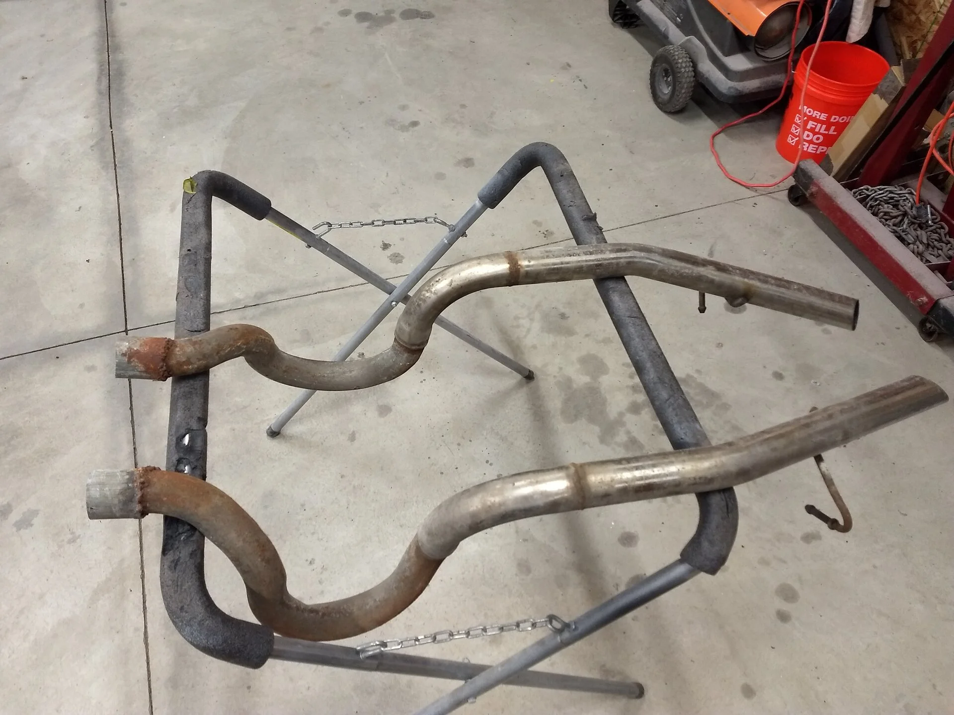

Update time, I've been driving the car for the last week, I charged the air conditioning at work on Monday, someone already converted it to 134a, and I'm happy that it works great! This morning I decided I was done listening to the dumped exhaust, so I tackled the tailpipe project, basically I had to cut off the mess the last guy made, and weld some new pipe on to attach them to the mufflers. It sounds awesome, and the car is way more enjoyable to drive. I also replaced the rear shocks while I was back there.
This is what I started with, these were on the car when I got it, they had tried to weld straight pipes in place of the mufflers.
My welds are a little better, and they don't leak. I hate welding under the car.

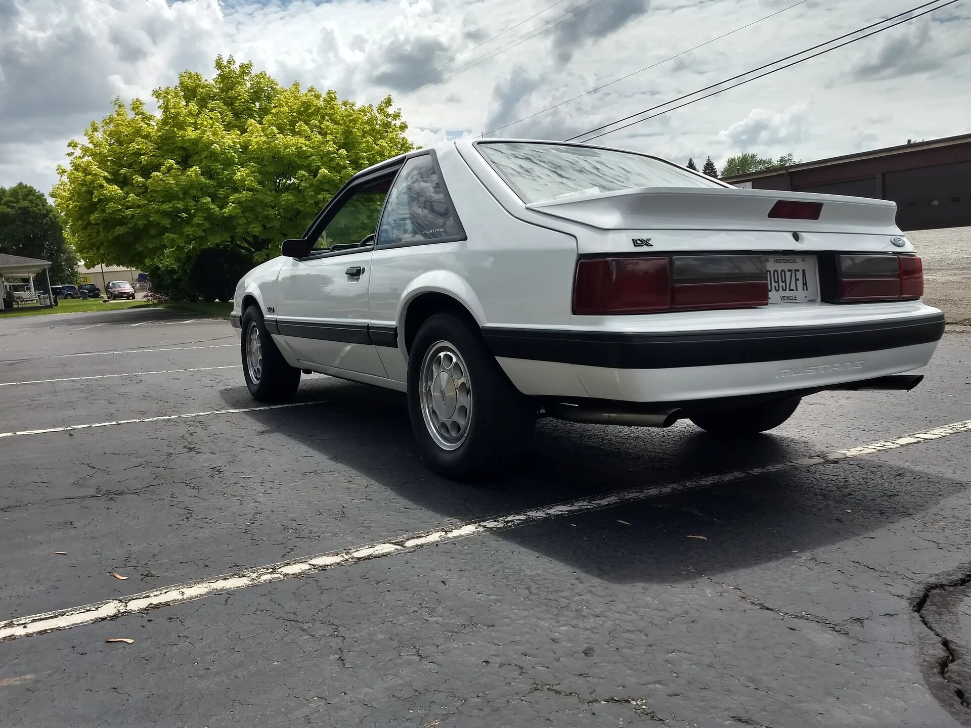

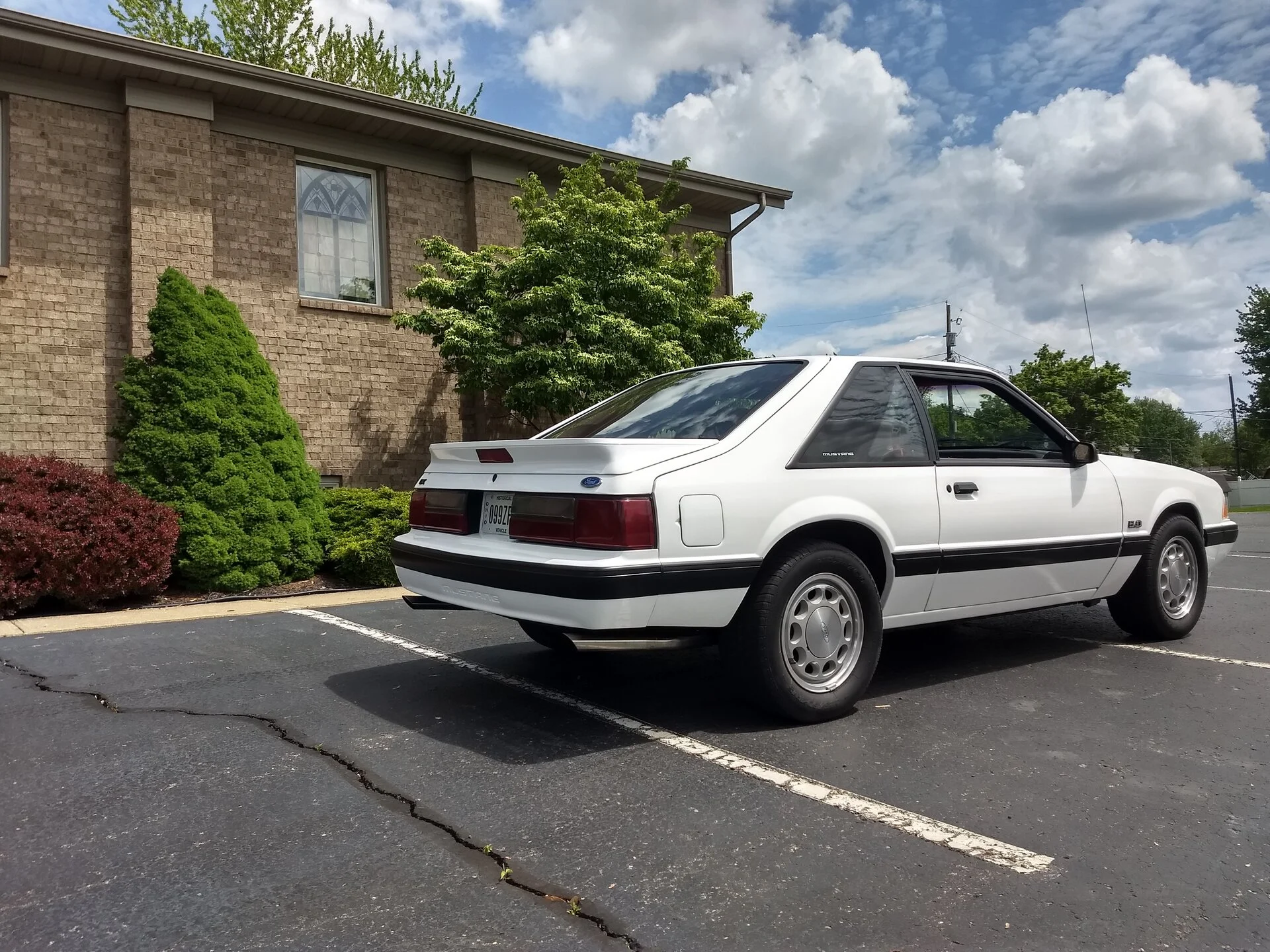

And some better pics of the car with the tailpipes.
