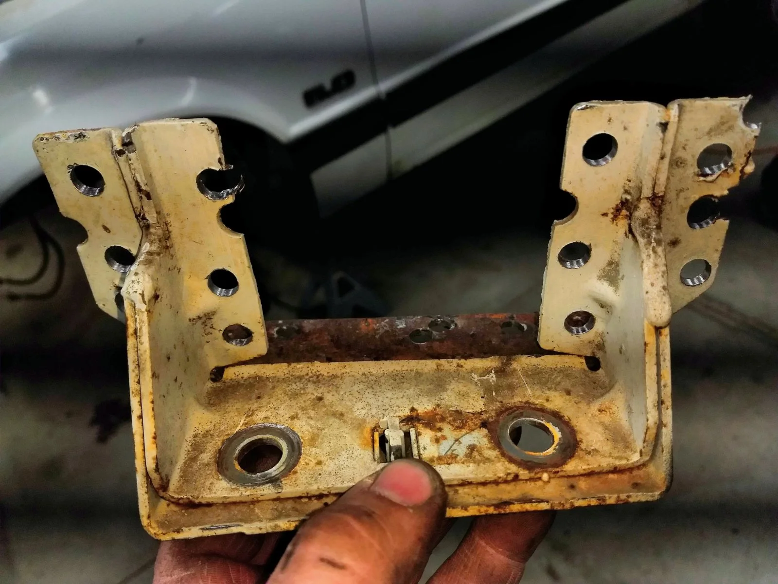

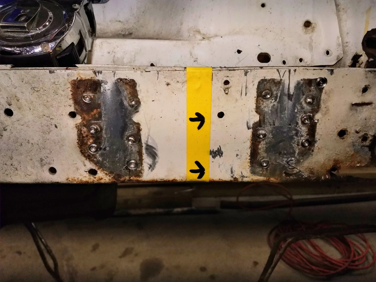

Made just a little bit more progress tonight, I got the A/C lines, drier, and fuel and brake lines moved out of the way and drilled off the sway bar mount.

No big deal, just drill out the spot welds, there are some on the plate that attaches to the bottom of the rail also.

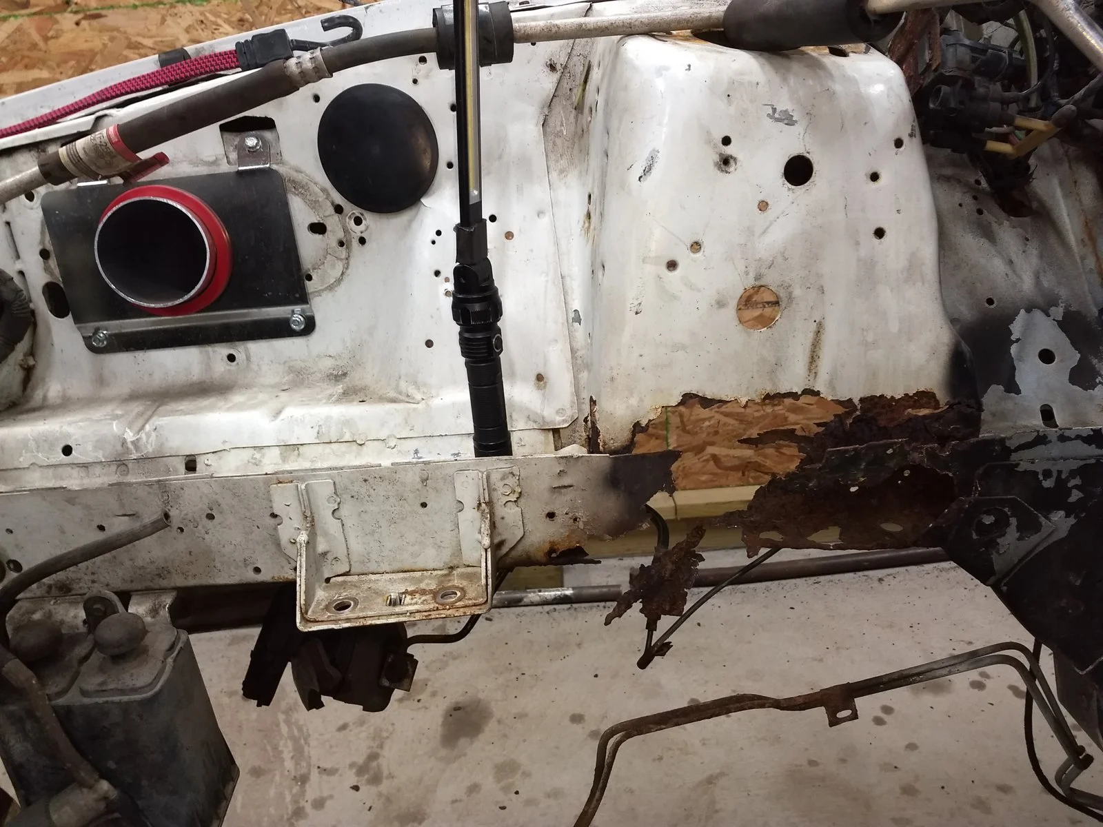

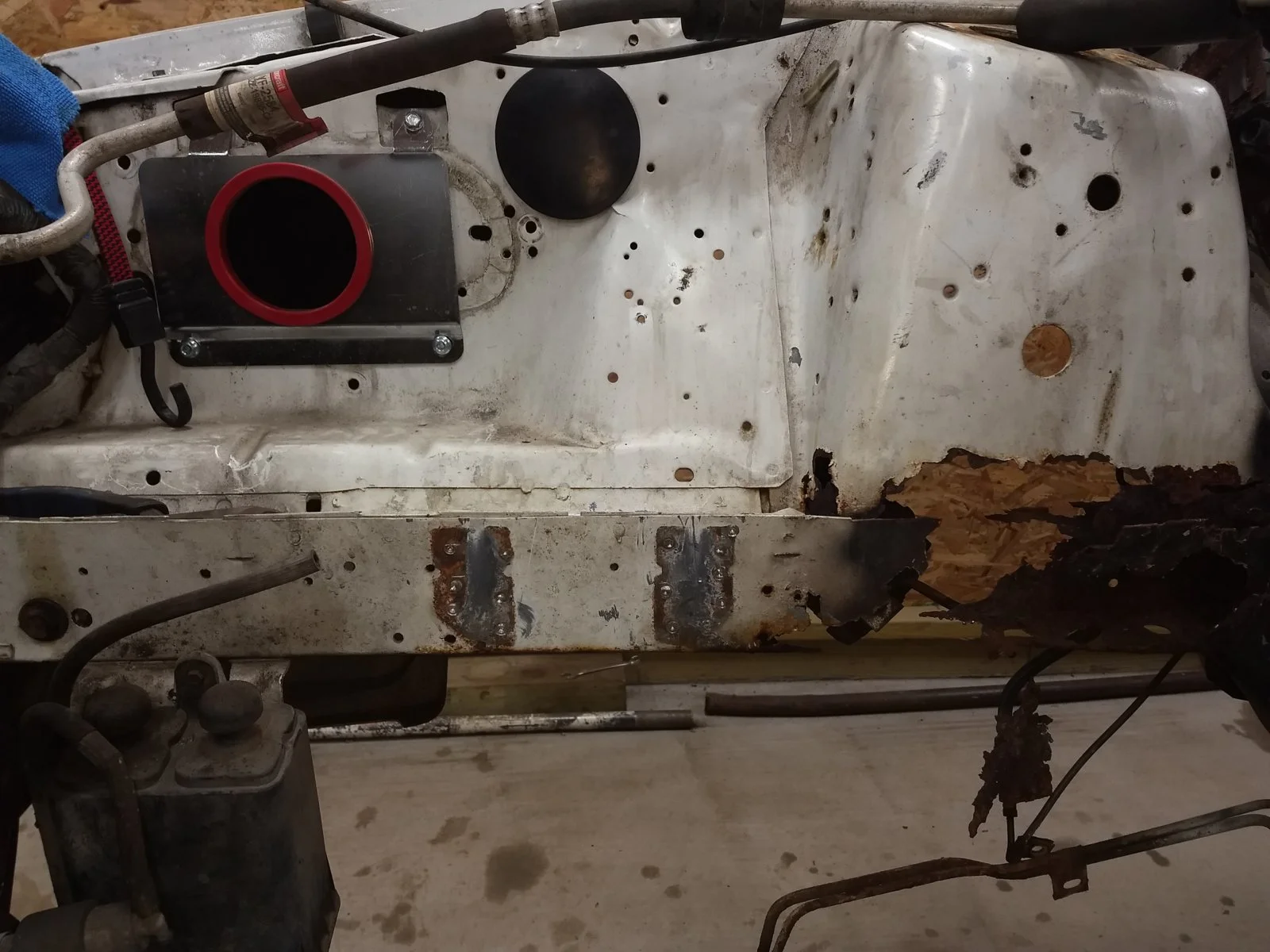

Well, my son's car project has been put off for another week, we got some snow and freezing rain last night, he lives 2 hrs away and didn't want to make the drive in the bad weather. So what that really means is I got to work on the Mustang today, here we go, there's lots of pics, so this will be several posts.

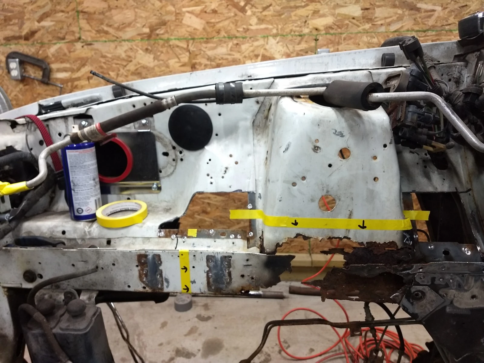

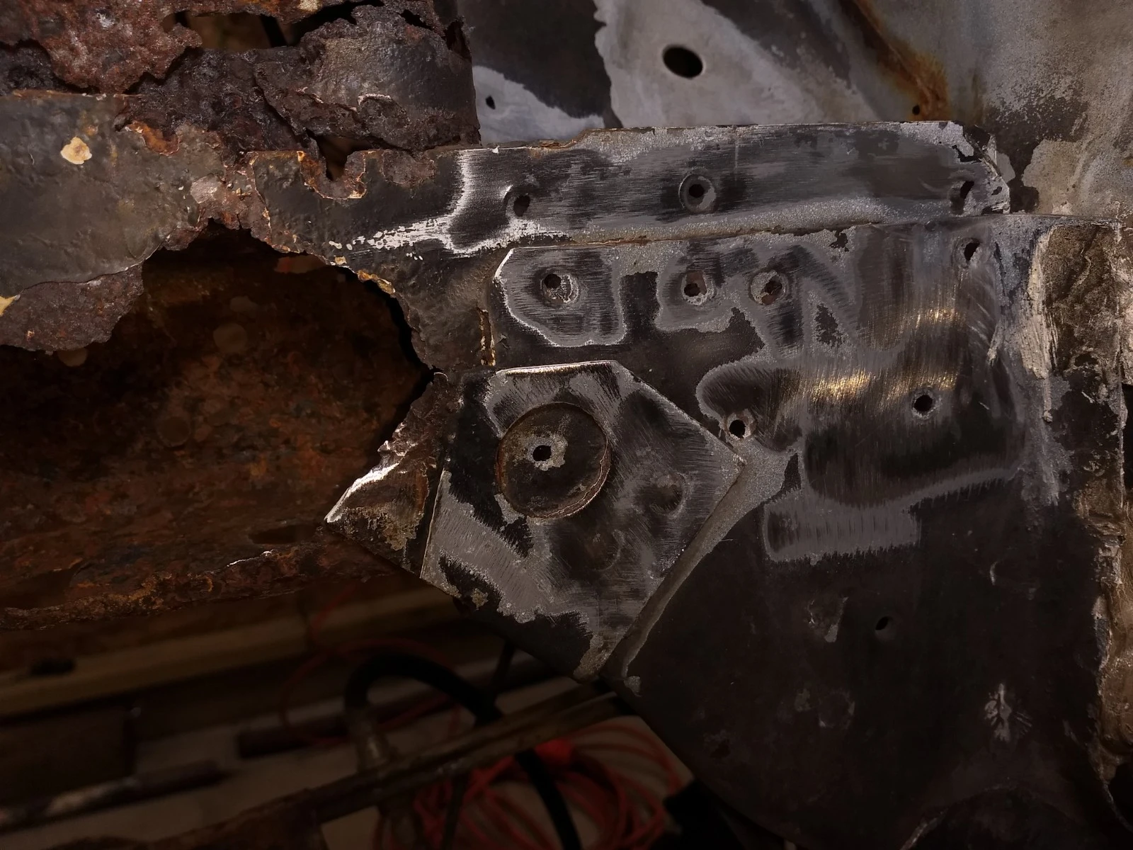

First, I cleaned off the old paint with a wire wheel so I can find the spot welds, I mark them with a sharpie to help find them when I start drilling.

Then I took alot of measurements and started laying out where I wanted to cut.

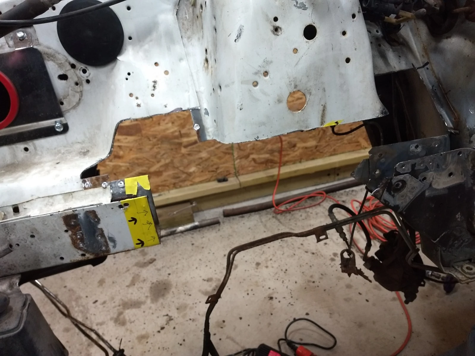

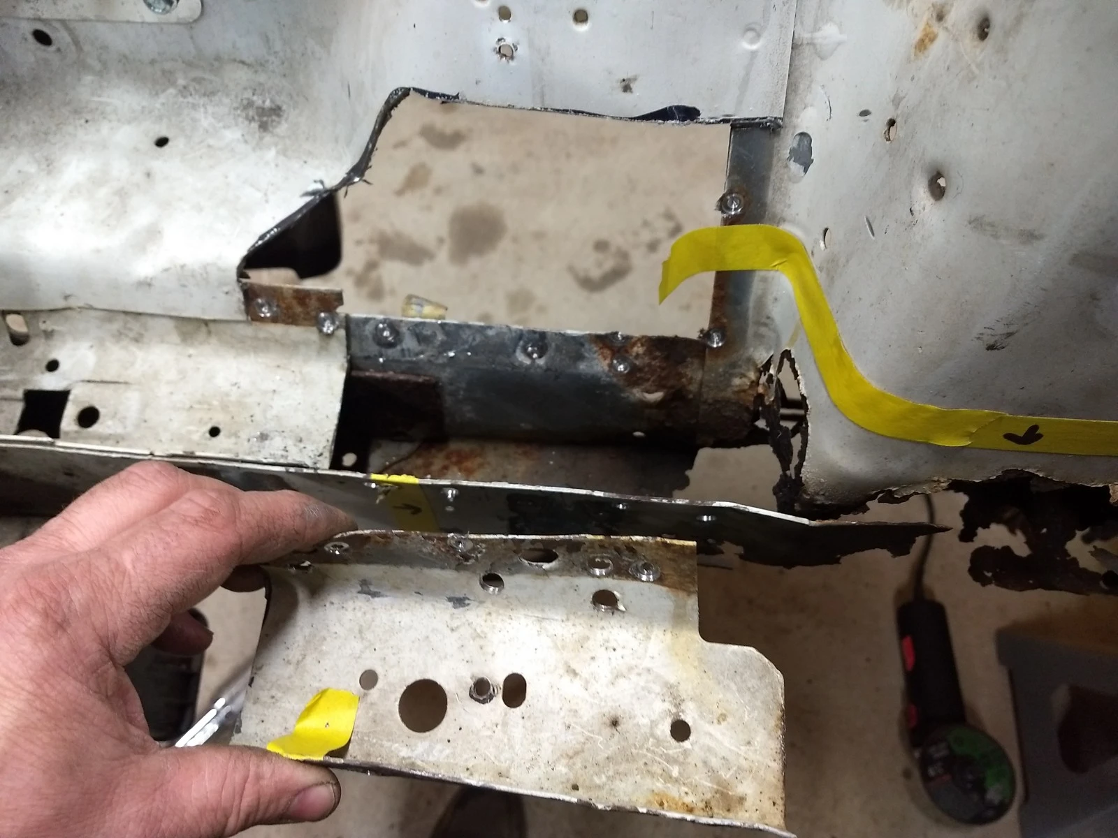

I decided to cut a small piece of the apron out, it will give me the room I need to get my donor piece in there, I'll weld it back on later

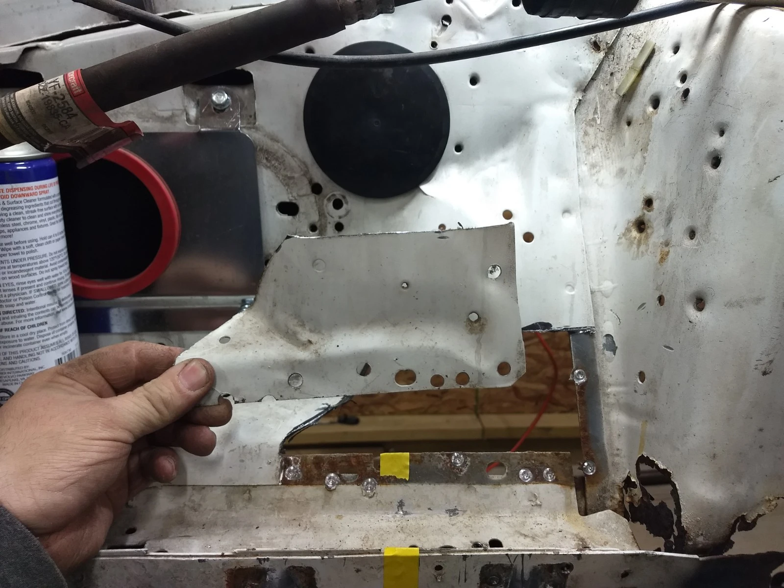

Did the same thing to the panel between the strut tower and the firewall

Laying out where to make the cuts

This part of the rail is made of 2 pieces, the U shapped body, and a top cap. I removed part of the top cap, this way I can insert a sleeve for my rail splice.

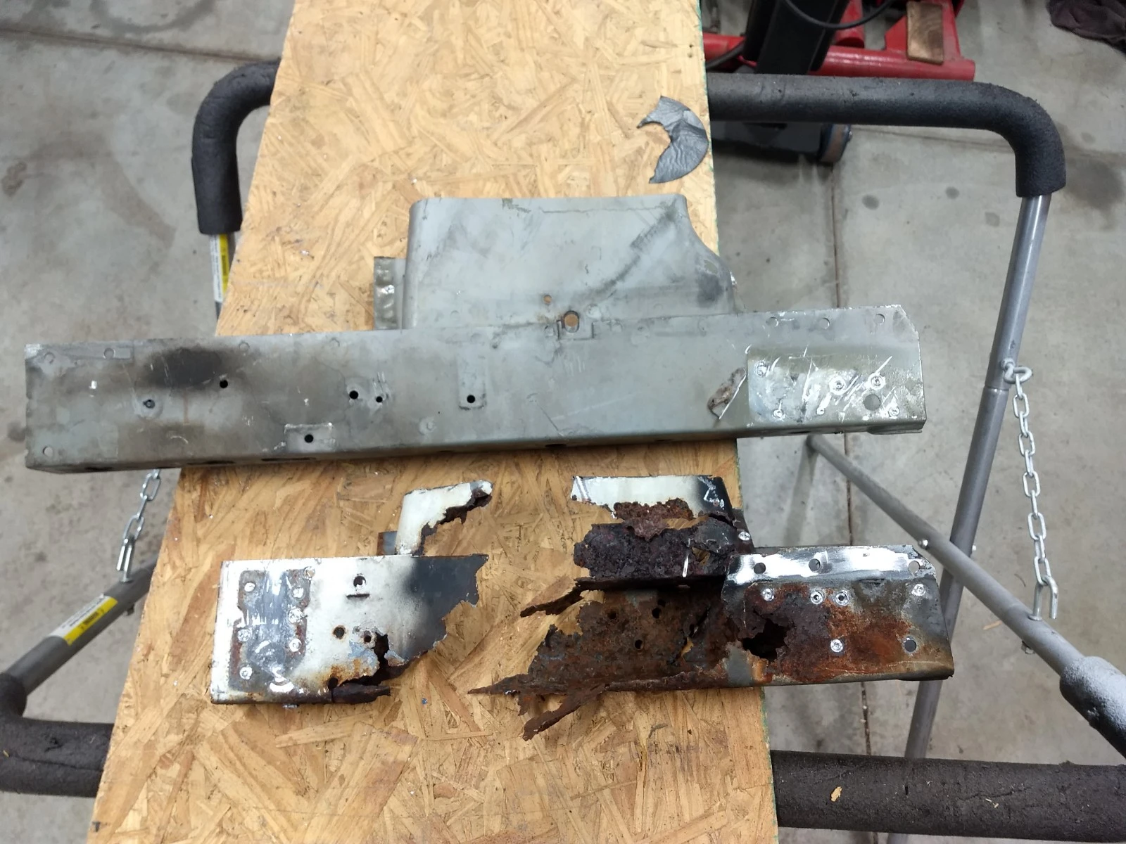

Everything trimmed off

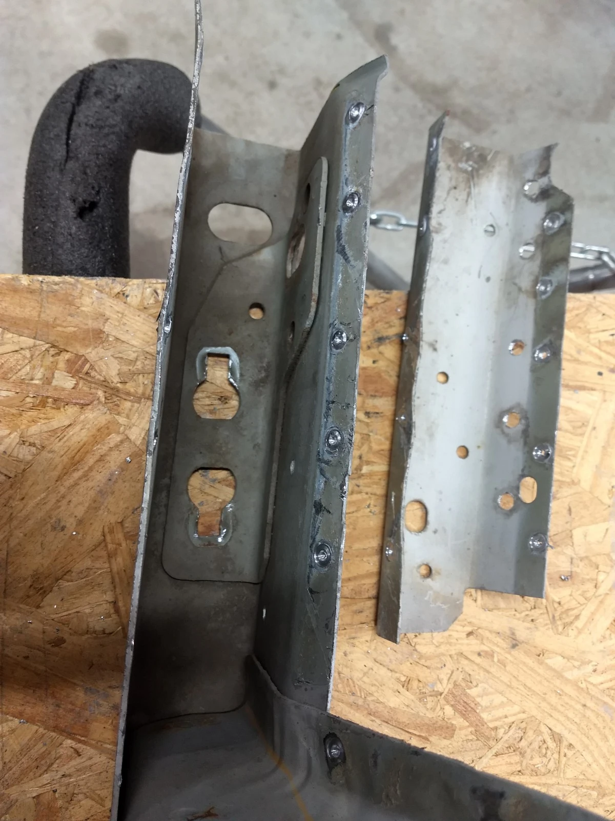

I removed the top cap from the donor piece too, there is a brace inside the rail for the sway bar mount, we don't need it so it gets removed too, actually my splice is in the middle of the holes.

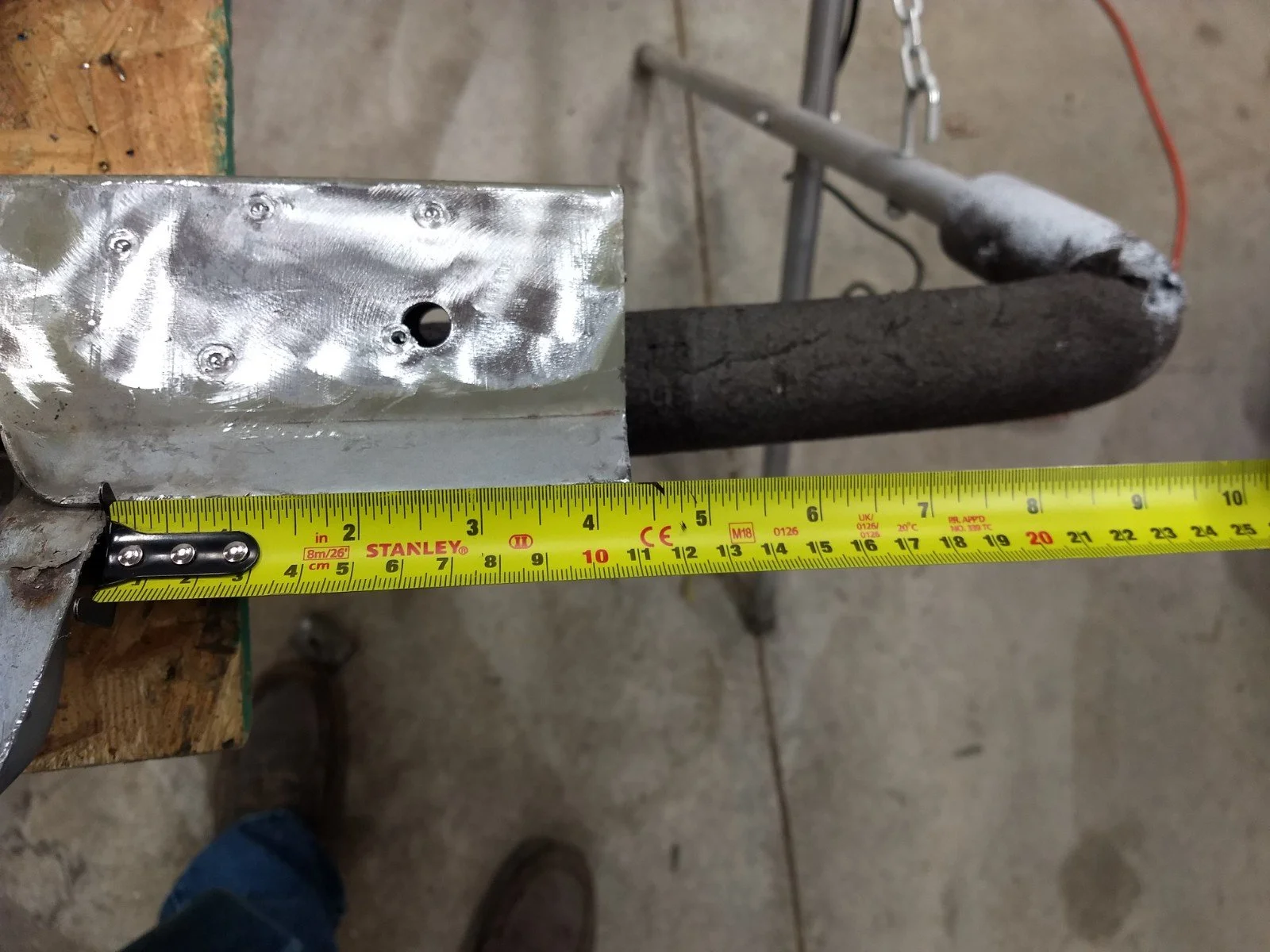

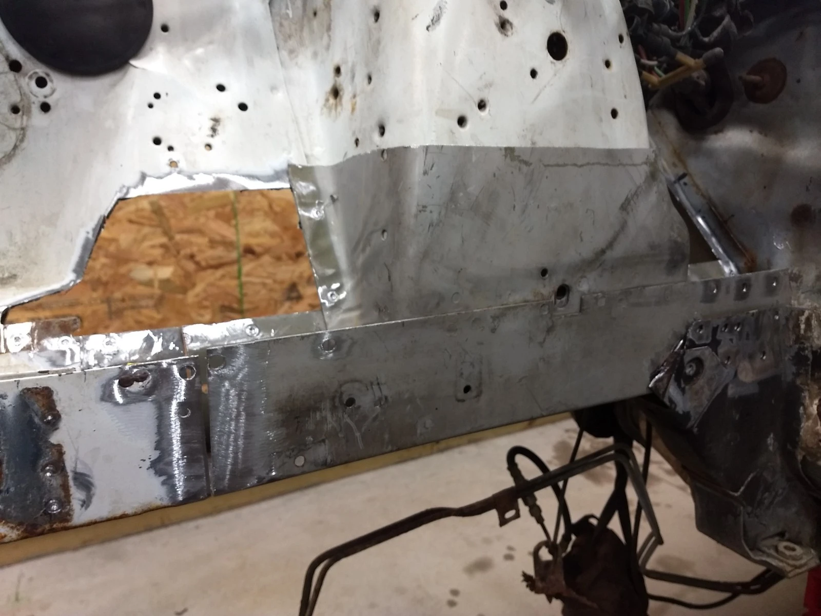

This part of the rail, it's behind the strut tower needed about 1/8 inch trimmed off. It was the only size difference I could find between the 2 parts.

The new piece slides down from the top
First test fit

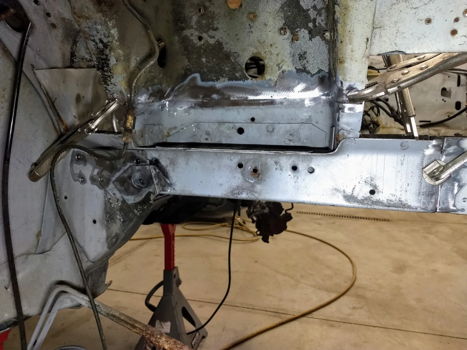

After trimming the strut tower, it's overlapped about an inch, the front part of the rail is a butt joint that will have a sleeve, and the rear part of the rail will be plug welded at the factory spot weld locations.

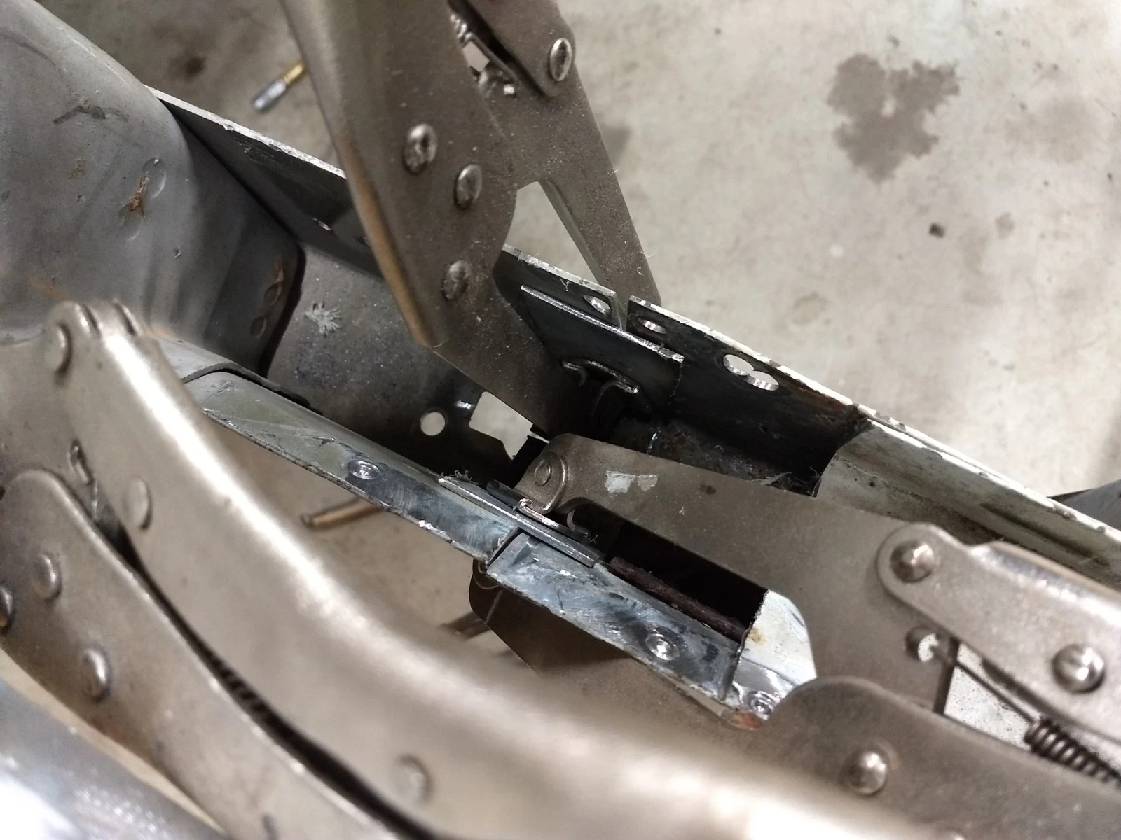

The sleeve I made for inside the rail, it's just made from a piece of scrap rail.
At this point, it's ready to weld, it fit's really good considering it's from the wrong car 13 years newer.

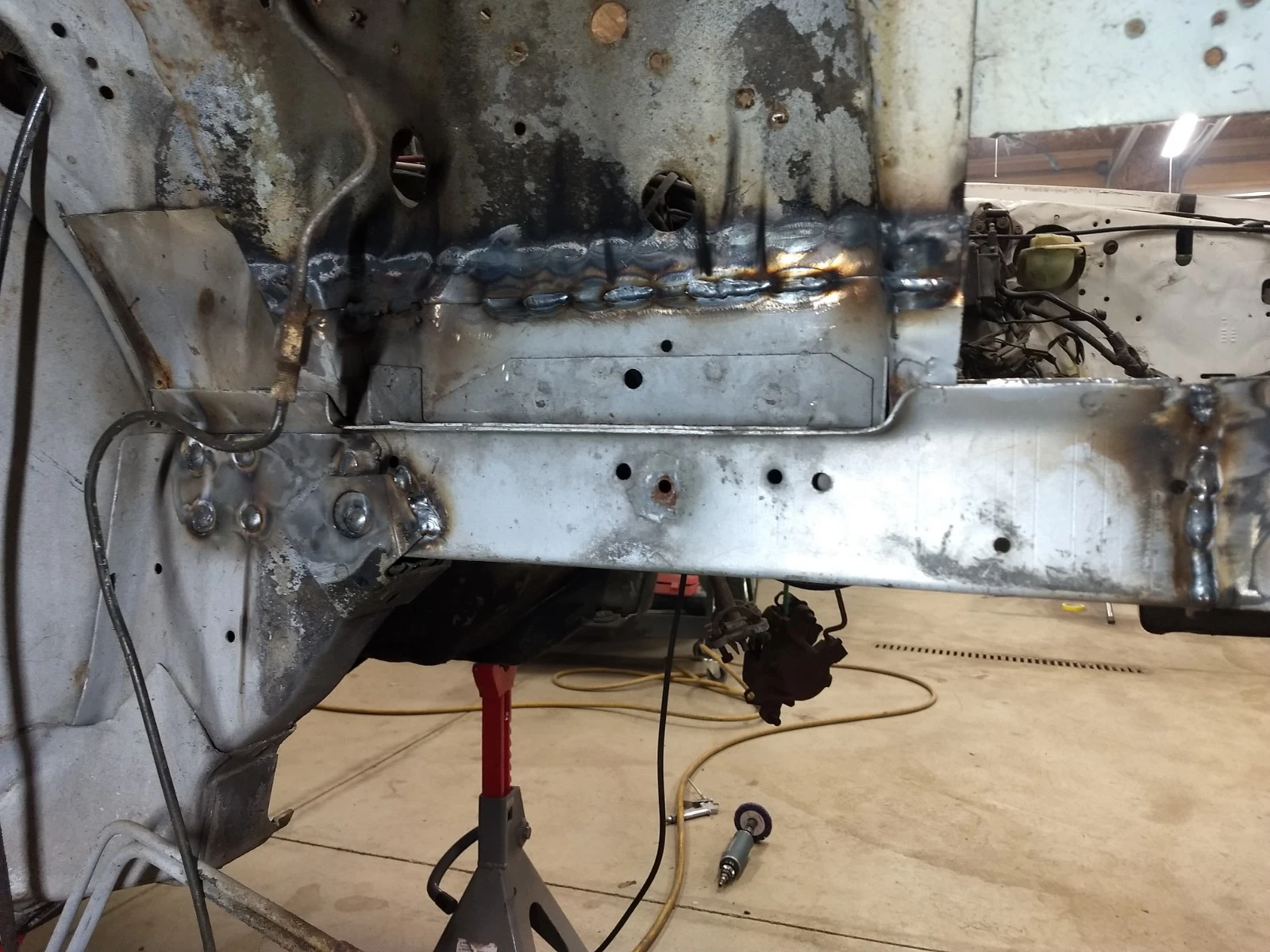

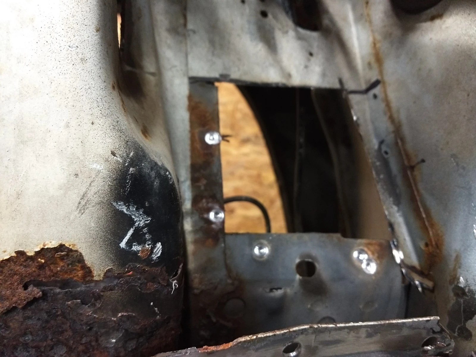

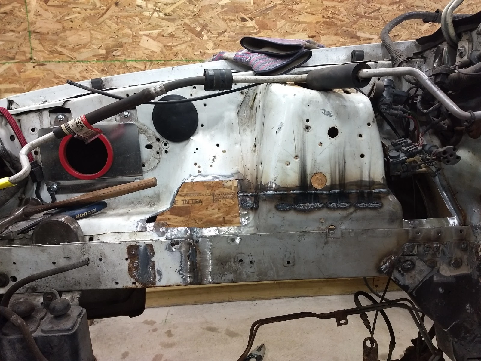

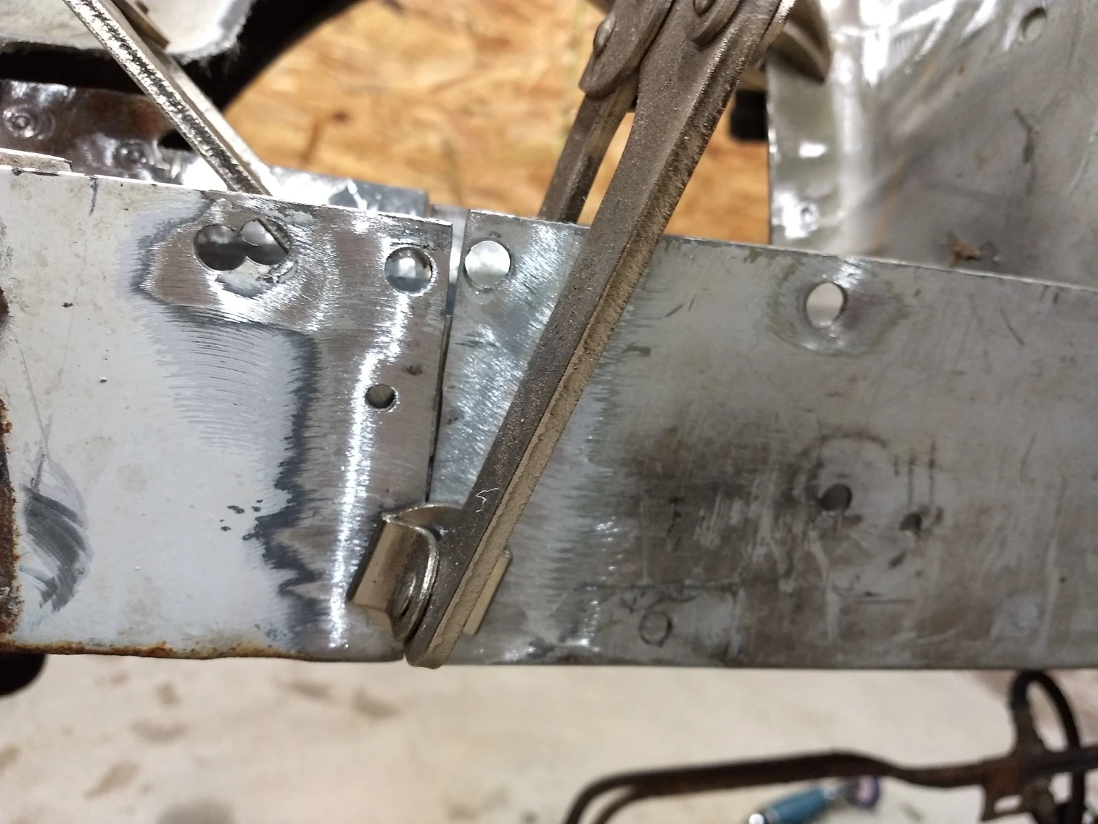

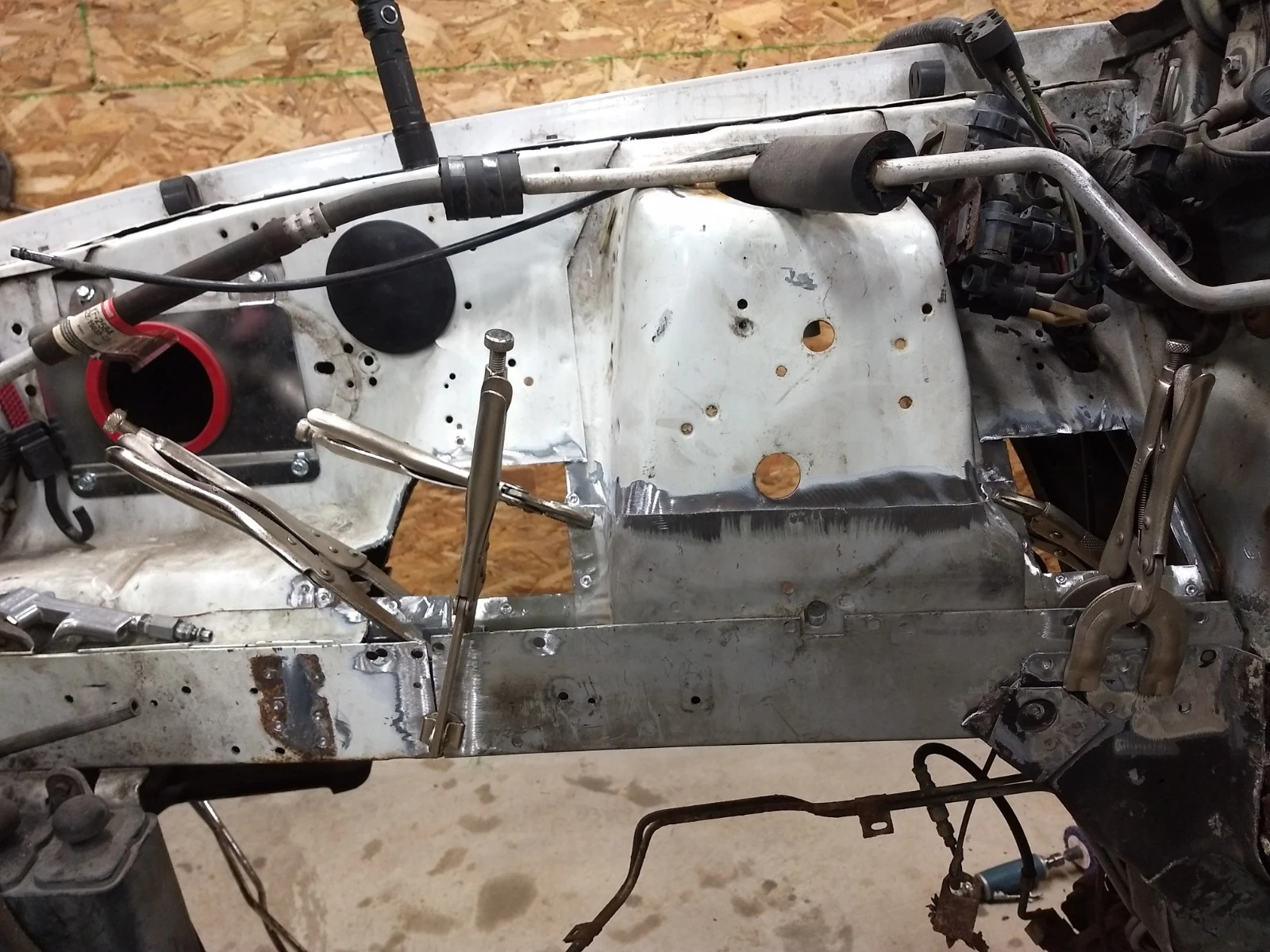

Before I welded, I took several measurements to make sure everything was where it was supposed to be. The driver side is rusty, but still intact, so I was able to use it to take cross measurements, every thing checked out ok, so it was time to burn it in.
This was the only other fitment issue, it's just a difference in the stamping of the part, it's flush and level at the bottom where it matters, I'll straiten this out with a grinder later.
All welded in
Other side
Well, that's where it's at for now, I still need to weld the apron pieces, and the top cap back on, and clean everything up and put some paint on it. Then I get to do it again on the other side.

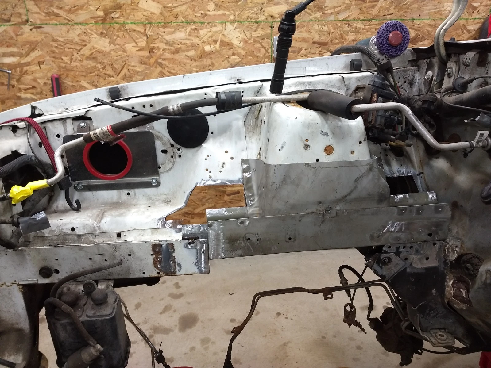

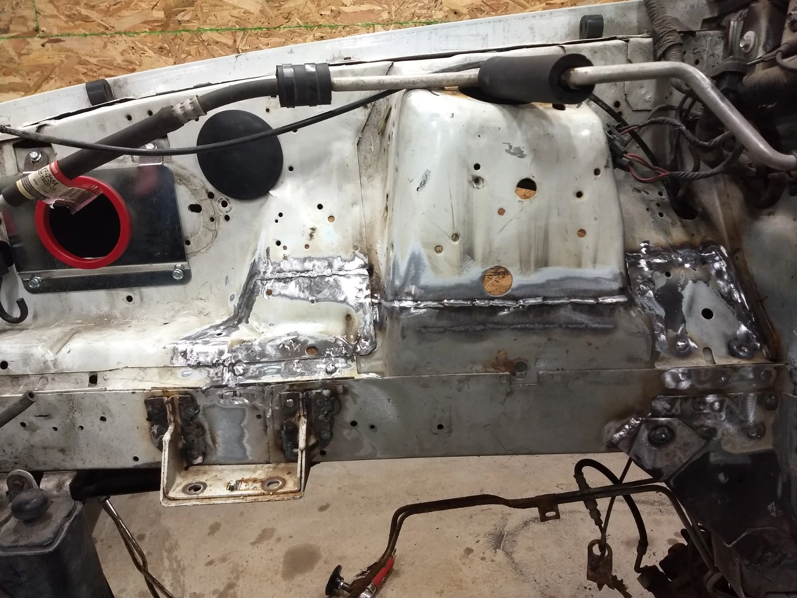

I finished welding the other pieces tonight, it still needs some more cleanup before it's ready for paint

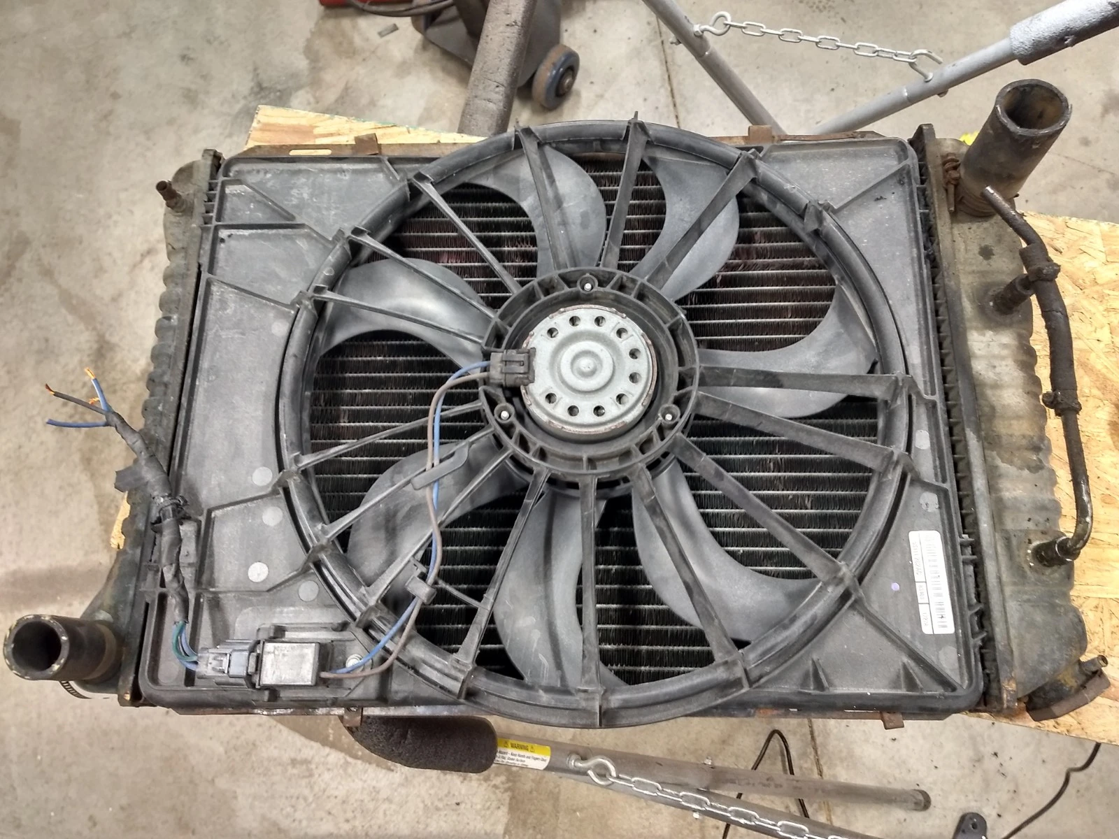

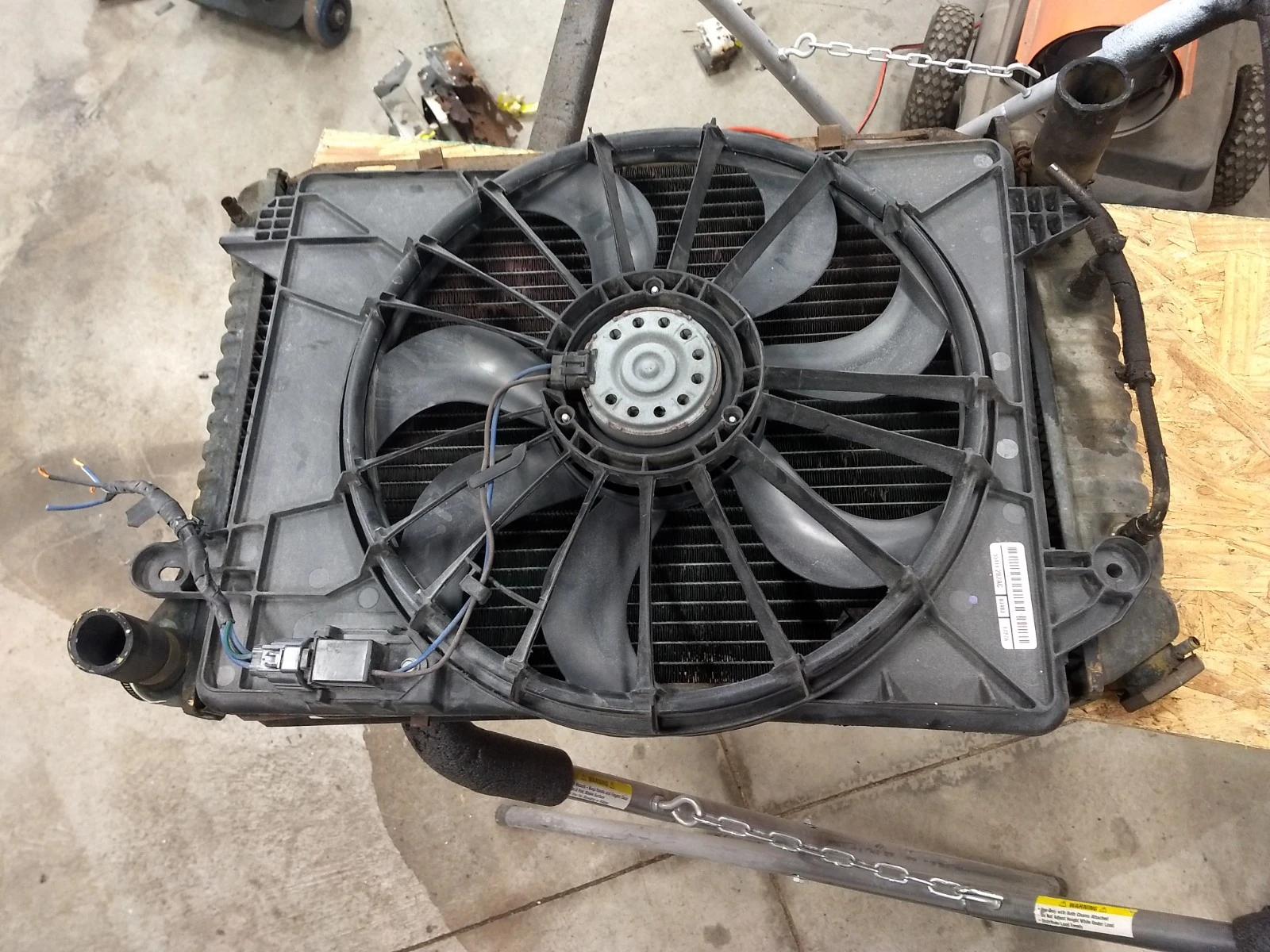

I spent a few minutes working on some thing else, I can only cut grind and weld so much and I get burned out. I snagged this electric fan awhile back, it was just going to get tossed out at work, one of the braces on the shroud is broken, no big deal, but the customers car got a new one. It came off of a 2018 Dodge Challenger, it was just a V6, but a quick Google of the part number says they use the same fan on all of them, even the Hellcat, so it should cool my car just fine.
Once I cut the factory mounting tabs off, it fits a Fox radiator like it was made for it. It should be pretty easy to fab up a mounting bracket.

Nice work!!!!! but I noticed you didn't coat the inside with anything before you weld it up... when I did mine, I blasted it to bare, and used por15 inside.... then once it was all together, I used the Eastwood internal frame coating to coat all inside of the frame rails... and I did a lot of coats... don't want it rusting in there no more... in fact I've sprayed a s-ton of that stuff in all of the rails from front to back... and even re-coated it again this year... (figure I would do this every couple of years, just for insurance...)
